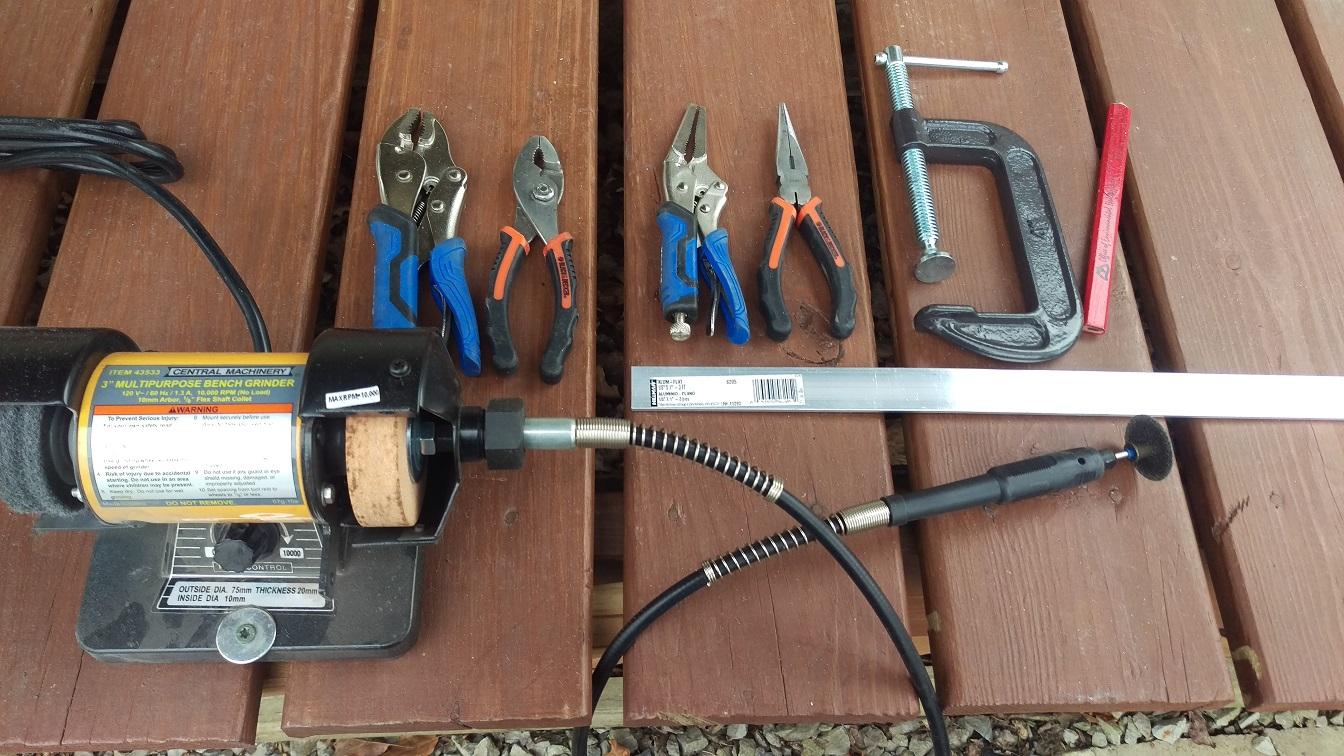

Supplies:
---You'll need some longer, appropriately sized hardware to replace the lower bumper mounting bolts
(I used SAE stainless steel "carriage bolts" (5/16" x 3/4" long)
---Aluminum flat stock 1/8"x1"x3ft piece (each bracket used about 12")
---Electric drill & drill bits of appropriate size
--- "Burnishing" wheel/ grinder/sander/sandpaper
--- A few clamps
--- Pliers of various types

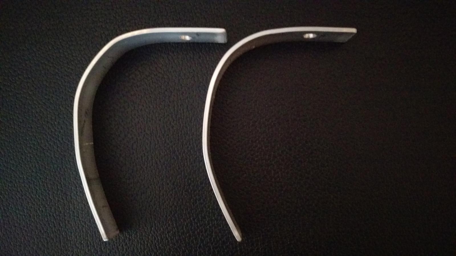

Aluminum flat stock 1/8"x1"x3ft piece (each bracket used about 12" IIRC)

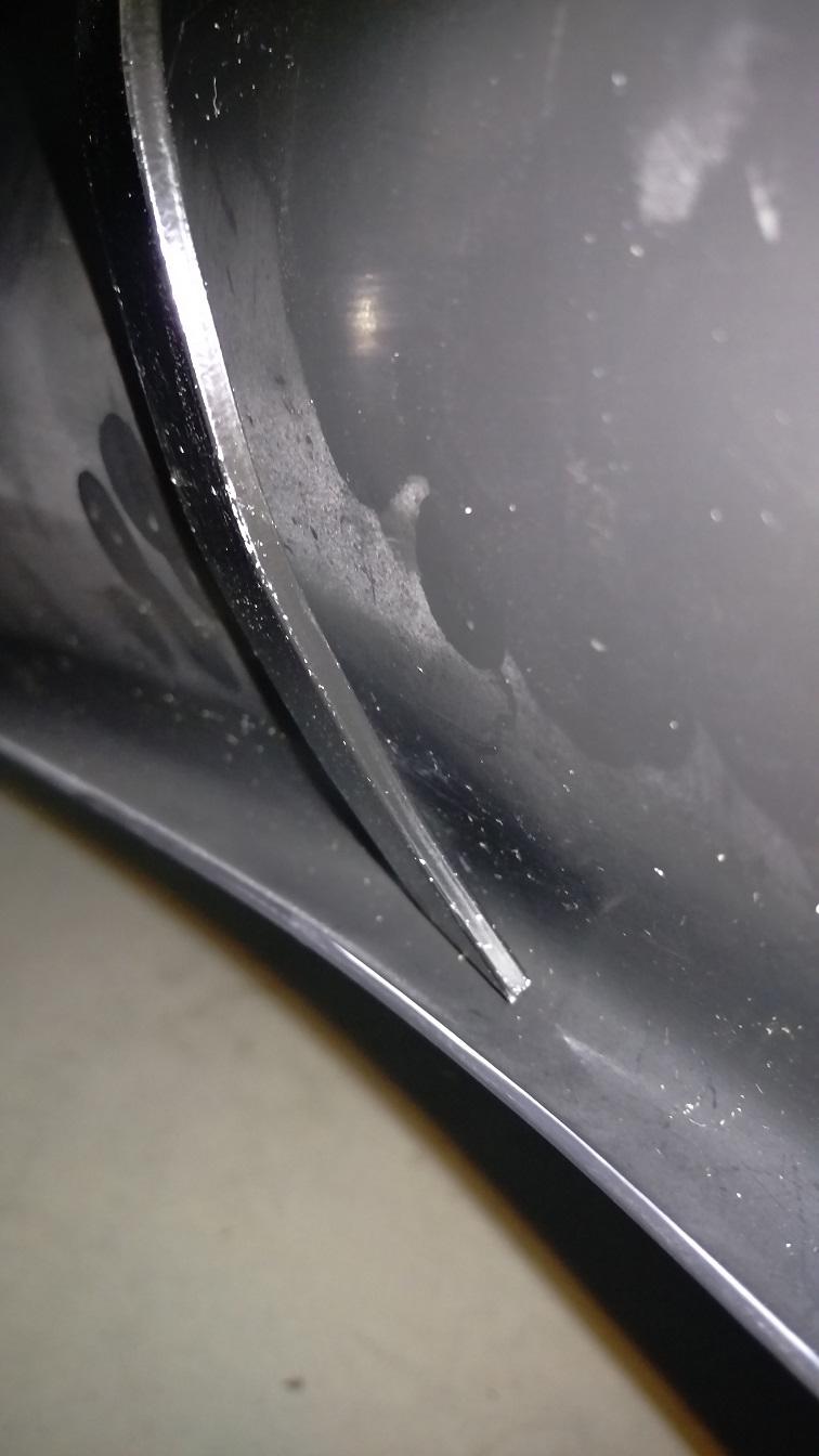

Brackets cut to size and bent, also note 'smoothed' ends (sanded to remove sharp/square edges to prevent scratching against the bumper or the Kamei)
Mounting holes drilled to mount the bracket to bumper bolts
Measurements of bends, mounting holes etc. (one word of advice- drill the holes maybe a 1/4" closer to the end of the bracket, to prevent the end rubbing on the inside of the bumper.
Brackets painted rattle-can rustoleum gloss black to blend in behind the bumper

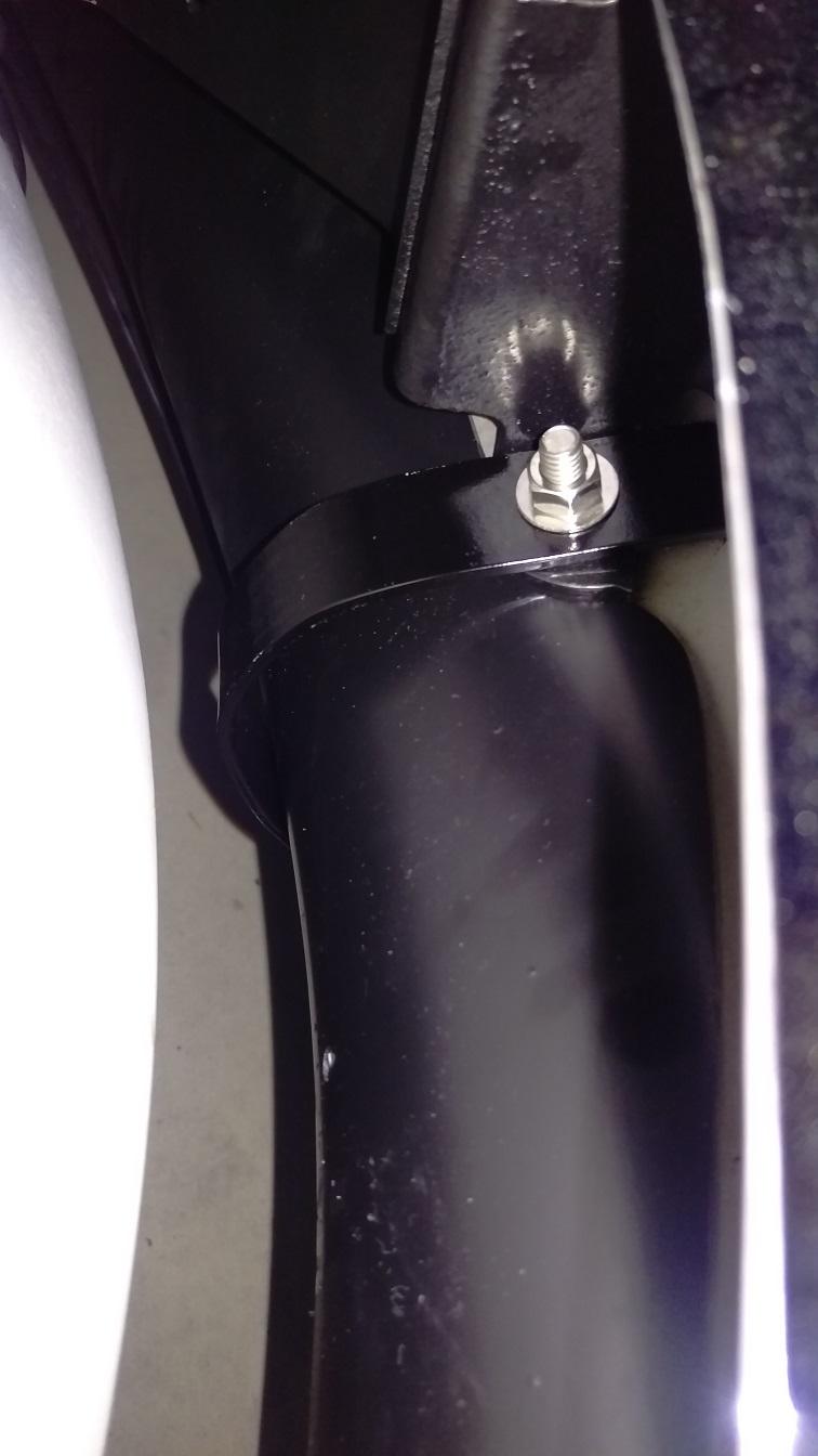

I used longer SAE stainless steel "carriage bolts" (5/16" x 3/4" long), nuts and washers to put it all together. I used the two lower, outer bumper mounting bolts for mounting the top side of the Kamei, but there is no 'permanent attachment' from the bracket to the spoiler at the bottom. I simply bent the bracket so that its bottom end was about an 1/8" from touching the Kamei (to prevent 'chattering' between the bracket and Kamei around town, but so that when the air pressure increased against the Kamei on the highway it would not allow it to 'tuck under' and be ineffective at doing its job.
Also, I chose to make the bracket as a curved radius (rather than a 'sharp' bend) so that (theoretically) as the air pushed against the bottom of the spoiler it would transfer the force up, around, and push into the mounting bolt thereby using the sheer strength of the carriage bolt at the top, rather than simply relying on the bracket 'bend strength'/'rigidity of the aluminum itself.

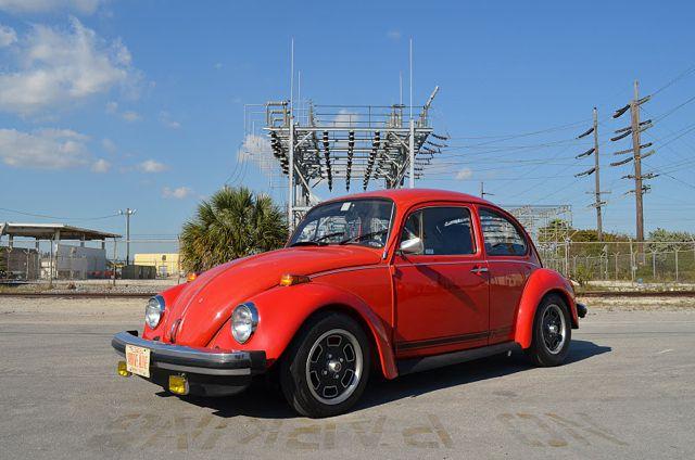

Various perspectives of brackets and spoiler installed on my 73 standard:
