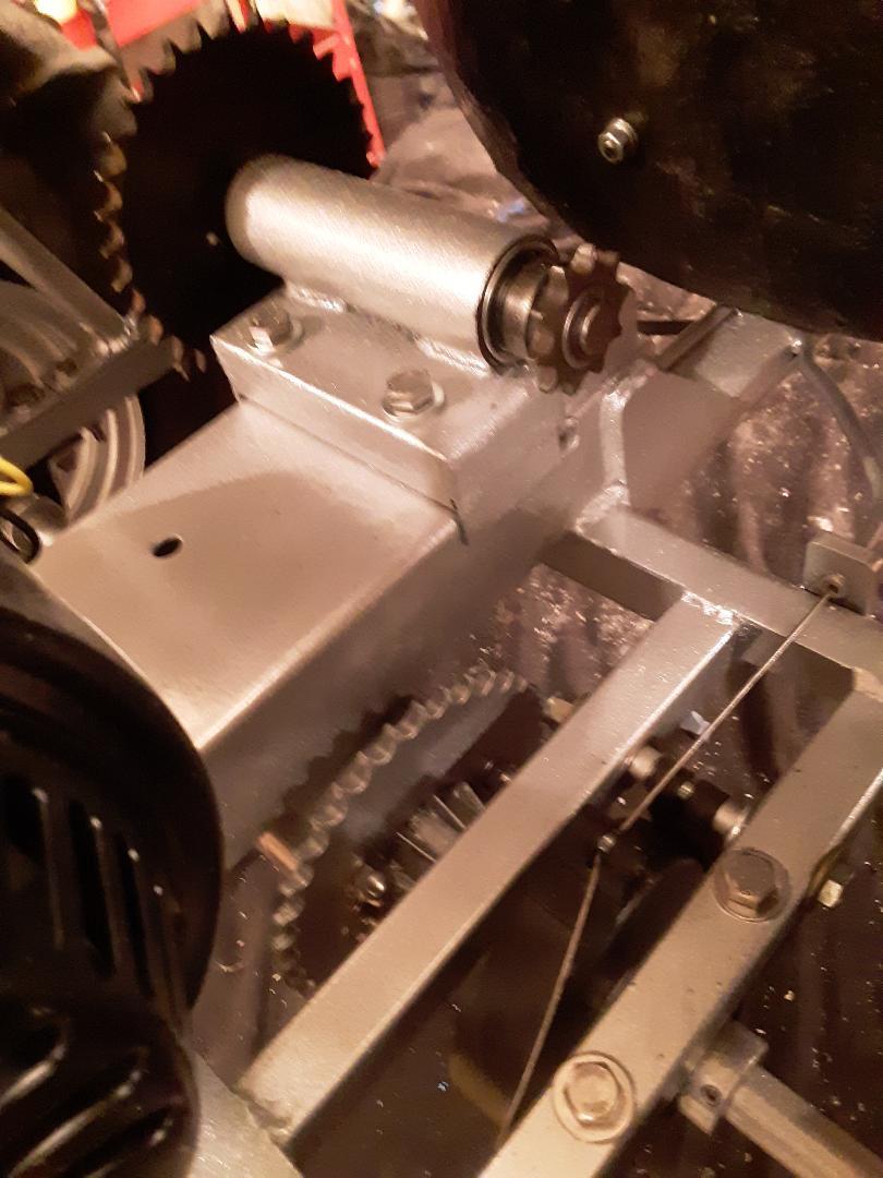

Have finished all the welding I had to do. I added some 1" square stock near the dual drum brakes to give the braking band some additional stability.
Also added a brace on the support for the fiberglass and cut off the simple angle iron support for the fenders and used some 1/4" flat stock and some 3/4" round tube to make a much nicer brace.
Still trying to figure out how to run the brake lines and throttle cable to the back without using zip ties. I am thinking maybe some steel brake line tube welded to the main tube to run the cables to the back?
Got my resin too so I will be adding a few layers of fiberglass to the underside of the seat and then do the needed repairs on the top.
Also ordered the brake handles and throttle kit

It has a rear differential with dual rear brakes. I was told you use them to make it turn better

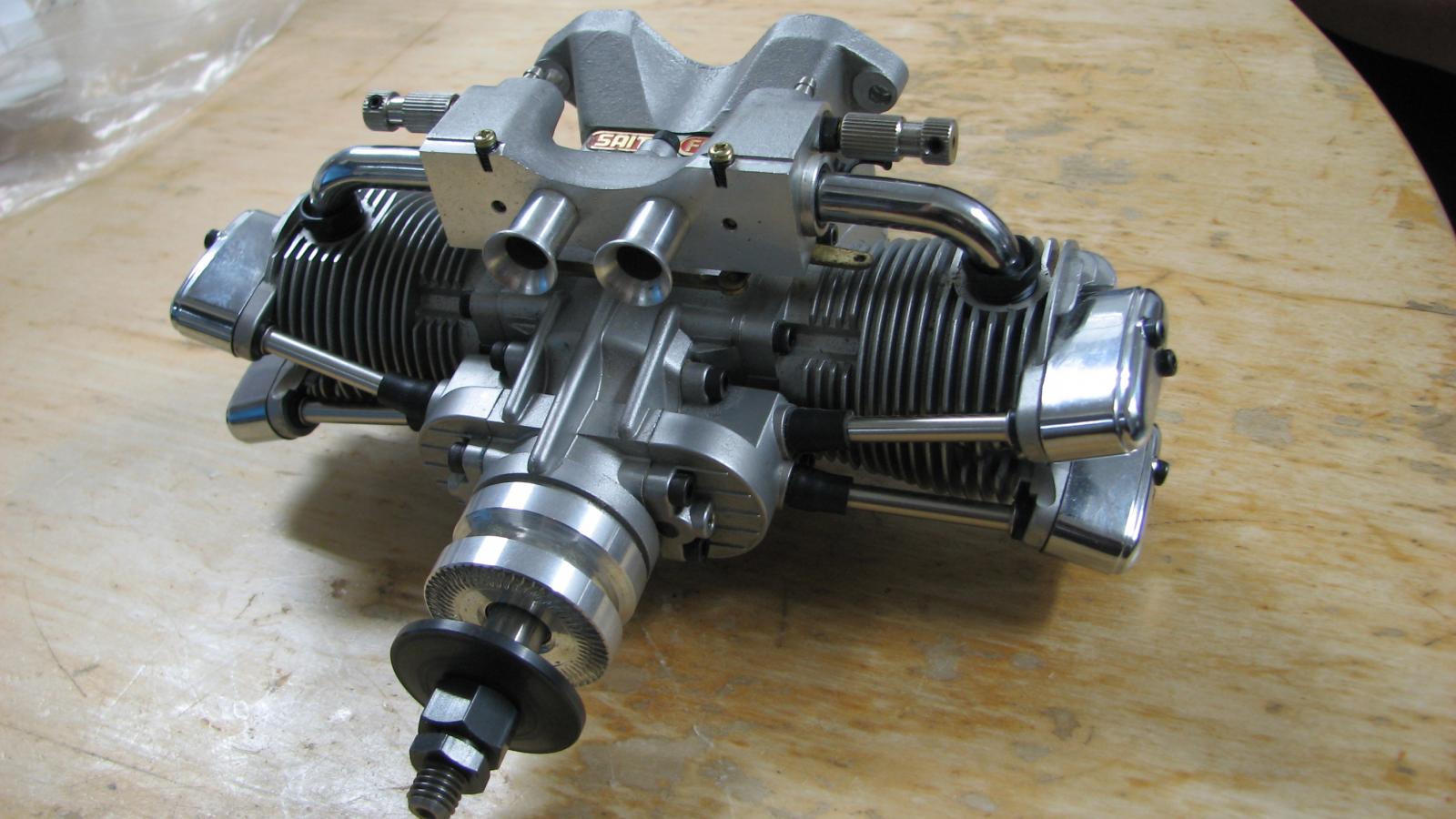

This one is air cooled too!

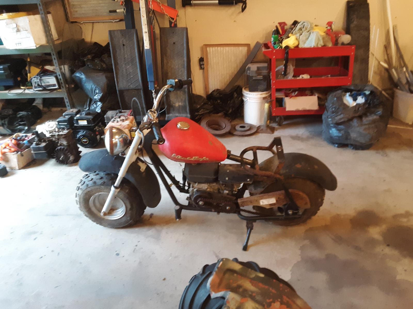

Speaking on finishing up.....a local seller was selling two of these little old school minibikes (pit bikes as some call them) for $400. Offered him $300 for the pair and I picked them up yesterday. Looks like I am back to sanding and painting again!

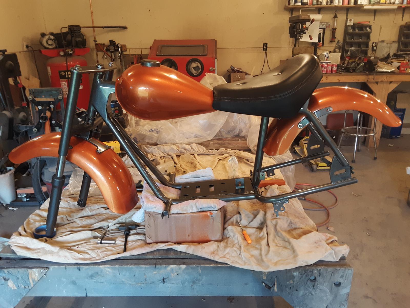

Finally finished the Harley styled minibike (A Baja 165 apparently) and looks like I have 3 interested parties. Fun little project.
Also moved onto the 2nd of 3 that I have acquired. I think they call it a Doodlebug. Its much smaller than the Baja but has the same engine in it so it will certainly move out.
This one is painted acid rain metallic.
Third one will be a sky blue metallic.
Gotta keep busy during these weird times...

what size prop does that swing?

14 x 10 to 18 x 6 depending on airframe application.
