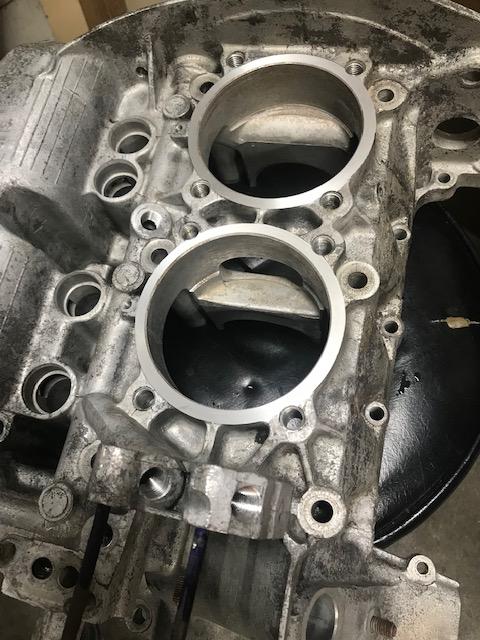

I'm starting this thread to help me document the rebuild process on my 1800cc, Type 4 engine. Let me begin by saying that in no way, do I consider myself to be an expert, engine builder. Therefore, I humbly ask that if anyone sees something they think is wrong, or could be done better/more efficiently, that he or she please chime in. As stated above, the primary purpose of this thread is for documentation purposes, however I hope it will also help others in their future endeavors. I have gained a great deal of knowledge from the good people here on TheSamba over the years. I appreciate greatly, having a site that offers help and instruction for those with varying levels of experience, particularly when it is done a constructive manner. Thanks for checking in and helping out.
So let's get to it. This thread will be updated as things progress.
Let's start at the beginning. Many of you will already be aware of the troubles I've had with the engine in my bus. I decided last year to pull an engine that had approximately 1500 miles on it. I could not get rid of persistent low oil pressure issues. Upon tearing it down, I found there to be bearing clearance issues that were too great to overcome. Time to rebuild. Thankfully, I decided to tear the engine down before it failed in some catastrophic manner. In doing so, I managed to salvage some of the parts. I kept the Raby 9590 cam, followers, the rocker arms et. al. For the most part, everything else will be new, reconditioned and machined to tolerance. The case for the old engine was no longer viable. The engine builder that was originally slated to do the machine work, installed a gadget into the oil pressure relief passage, that could not be removed without extensive damage to the case. I had a case in storage that I had torn down about 20 years ago, waiting for the chance to be rebuilt. Upon inspection, I found the main bores in the case to be too close to wear limit tolerance to be comfortable. I did not see how it would do me any good to rebuild an engine with new parts, and have the case at 75-90% of life expectancy already used. The case was sent to Rock Jennings Enterprises in Washington state. Great guy, that really took the time to walk me through the entire process. He was gracious with his time and answered all my questions as they arose. This is no small deal, considering how valuable a commodity time is, particularly to an individual that has so few employees. I feel it is important to stress this point, as he was very particular about what was to be performed and what things he would and wouldn't do. I greatly appreciated the time he took to look at pictures that I emailed him, prior to shipping the case, to ensure that what I sent him was even worth working on.

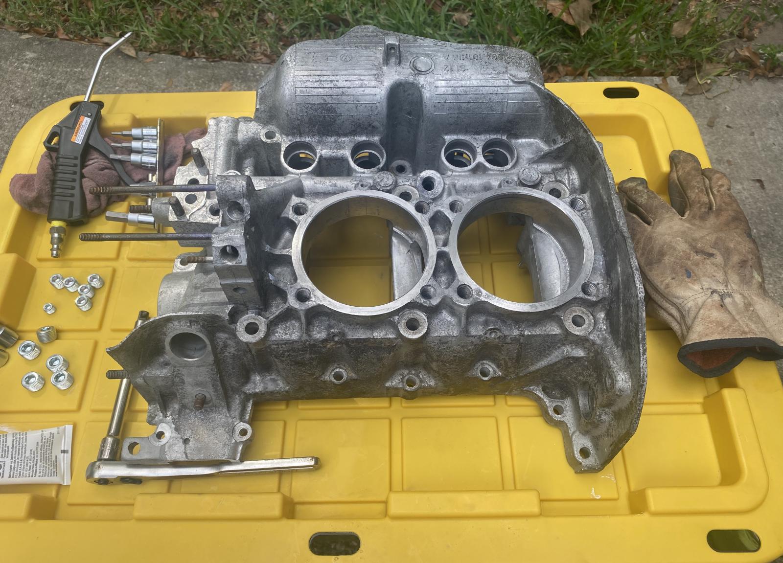

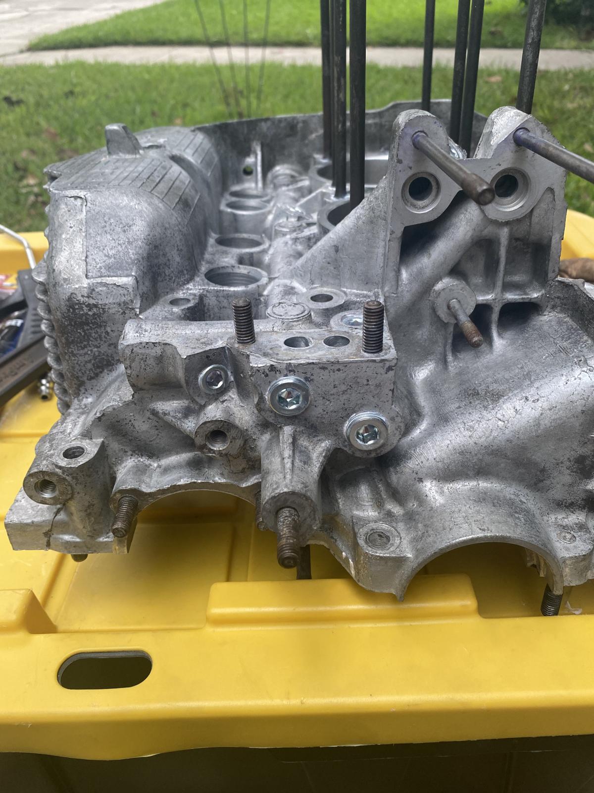

The case was decked for cylinders, align-bored, all the gallery plugs were drilled and tapped, and I had Rocky weld the ear for the breather tower back on. His work is beautiful:
A couple of months have passed since I first received the case. I wanted to make sure that I was free from distractions, before I dived into putting the engine back together. Eliminating some of those distractions involved restoring my old Essen trailer, and rebuilding the valve body on the transmission of a newly acquired 1995 EuroVan Camper. So this past weekend I decided to embark on cleaning and prepping. I started by using a set of nylon brushes to clean out the oil galleries:
This step is critical and we'll get a better look at why in a little bit, once we get to the crankshaft.
I used Castrol Super Clean to flush the galleries and get rid of any residual machining debris that might have been left behind. The case was squeaky clean:
However, I feel compelled to mention that the cleaner tarnishes the aluminum. This isn't of particular concern to me on the majority of the case. However, I wanted to make sure that I had not caused myself any headaches, so I polished the case, wherever machine work had been done. I'm not overly concerned with the appearance of the rest of the case, as most of it will be covered with tins etc. Ready to start installing plugs and cylinder studs:
I used Loctite 565 thread sealant to install them all:

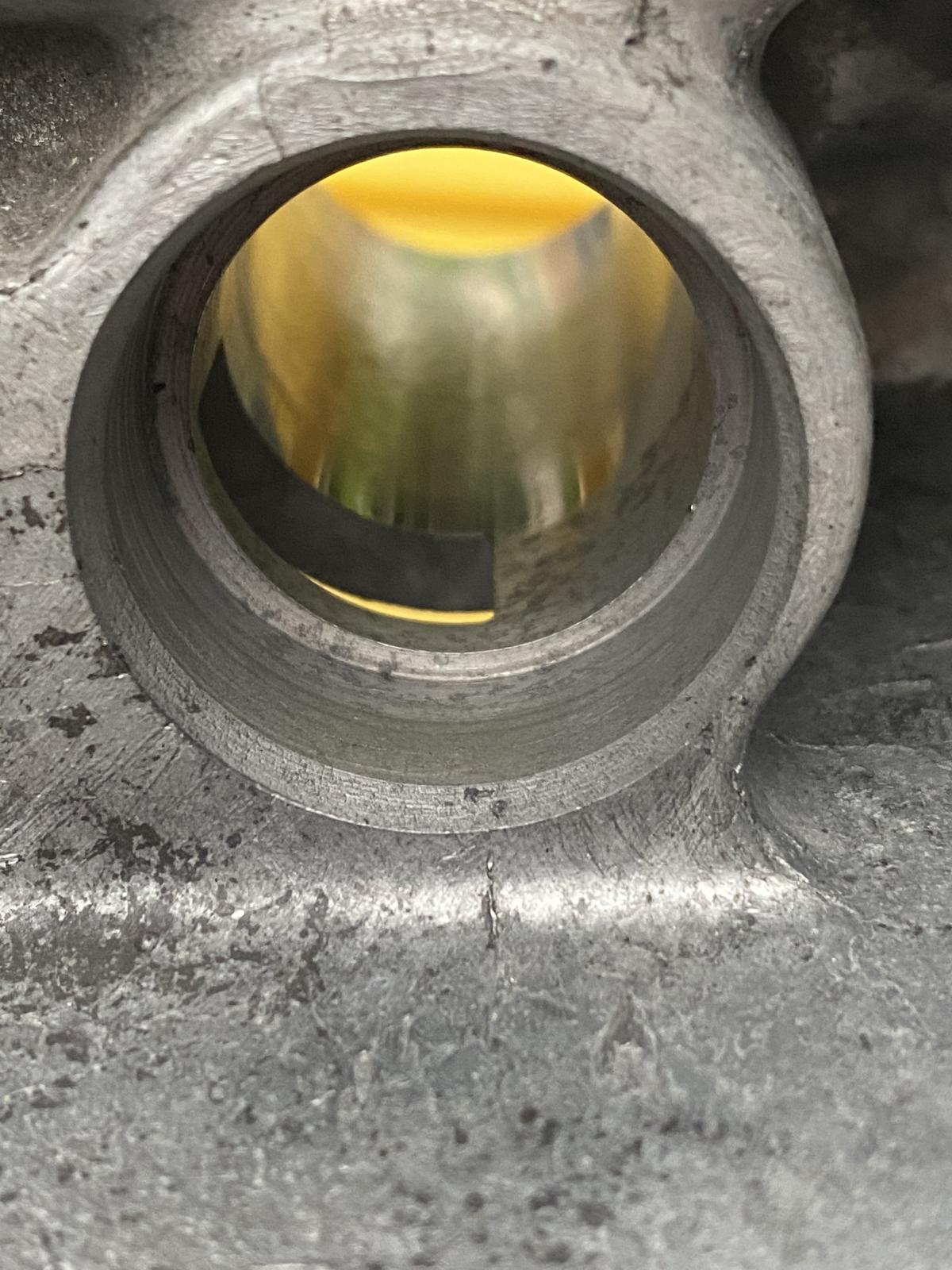

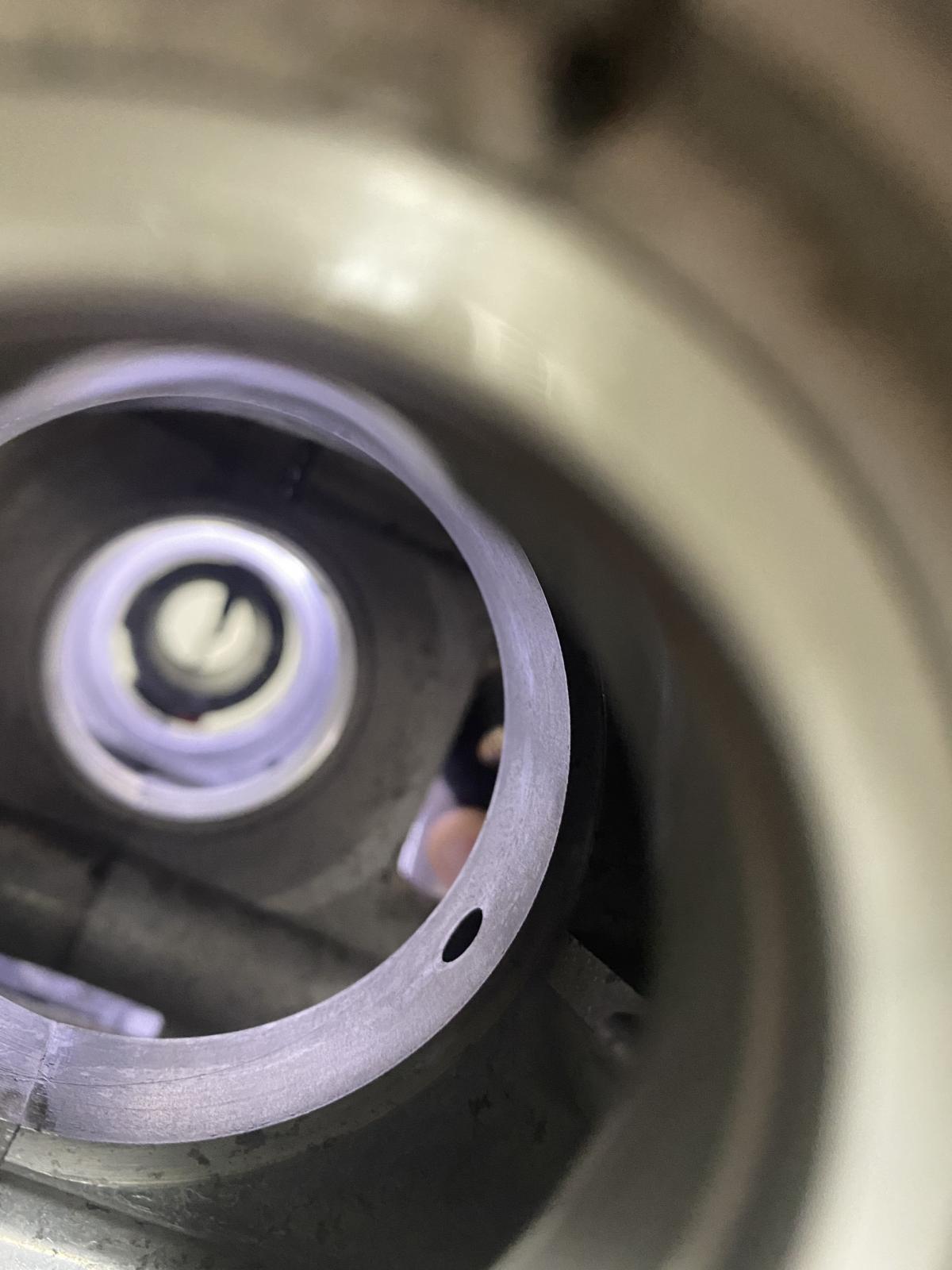

While I was prepping/cleaning the case, I also spent a little time with the lifter bores. Here you see that there was some mild corrosion, pits etc.
I know it can be a little tough to tell from the picture above, but I assure you that they needed some attention. My apologies, not a great shot. I tried to get a better shot in the image below, showing the results after polishing the bores. As I stated earlier, I had the opportunity to rebuild the valve body on my EVC. I bought some Bench Buddy Brushes:
They helped immensely! I used them to do all the lifter bores, as well as the bore for the distributor drive. Much smoother!:

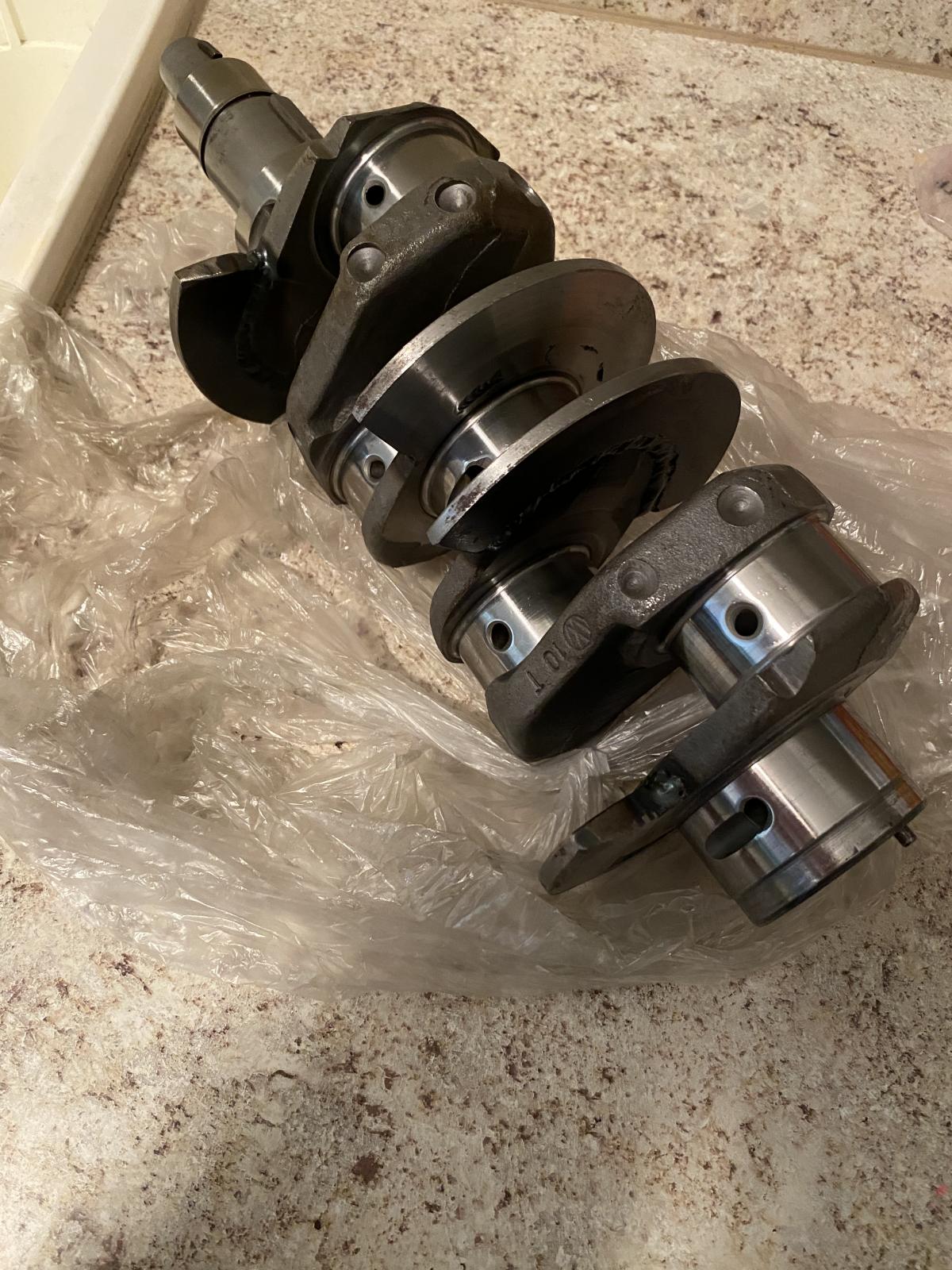

The crankshaft, rods, and the remainder of the rotating assembly were taken care of by Titan Engines in Ocala, Florida. I travel for work and happen to be in Ocala a few times a month. I stumbled upon Titan, purely by chance. I'm happy that I did! They ground down the crank and polished it. They also reworked all the rods, including new wrist pin bushings, and finally they balanced the entire rotating assembly.
I started with the crank:

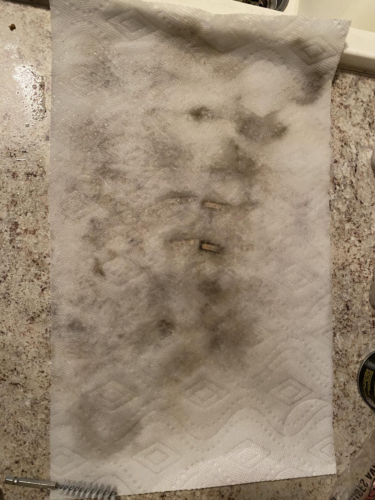

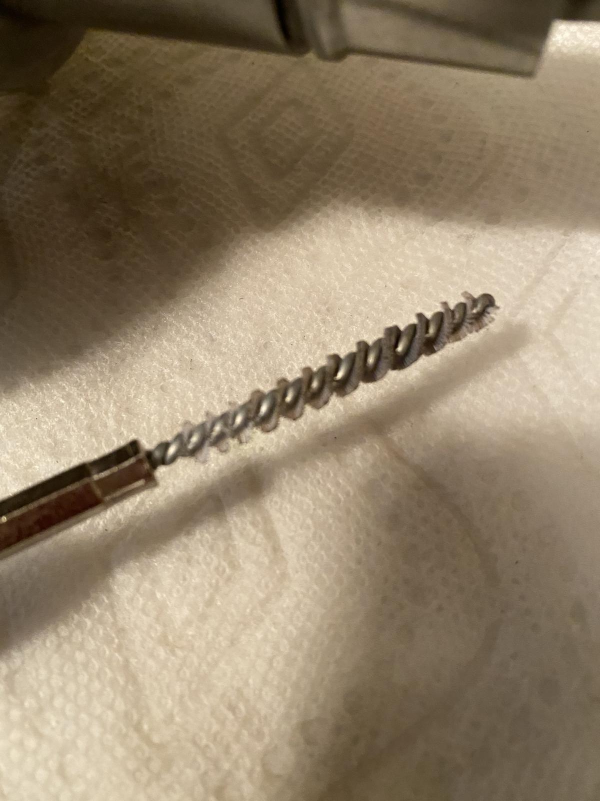

Before I put the first rod on the crank, I made sure to clean all the oil passages with nylon brushes. The image below is after one pass:
As you can see in the next image, the brush below is how they appear when they haven't been used:
Unbelievable just how much junk you'll find when you start cleaning these things!!! I worked the passages from both directions with a brush and brake cleaner, until there was no more residue left on the paper towel. Here's what it looked like after the initial cleaning:
Yuck!!! That is some gnarly stuff right there. Hard to imagine how that could do your newly assembled engine any good! Glad to have done it and know that stuff won't be floating around when we fire this puppy up.

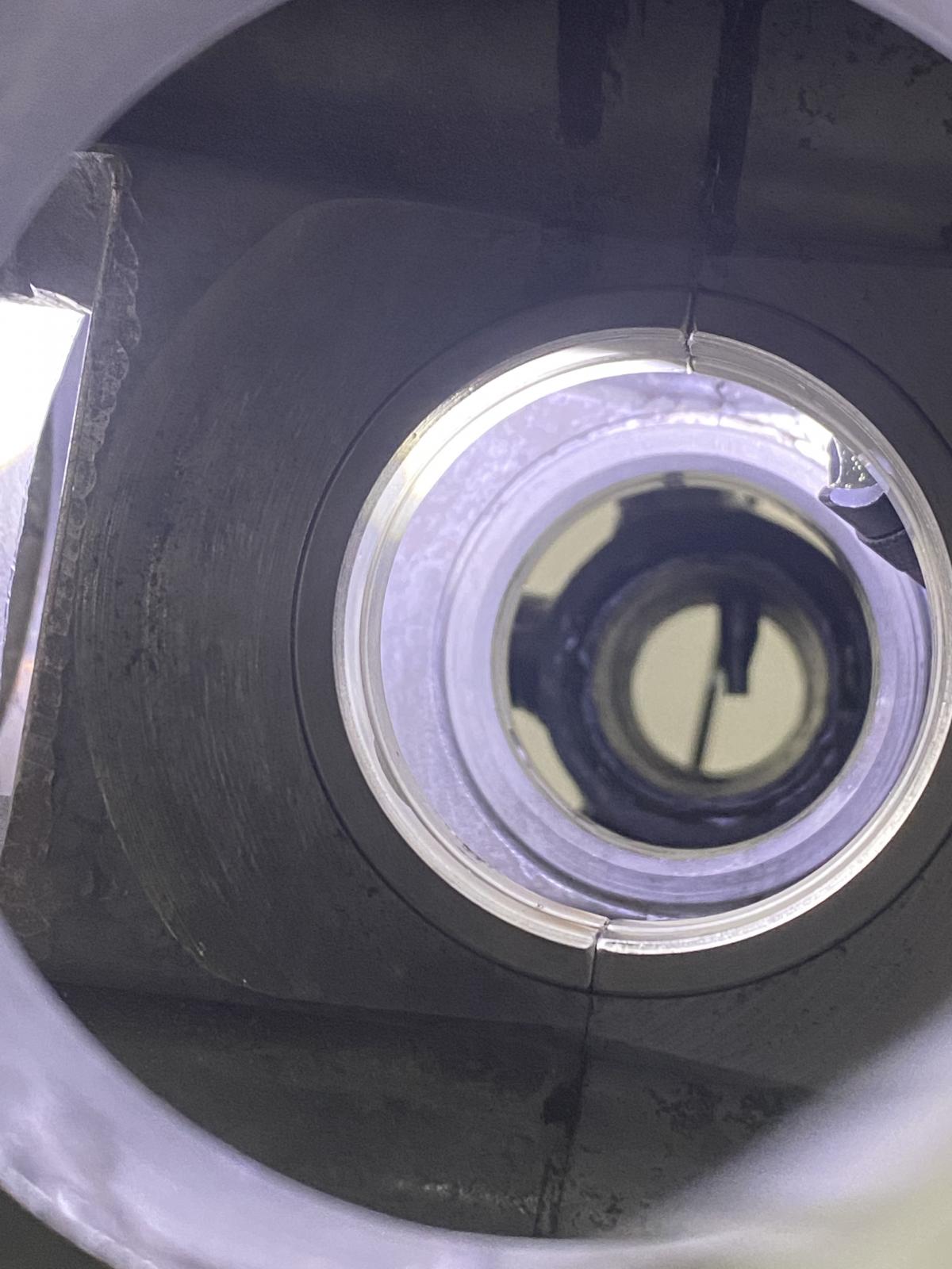

Once I had done that, I moved on to installing the bearings in the case. This will allow me to scribe both sides of the bearings to help when it comes time to install the crank. It also allowed me to check the oiling hole alignment on the case and the bearings:
I think they all look pretty good! I know its a little tough to tell on a couple of them, because the angles were a little tight, trying to get my phone in there to take the pics.
One thing I did notice was that the center main bearing was sitting a little proud of the case. I've read that it isn't all that uncommon on the Silver Line bearings, and that others are having similar issues. I will sand them down. Not sure if you can tell from the pictures below. It's not horrible, but still it's an issue that will need to be addressed:

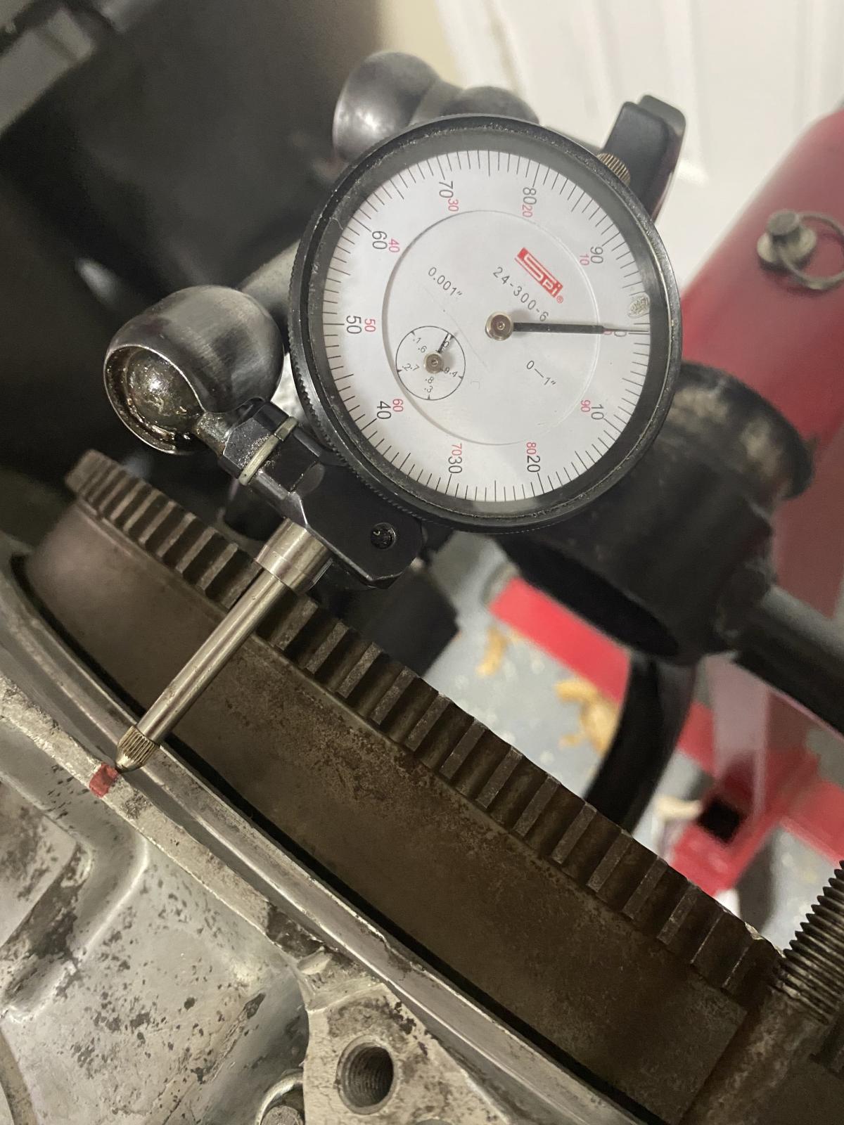

I had my youngest help me take the following picture, showing that the end play is at 0.003":
I'm satisfied with the results, and I'm glad to have that off my plate of things to do.

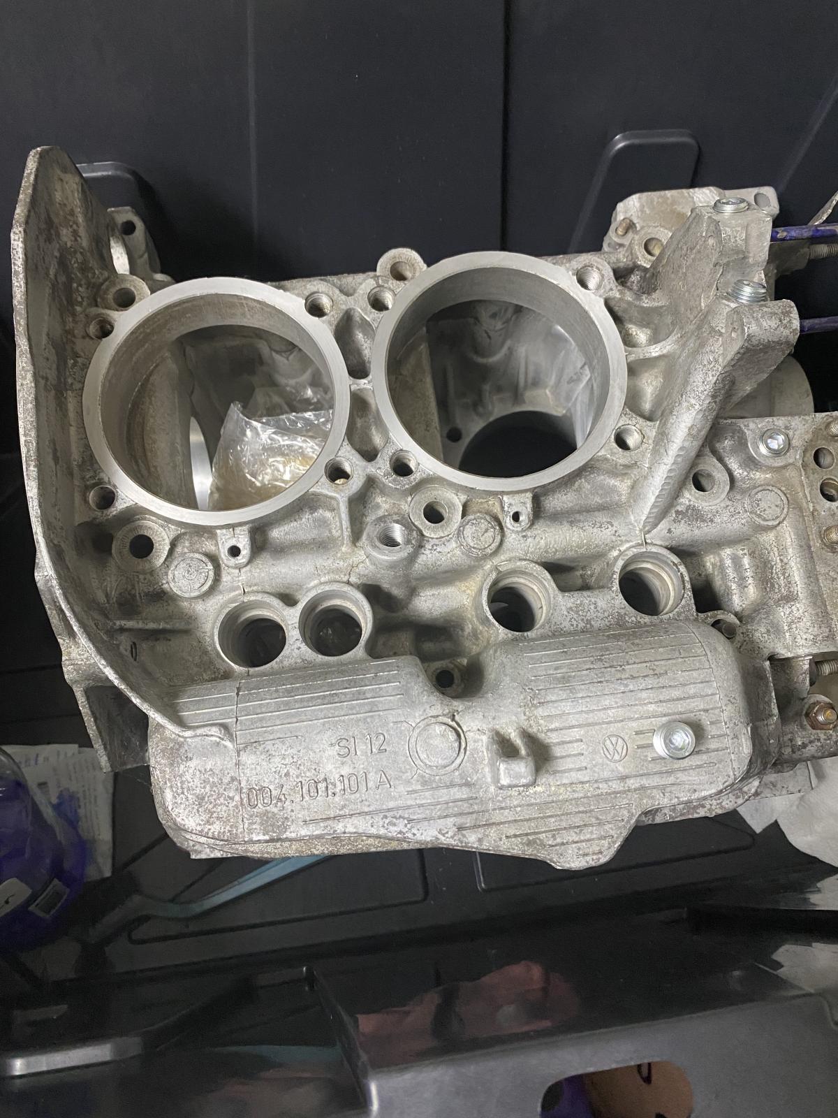

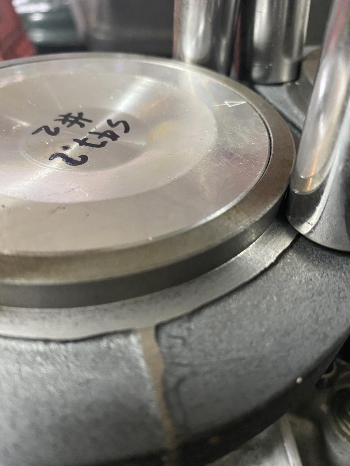

Next was to install pistons and cylinders, along with the shims that Rocky provided, after the case was decked. He sent 0.020" shims:
Next I installed the #1 piston and liner, without piston rings. I used 1/2" drive sockets on all four studs to bolt the cylinder down. I brought the piston to Top Dead Center (TDC), and readied my depth gauge micrometer. I was a little take aback to see the the piston was pretty much dead flush with the top of the cylinder:
Having a brief moment of non-belief, I repeated the same steps for #2, and amazingly got the exact same results:
I'm not sure why, but as abovementioned, for a fleeting moment, my brain nearly went into "Oh crap!" mode. Took a step back and sent Len my results. My initial reaction was to say, well if I remove the 0.020" and replace it with a 0.060" shim, then I'll be okay. Thankfully, having a second set of eyes, or in this case a brain Rolling Eyes Laughing Len stated that he would make sure to leave a 1mm (0.040") step in the heads. In theory it should give me a nice tight deck height of 0.040" or reallllllly close to it. After much discussion with Len and based upon the cam profile (Raby 9590) heads with the larger valves, etc. I'm hoping to keep the compression ration around 7.7 : 1. This decision was made based upon suggestions that I read, made by Jake in the past that stated the optimum CR for a bus being kept between 7.7-8.3 : 1. (Edit - based upon using his cam, and a set-up that closely resembles a Camper Special.)

Another fairly productive day. Spent a little time going over my findings with Len, and after some back and forth, we've made a couple minor changes. There was some misunderstanding about the size of my engine...no biggie. That's why we keep talking and making sure we're doing things properly. Understandably, Len thought I was building a 2L instead of a 1.8L Here's what we came up with:
.040 deck = 6.8cc's
Piston dish = 10cc's
Chamber volumes = 50.2
That adds up to a total unswept volume of 67cc's
66 x 93 = 448.4cc swept volume
448.4 + 67 = 515.4
515.4 / 67 = 7.7:1
I'm going to eliminate the 0.020" shims and add 0.040" shims. Len is going to machine the step on the new heads to 0.020" which will give a total deck height of 0.040"
I ordered new shims for the cylinders as well as flywheel shims to replace the old ones used in the mock up.

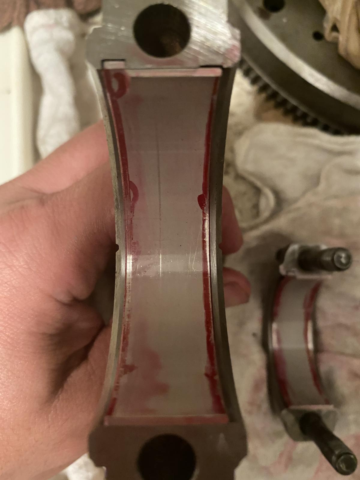

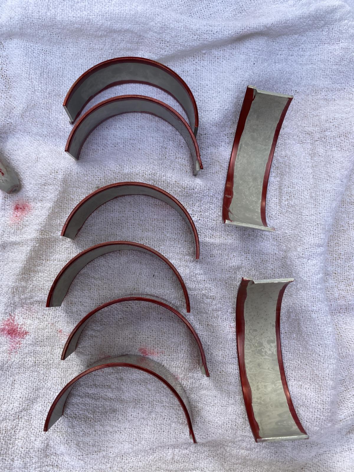

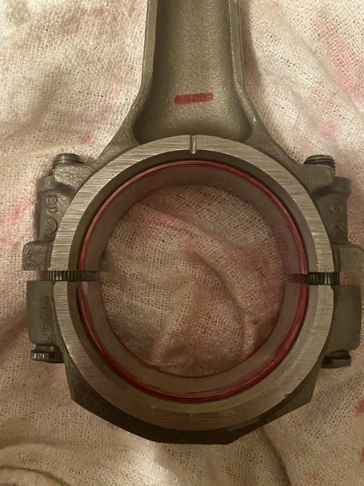

I pulled the case apart again today, in order to closer inspect rod bearings. After removing the crank, I managed to get a couple of pictures of the case parting line. Pretty happy with what I saw. I apologize for the first picture...kinda tough to take the picture and hold the light at the same time:
With that behind me, it was time to take a look at the rods and bearings. I removed them from the crank and was fairly pleased with what I saw. I don't think there going to require a ton of work. They all looked like this one from the side profile:
No real significant amount of pen markings were missing from the sides. Once I opened them up, I noticed a little wear at the edges:
I'll have a go at them tomorrow. Once I'm satisfied, I'll put them all back together and use assembly lube for the final time before installation.

What are you checking on the rod bearings with the red sharpie. Glad you got the center main sorted. Did you end up having to sand it?

PostPosted: Wed Jul 01, 2020 10:56 pm    Post subject: Re: 1800cc Type 4 engine rebuild - 74 westy Reply with quote
do me a favor. Pull the rod bearings and take good clean shots of the bearing saddles, especially at the part lines. Post them.
Can do, will do. It’ll be a little later today. What are we looking for?
Hey brother!
No sanding required, which was a welcome relief!
As far as the rod bearings, I’m mainly concerned with radial clearance on the crank. Not sure if you’ve been using Jim Martin’s build thread as a guide? Good information there. It is Type 1 specific, but I figured I’m here, may as well give it a look see. How’s things going for you? Still marching onward?

PostPosted: Thu Jul 02, 2020 8:39 am    Post subject: Re: 1800cc Type 4 engine rebuild - 74 westy Reply with quote
white74westy wrote:
scribe marks. I want to see how the shop measured them. The scribe marks will tell me how skilled that craftsman was - or how sloppy, and if you might want them checked. Being totally honest someone really leaned into sanding the sides of those rods. Be sure to check the side clearances.

Notes about this image. First of all looks like you are doing a nice careful job. Yay! BUT, for people looking and not having done this work before:
Setting end play with a dial indicator in.001" is a pain. You have to do so much math calculating back and forth between .001" and .01mm and the calculations have to be done in both directions. The conversion between inches and mm creates an error factor, as does measuring the shim thickness because more than likely you're not using new shims with markings on them. You can convert most of the math to .001" but the shims are still size in .01mm as is the spec for nominal end play.
With a dial indicator that measures .00mm the math is so easy and removes sources of potential errors.
I really appreciate the honesty!!! That's what this is all about. I'm trying to ensure that I put together the best engine I can. These types of things must be checked in order to do so.
Unfortunately, I could not see discernible scribe marks. At one point I thought I could, but then I wonder if its not just my eyes playing tricks on me. Cross hatched, yes. Scribe marks, maybe. Any attempt to take pictures was futile. Can't get anything to show up in the images.
I checked the side clearances on all the rods:
#1 0.016"
#2 0.014"
#3 0.015"
#4 0.016"
Thankfully all within tolerance.
Hi Scott,
Thanks for checking in! I couldn't agree with you more! Life would be so much easier if that were the case. Unfortunately, the tools that I have access to are standard, rather than metric. Thankfully, my books have both units of measure listed and it helps in keeping things straight.

PostPosted: Sun Jul 05, 2020 8:35 pm    Post subject: Re: 1800cc Type 4 engine rebuild - 74 westy Reply with quote
take a photo of the rod halves on one rod, the bearing saddles specifically. I'll tell you where the scribe marks are. You have to know what to look for.
