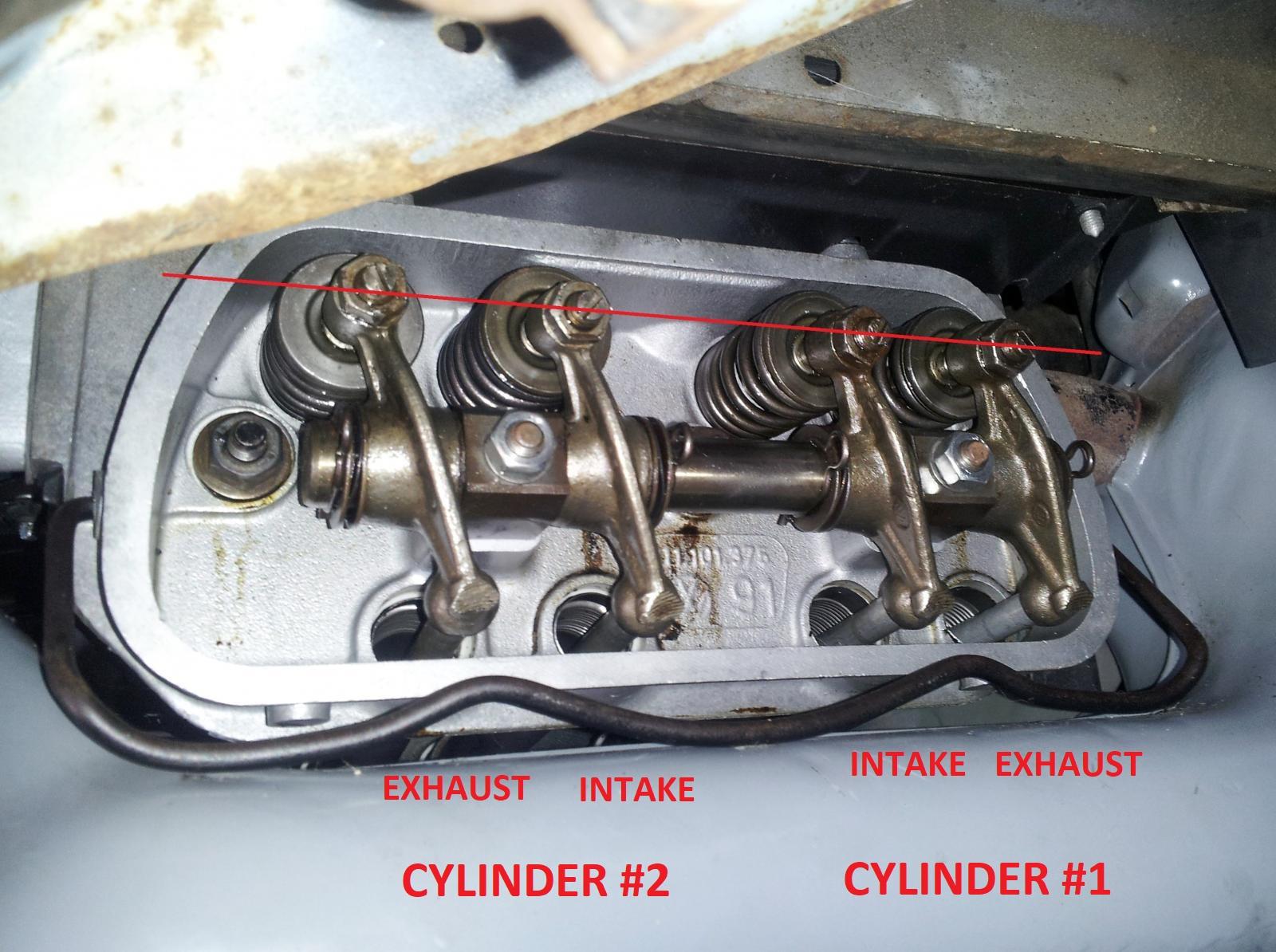

Here is an image of the pulley, to help you see where TDC (Top Dead Centre) is. BDC (Bottom Dead Centre) is 180deg.
You need to wait for your engine to be stone cold (ideally overnight) to adjust the valves. So read up, ask your questions, and re-adjust on Sunday.
