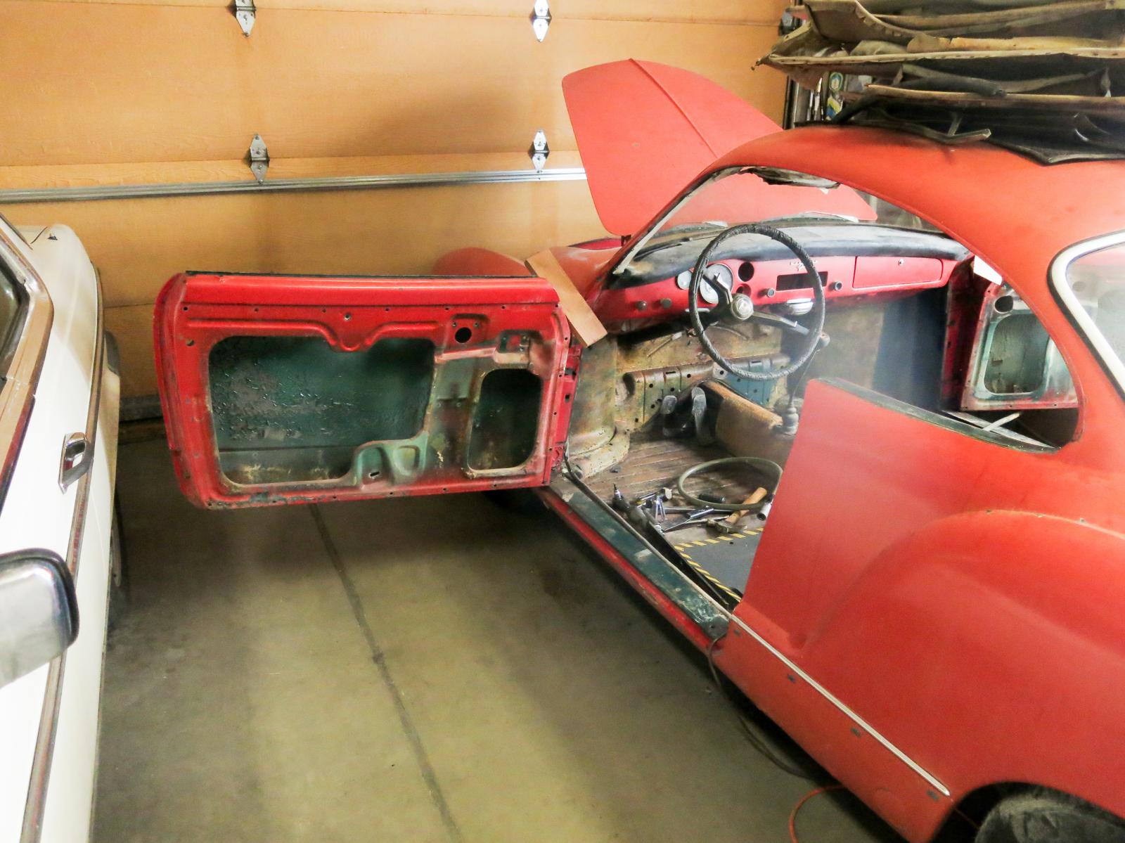

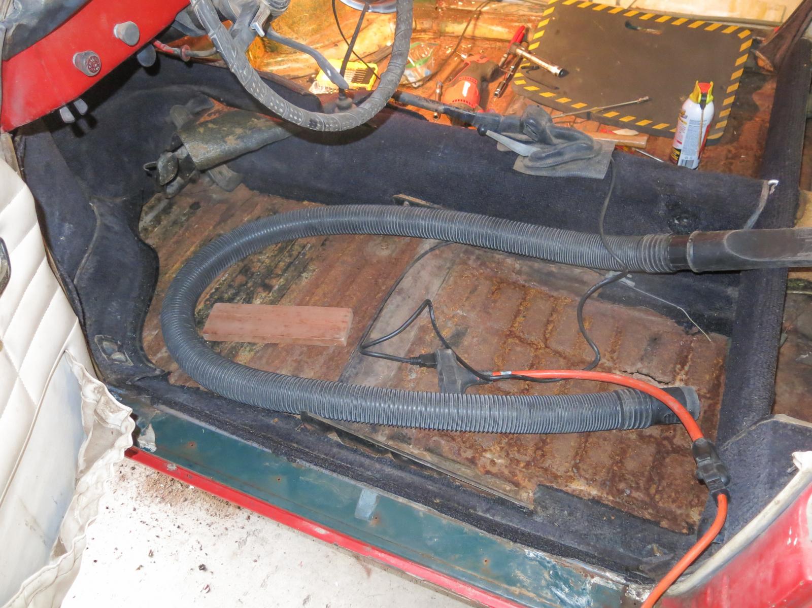

I am a hobbyist, not a professional, and therefore have way more questions than answers. I bought this 67 Ghia coupe from a friend who didn't know too much about it other than it has been sitting for quite a few years but was a daily driver in the not too distant past. Based on what I have seen so far it looks like it was professionally repainted at some point (changed from green to red) but the interior appears to be original. There is no engine with the car but the transaxle is in it. I wish I had taken more "before" pictures but I am anxious to get it to the body shop so I have been busy stripping the interior and the glass. The pan areas under the driver and passenger seats are rusted and will need to be replaced. The following pictures I took along the way and as of now the seats, carpet, under-carpet sound board, door cards, and all four operable window are out, along with all the hardware and locks. My goal is to get the body off the pan and send it to a media blaster and then to a body shop. I have never done this before and I'm not sure what the process is with the pan, but I'm hoping to learn along the way. I do not know how to weld, unfortunately. Next I intend to get the rest of the glass out and then the gauges. Any and all comments welcome. Thanks!

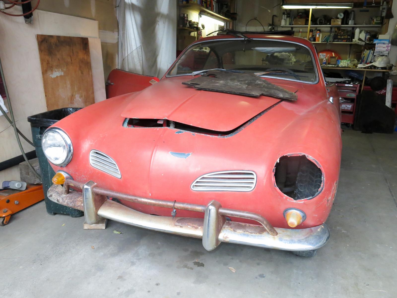

Nice buy, congrats. Looks like it was a Roulette Green car.
https://www.thesamba.com/vw/forum/album_page.php?pic_id=1754330
Looks like you have a good start, they come apart one bolt at a time. Cool
Take your time and bag and tag everything. Most of the original parts, once restored are better than repops. Dont throw anything away.

I did the exact same thing 27 years ago. You will find once you start pulling it apart there will be more areas that need attention. In my case I pulled the body off the pan, and had both the body and the pan media blasted. In my case I just needed to replace sections instead of the whole floor pan halves as the car was fairly solid. Although I have no direct experience, I hear the Dansk floor pans are thicker. I didn’t have to replace my heater channels or rocker panels, so I have no experience in that arena either.
I actually fixed my pan first and then send it to the media blaster. I took all the pieces and parts at once and then re-coated everything on my own afterward. The people that media blasted it actually cleaned it and primed it when they were done to protect it from rust and that primer to this day has not let loose I really don’t know what they used but it was cut with Naptha and Toluene.
At one point I thought I should have the body dipped rather than media blasted but I did not feel comfortable having all the interior channels of the metal striped clean.
I don’t know if I’ve actually answered your question or if I’m just rambling.

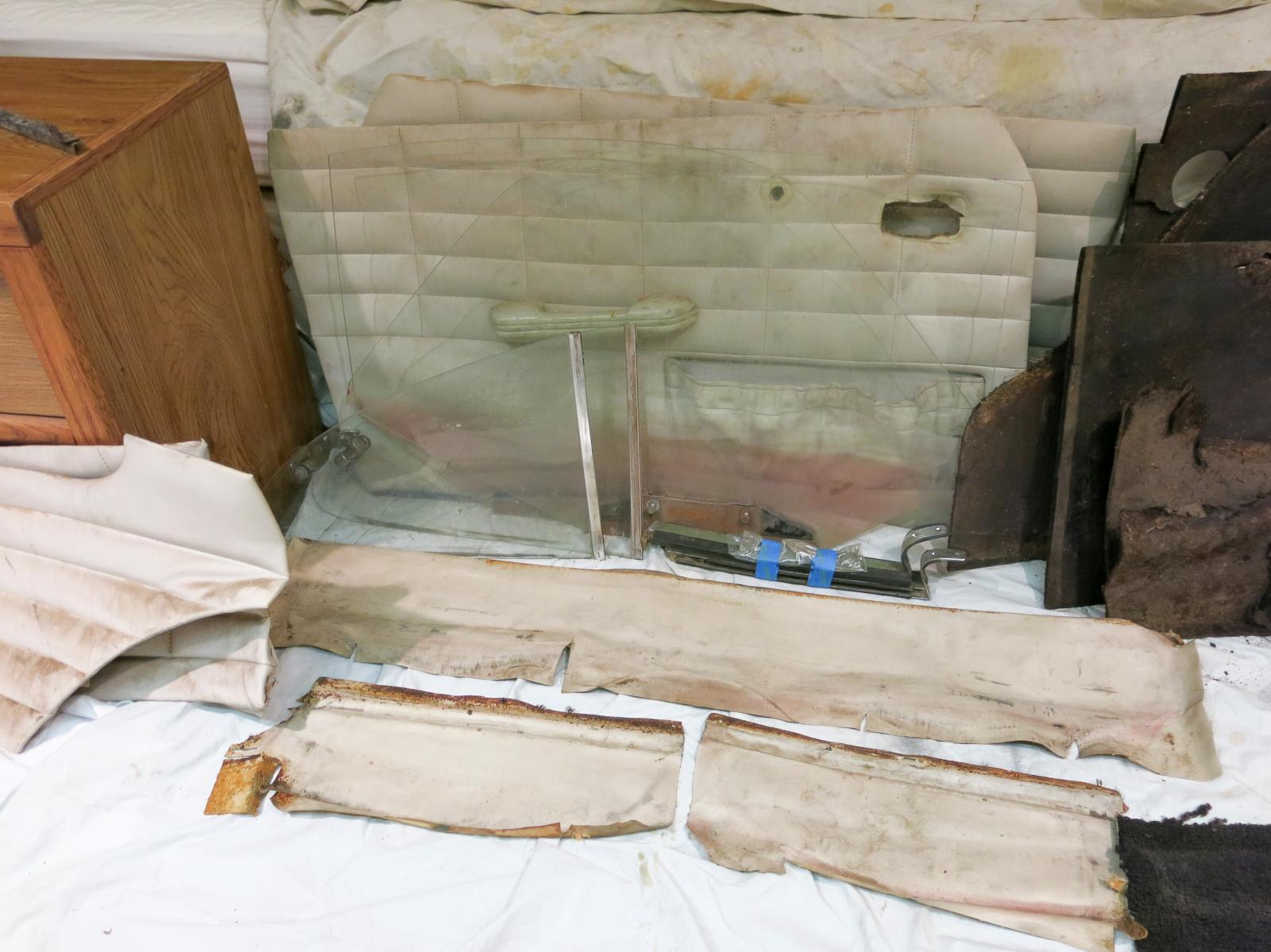

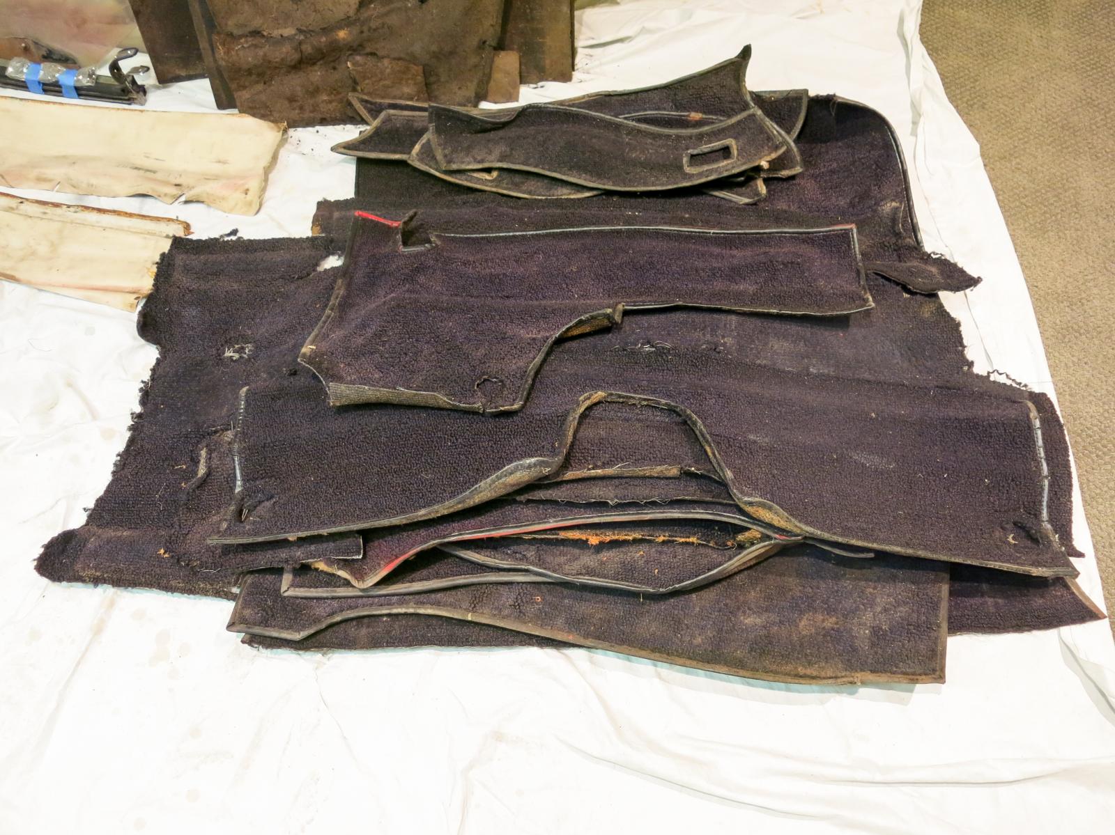

Thank you, I have not thrown anything away and would like to re-use whatever I can. I'm even thinking of taking the leatherette off the door cards, cleaning it, and putting it on new door cards that I make. Also would like to use the original soundboard under the carpet, and the carpet itself for that matter. I guess I'll just have to see what the carpet looks like after its been cleaned. The front passenger soundboard delaminated but I think I could get it pretty well back together with some liquid-ish roofing tar and hope I don't add any foreign smell. The rear ones aren't great either but I might try to use them doing the same type of repair but I am completely open to suggestions on all this.
The front seats have to be recovered but the "emergency" seat parts look like they might work once cleaned.
Oh and thanks for the picture of the green car. Beautiful! Maybe we will stick with it!
Chrome, rubber, and aluminum parts
Keeping everything bagged including all fasteners
Rear cards
Soundboards
Window glass
Carpet

I plan to get all the fasteners out that hold the body to the pan, but leave four for transportation to the blaster, and then have both blasted if they can do it. I've never done this before so we shall see. I think that it is good idea to weld the new pans in after blasting. I was hoping to keep the insulation on the transmission tunnel but that may not happen. Thanks for the help!

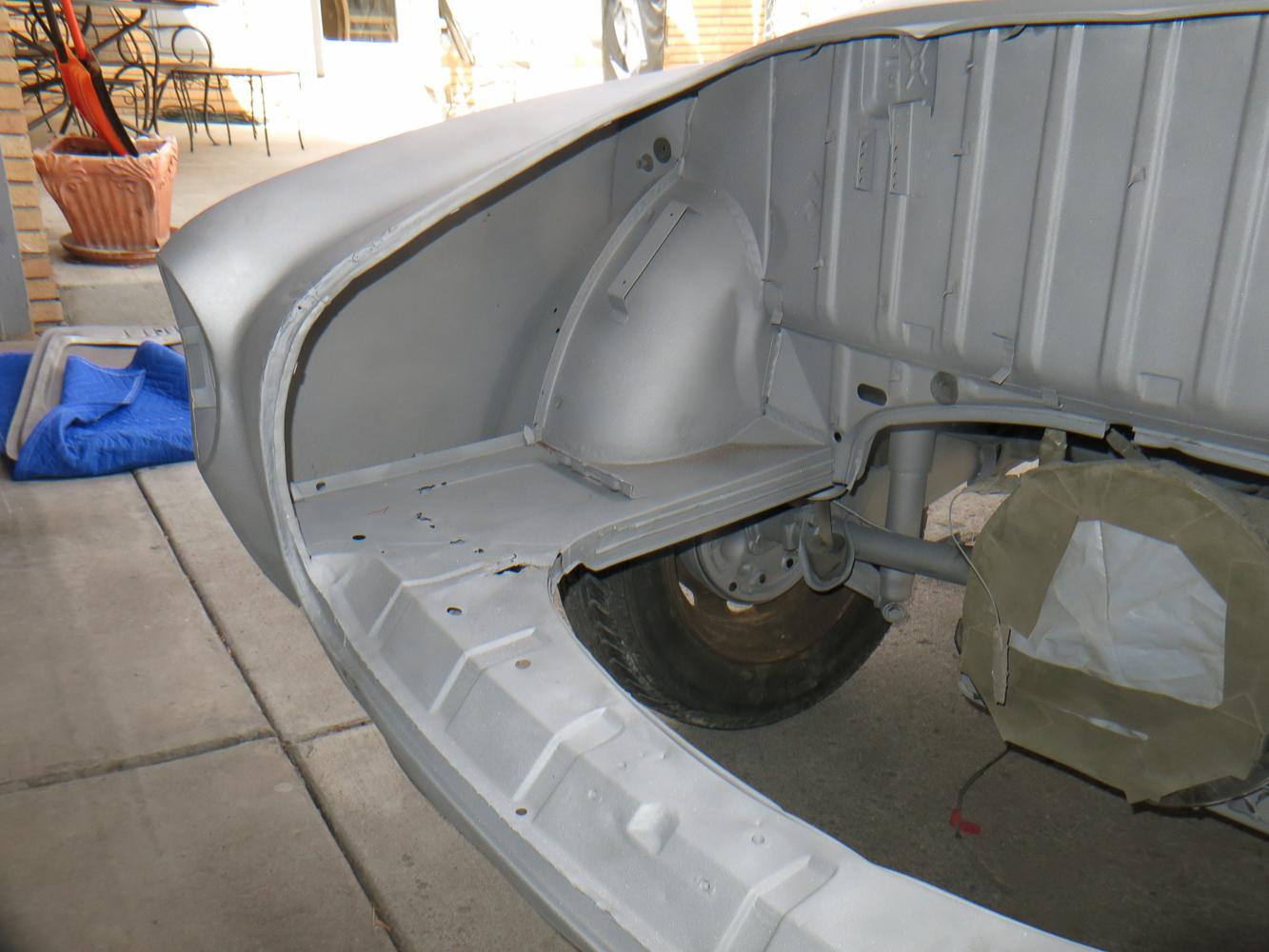

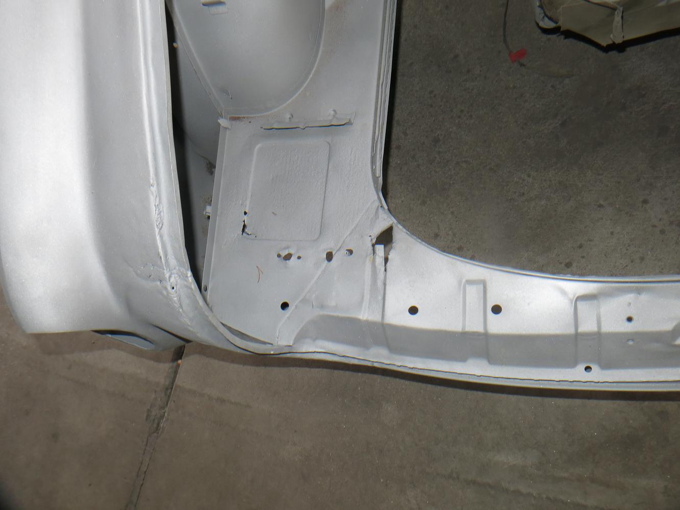

Welcome to the Ghia world, will t! I hope you see the project through to completion, or at least to a driveable condition.

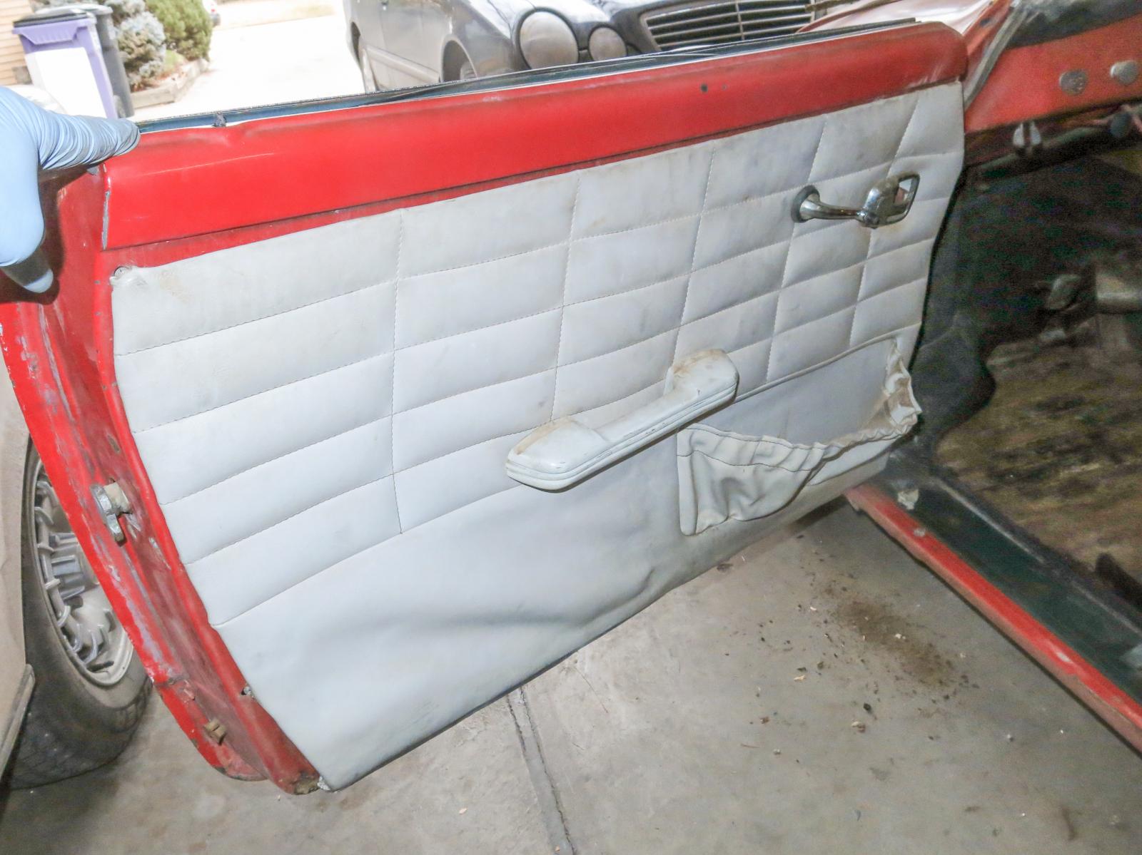

Your carpets appear to be originals, with the grey/black vinyl edge binding. I recommend that you try to save the individual pieces. Shake them out, bang them face-out against a wall to get loose dirt out, then put them into the washing machine with regular clothes detergent. Warm water, regular cycle. Hang each piece up to dry on a clothes line, letting it hang down instead of draping a larger piece over the line. You may be pleasantly surprised at the result, even if some small areas are worn.
When you are ready to take the shell to the body shop, make certain that you advise them to:
1. Leave the 2 small holes in the rear apron open instead of filling them in. They are M6 thread nuts to hold the diagonal metal support bars for your rear bumper overriders.

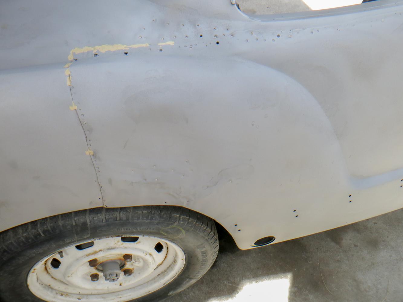

2. Don't fill in the vertical seams on the new rocker outer panels that are below the doors. Both the front and rear seams are supposed to be there.
3. Don't fill in the round piece that's just ahead of the rear fenderwell opening. That piece is a removeable cover (1 small nut on inside of fenderwell) to allow the rear axle torsion bar to be pulled out in case of servicing.

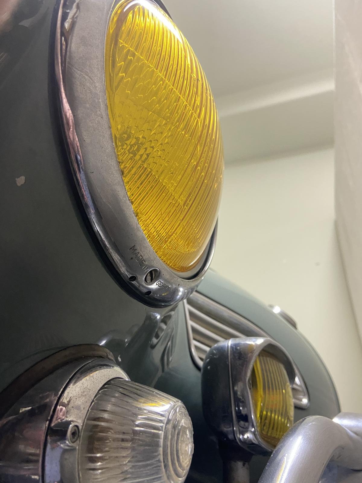

4. Carefully position the replacement headlamp buckets so that there is a small ledge going all around the bucket. This is for holding the factory headlamp trim ring rubber gasket. The bucket needs to protrude approx. 3/8" from the fender to give enough surface area for the gasket to sit. The gasket fits between the trim ring and the fender. You can see it here on this '61 (kingkarmann gallery).

Hands stripping is the best way. Media blasting in the wrong hands can result in damage to the panels plus media getting into every crevice imaginable and coming out later.
Paint strippers work pretty well. I used Citrastrip recently on a 58 panel bus. The trick is to let the chemical sit for at least 30 minutes, scrape, then spray a mist of water on it to reactivate it and scrape again.
It’s messy but the best way to do it.
Duly noted, thank you! I will pass this along to the body shop when it comes time. And I will do my best to re-use the original carpets. They came out nicely with not too much of a fight so I expect them to clean up pretty well. Great picture by the way.

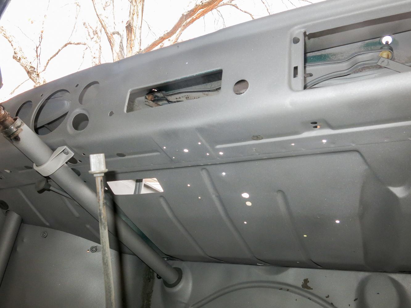

If you want to strip the paint yourself, it will save you a ton of money. An easy and safe way to strip is with these Polycarbide Abrasive wheels and an angle grinder. The wheels cost about $6 each at Harbor Freight. Or packs of 10 on Amazon for $45. I had 4 coats of paint in places and One wheel striped a complete door and half the deck lid. Each took a little over an hour. These wheels do not do any damage to the metal.

PostPosted: Wed Jan 27, 2021 6:56 pm    Post subject: Re: 67 Restoration - not my first VW but it is my first Ghia Reply with quote

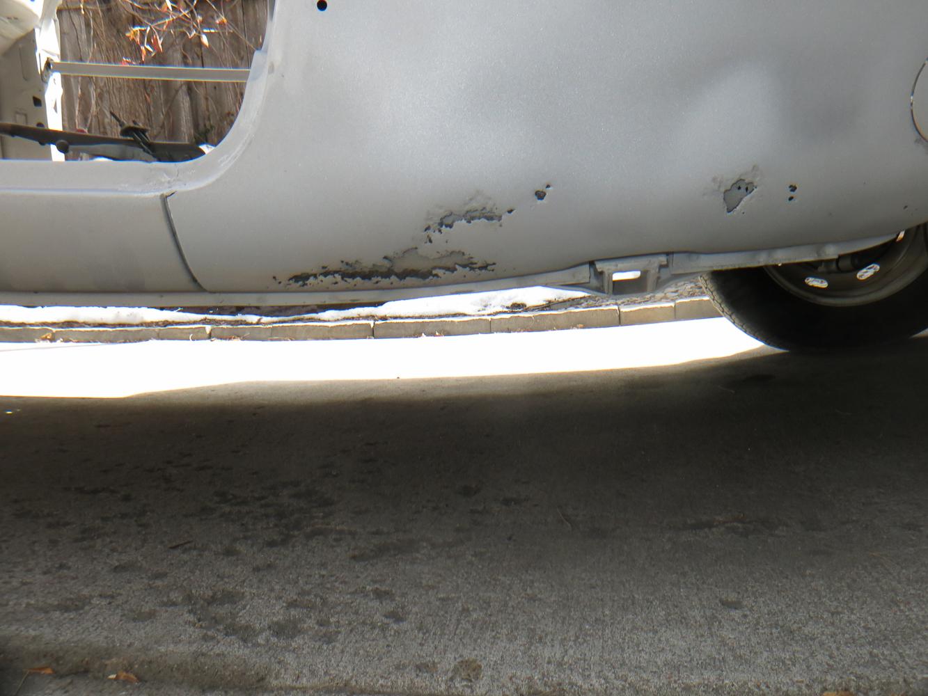

I just realized I goofed up. Photo was in 61karmann's gallery, not kingkarmann's.
Here's another reference shot of headlamp rings and the rubber gasket, barely visible but definitely there. This is from 67 Florida Deluxe's gallery of his fine, all original '66 Cabrio.
Not easy to see due to the light paint color and strong sunlight, but important details:
1. The nose ridge that runs from the hood openjing and down the center, has a definite profile whereby the "slopes" of the ridge are "steep". Many repairs reshape the ridge with filler so that they are shallower, especially when the ridge has been damaged from impact and the shop/restorer does not have a reference to an undamaged ridge.
2. The other spot which is often not correctly done is the front edge of the fender above the headlamp ring. There is a slight peak to the fender contour that peters out just before the ring. Many times that peak is incorrectly continued right to the edge. It may look right to the shop, and to most non-Ghia observers. Repair pieces for the headlamp surround section are usually correctly shaped at the top, but the repairer carries the fender peak too far forward with filler.

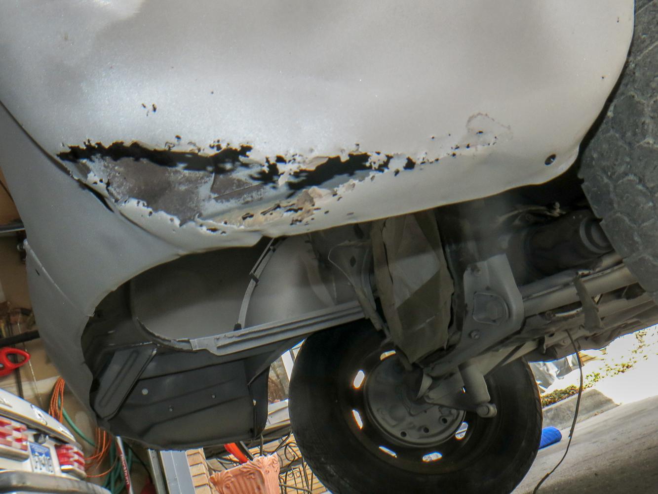

I'm now in the process of separating the body from the pan. It is evident that due to rust I must replace both sides of the pan - full length replacements. Can anyone recommend where I would source these pan halves? I see quite a few of them offered here and there but thought if there is a range of quality I would like to be able to get the right ones. Any suggestions welcome. Thanks!
