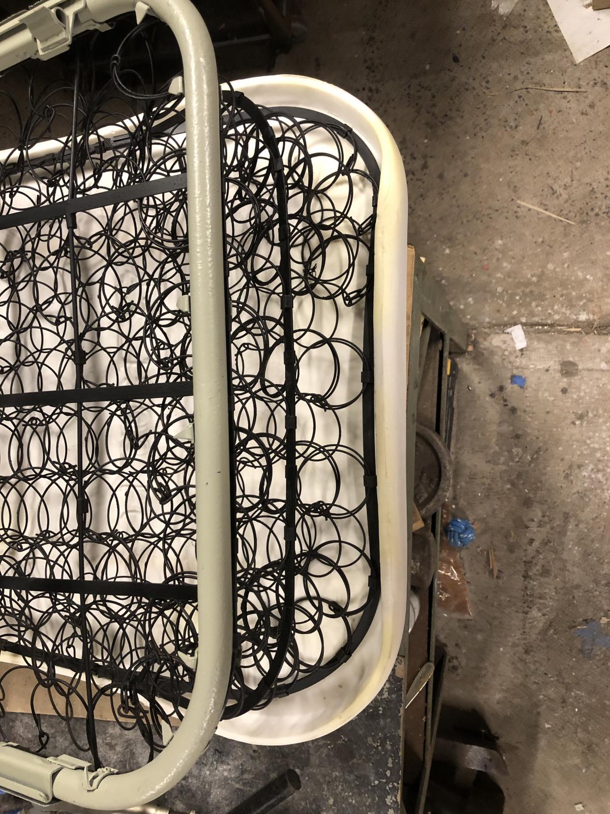

I restored my beetle seats this spring, using the foam pads. I hog ringed canvas across the top of the spring assembly and then glued sisal to the canvas. That extra bit of sisal may take up some of that slack. The foam pad went on over the sisal.

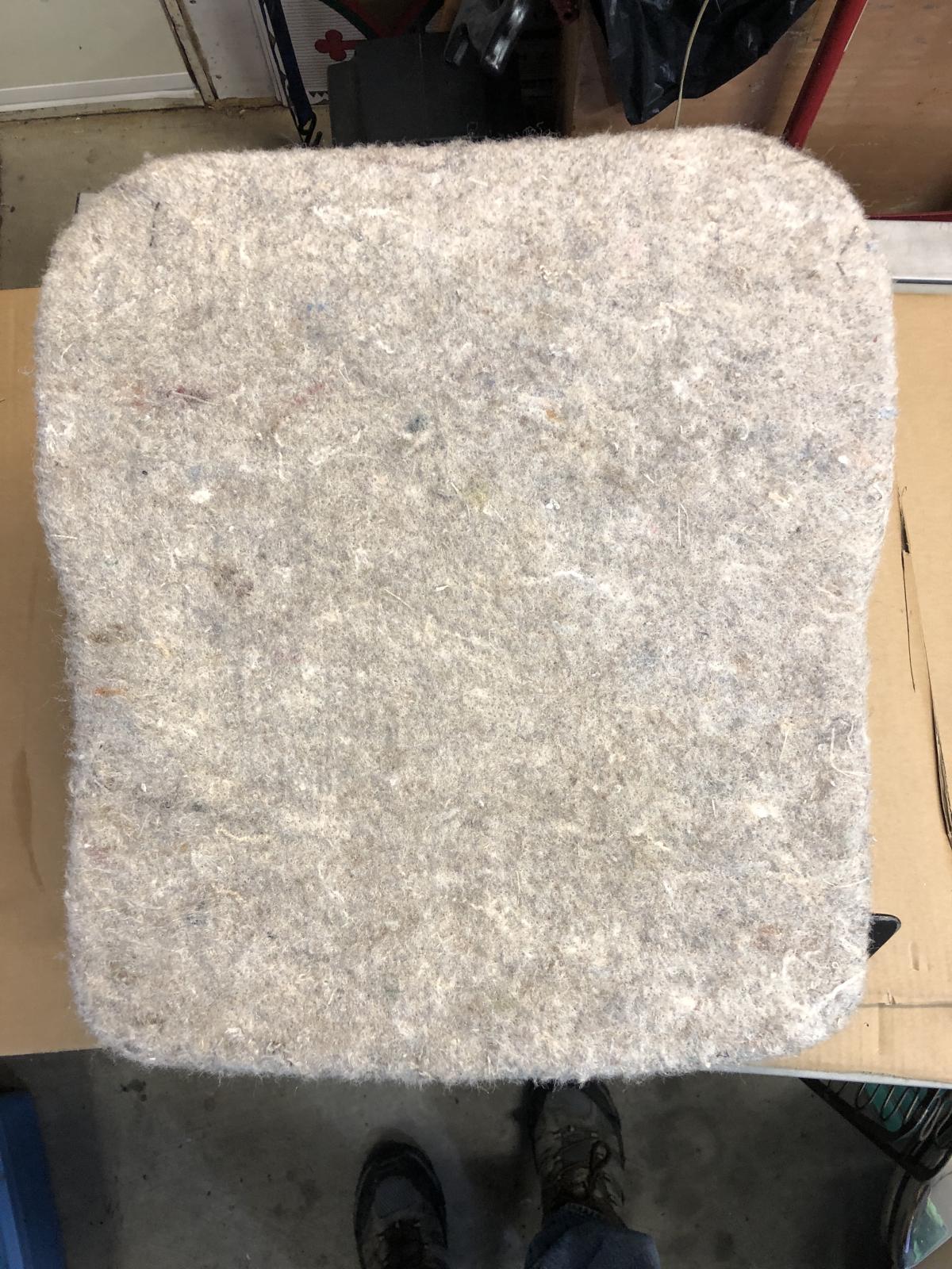

PostPosted: Tue Sep 05, 2023 8:30 am    Post subject: Re: TMI Seat foam fit? Reply with quote
a trick I use to effortlessly securing all the rings, clips, and string.
