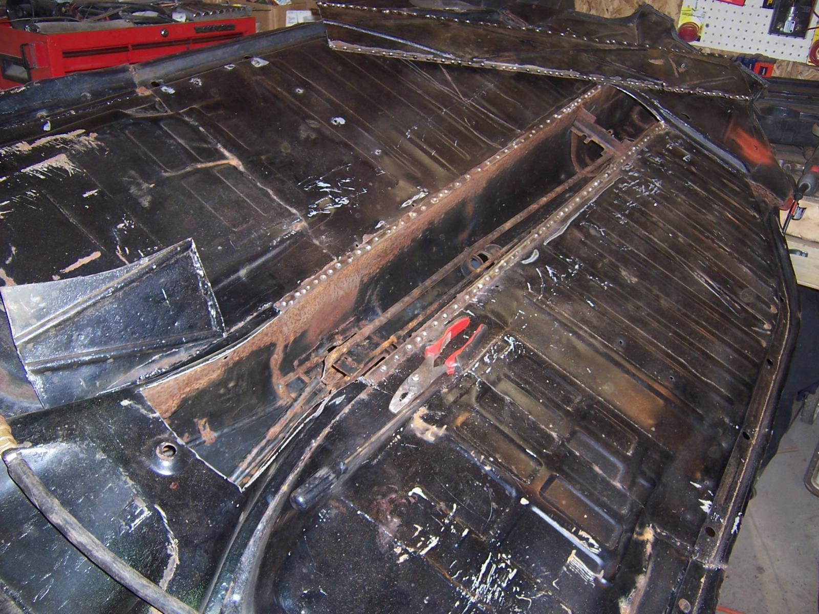

PostPosted: Sun Dec 03, 2023 1:56 pm    Post subject: Re: Deserter Series 1 build Reply with quote

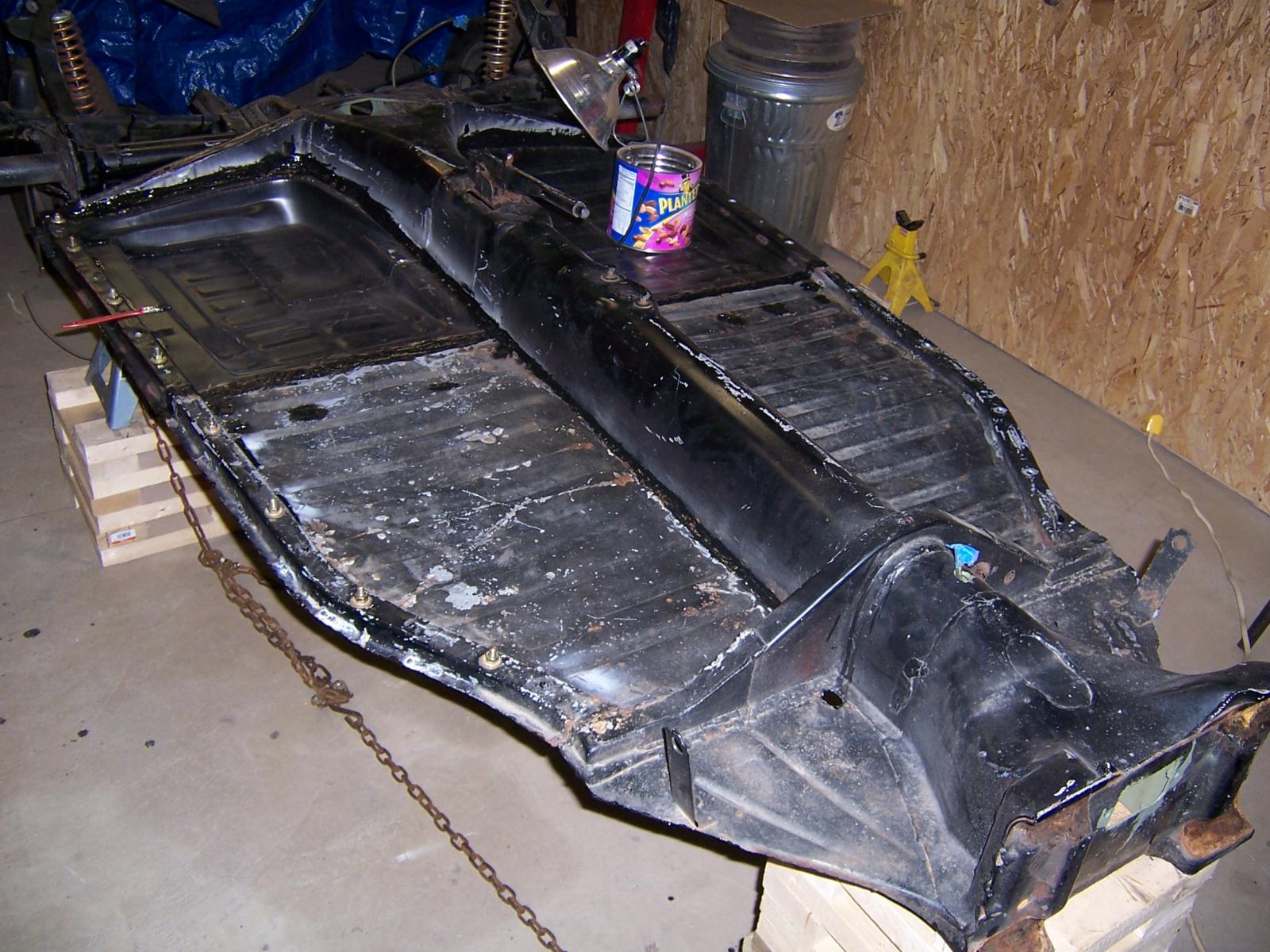

Continuing the evaluation I dug in to the chassis to see what I had to work with.
The chassis was already shortened when I got it from the PO. The tunnel was welded well but the floorpans were a disaster with uneven outer rails.
Deserters have an 84" wheelbase. Longer than the usual 80" length. Instead of removing the 10.5" section to shorten the floorpan, whoever did the work overlapped the ends. Rust formed between the layers. Not good enough for me. This would have to be redone.
Whoever cut the tunnel sawed right through the clutch and throttle tubes.
I guess as long as he had the sawsall in his hand he decided to cut this off. Oops.

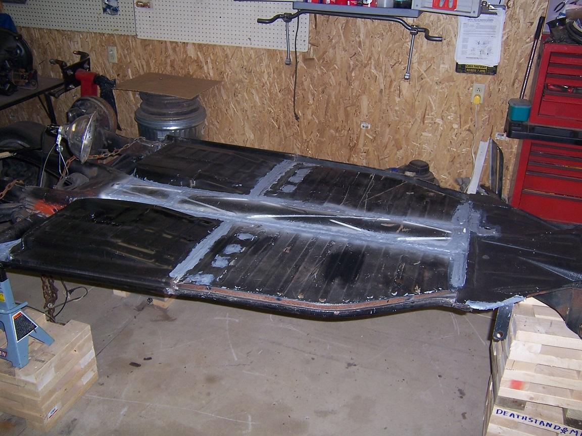

PostPosted: Sun Dec 03, 2023 2:28 pm    Post subject: Re: Deserter Series 1 build Reply with quote

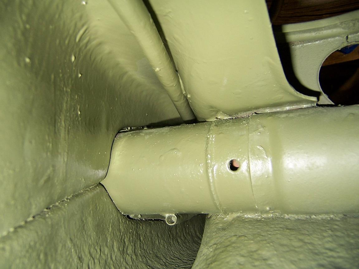

The first thing I wanted to correct was the hacked through clutch and throttle tubes. Also to run a new fuel line.
I stripped the pan and flipped it over on supports. I drilled out a few hundred spotwelds and made a few cuts to reveal the stuff I needed to fix.
The parking brake tubes, clutch tubes and throttle cable tube were severed. The fuel line was mostly gone. I removed the tubes for the heater cables and set about splicing the ends together.
I used short lengths of tubing to connect the ends and welded them in place. I ran a new fuel line too. 1/4" coated steel.
I replaced only the rear half of each floorpan as the front half was good. I shortened each pan quater the way the Deserter build manual shows. Lots of carefull measuring and cutting but they turned out well.

PostPosted: Fri Dec 08, 2023 11:11 am    Post subject: Re: Deserter Series 1 build Reply with quote

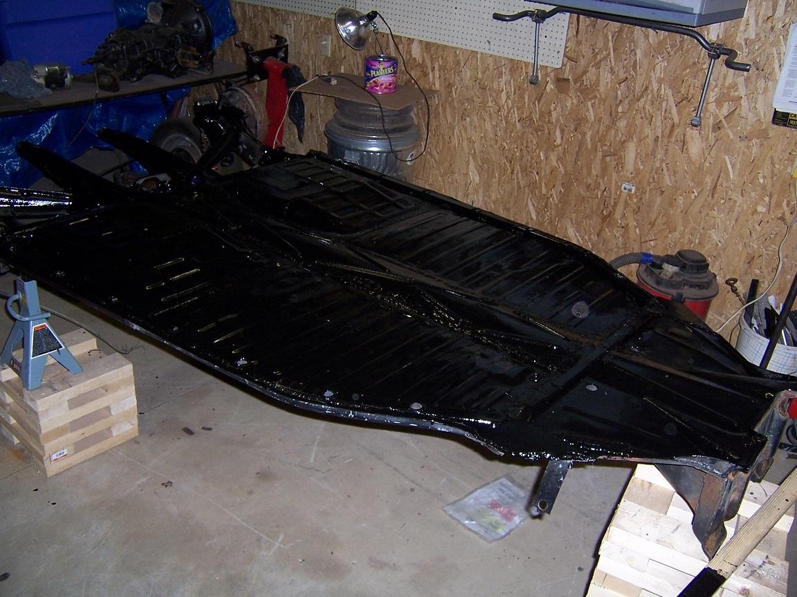

While the bottom plate was still off I installed new shift rod bushing and shift coupler. I shortened the shift rod and installed the adjuster. I had to flip the pan over and install the transaxle to make sure the shift rod was adjusted correctly. Tested and it shifts great.
While the pan was right side up I welded in the newly shortened pan quarters to replace the terrible crooked pans that it came with.
Next I flipped the chassis back over and welded the bottom plate back in place and applied seam sealer.

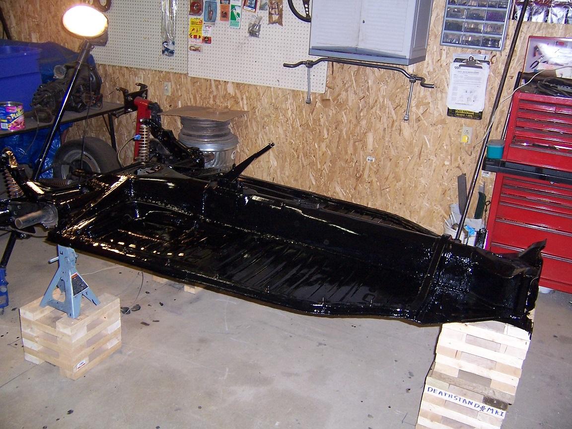

BIGMIKEY is offline
PostPosted: Fri Dec 08, 2023 11:50 am    Post subject: Re: Deserter Series 1 build Reply with quote
I added 1.25" square tubing to the pan rails to stiffen up the chassis. I welded in short lengths of round tubing to recess the bolt ends so they don't show under the frame.
Paint for the pan is Black paint from Tractor Supply. A little more glossy that I realized it would be. I used a brush but the paint leveled out nicely. It dried rock hard.
For the inside I used the Internal frame coat from Eastwood. Covers pretty well.
That finishes most of the heavy lifting for the chassis. Next will be suspension, brakes etc.

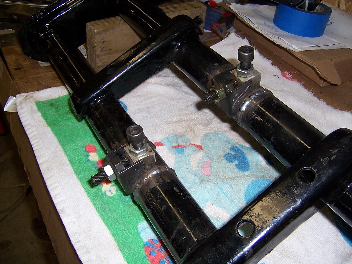

PostPosted: Wed Dec 13, 2023 12:44 pm    Post subject: Re: Deserter Series 1 build Reply with quote

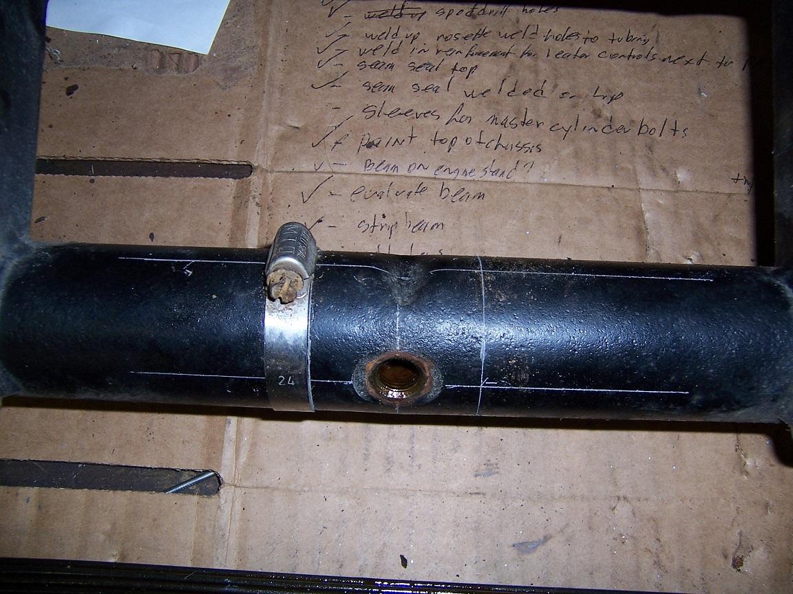

I wanted to be able to adjust my front ride height. A set of Sway-a-Way style adjusters were purchased and installed.
Following the instructions I scribed the cut lines using a hose clamp as a guide to ensure they were straight.
Used the same hose clamp to hold the adjuster in place for tack welding.
Finish welded adjusters. I had to crank my Lincoln 110 welder up all the way to get good penetration. I put a healthy bevel on the ends to make sure.
Pretty happy with how it turned out. This was my first time installing adjusters and the instructions were a bit hard to decipher.

GS guy
Joined: December 03, 2007
Posts: 988
Location: Maryland
GS guy is offline
PostPosted: Fri Dec 15, 2023 6:18 am    Post subject: Re: Deserter Series 1 build Reply with quote
Looking good! Based on the the new "bottom" position of the torsion anchor bolt you're going to a raised over stock ride height adjustment range? Keep up the nice work!

PostPosted: Fri Dec 15, 2023 8:21 pm    Post subject: Re: Deserter Series 1 build Reply with quote
Jeff
Wow. I hope not. I followed the instruction measurements to put the adjusters in the neutral position to adjust down or up equally. I guess I could have screwed up. The instructions were worded oddly.
The work I have posted so far has been done slowly over the last 10 years. I have had the buggy mocked up numerous times fitting adjusting changing modifying etc. I reviewed my build notes and found where I had to screw in the adjuster screws several turns to ensure the 175/70-14 tires did not bottom on the fenders so I am pretty sure I got them right. Thanks for the comment and encouragement. Means a lot coming from you because of your awesome GS build.
I plan to test drive it sometime in late spring. I will do a final assembly mockup before blowing it apart to fix and paint the body, but while it's together I'm going to make it run stop and turn and do a test drive. And final set the ride height.

BIGMIKEY is offline
PostPosted: Fri Dec 15, 2023 8:40 pm    Post subject: Re: Deserter Series 1 build Reply with quote

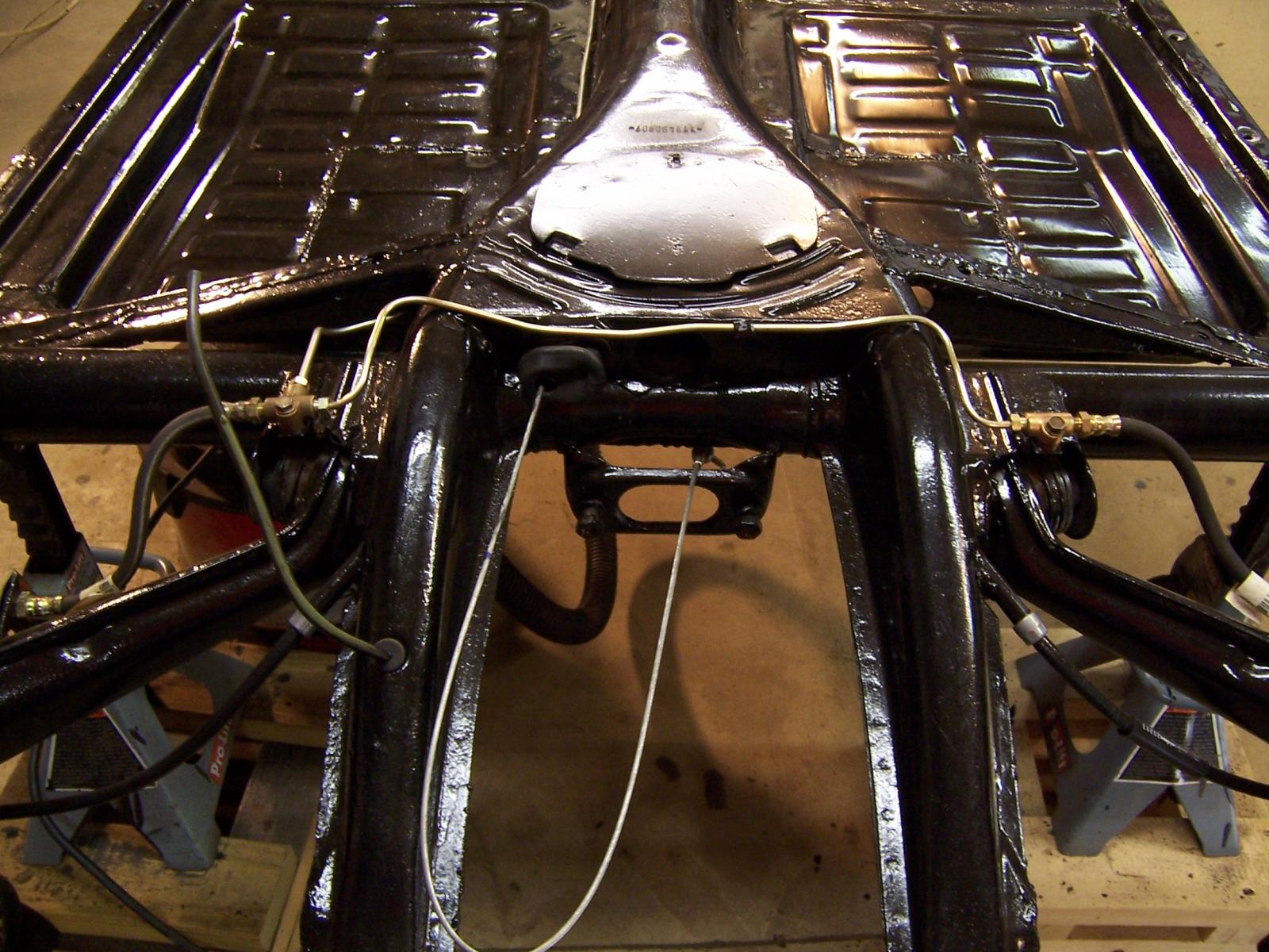

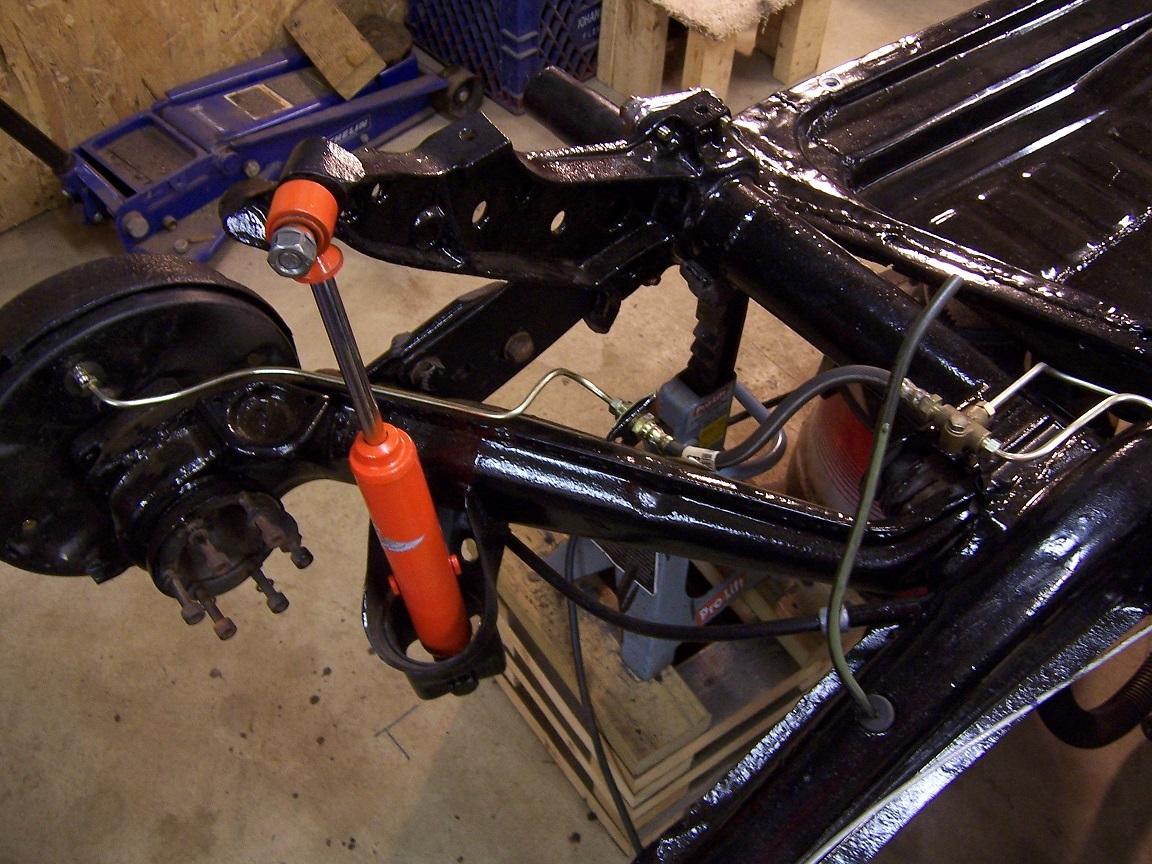

Here is the finished chassis with new brake lines, rubber lines, urethane spring plate and semi trailing arm bushings.
New fuel line, clutch and parking brake cables.
Brake master cylinder, Volvo reserviour. new ball joints tie rod ends. Also a set of caster shims.
The shocks are those phony coilovers that seem to be so popular. I removed the springs and perches and gave them a coat of Chevy Orange engine paint. Instant FONI shocks.

NJ John
Joined: September 21, 2007
Posts: 2908
Location: HdG, MD & NJ
NJ John is offline
PostPosted: Sat Dec 16, 2023 9:52 am    Post subject: Re: Deserter Series 1 build Reply with quote
Looking awesome.
Back to the adjusters. I guess the beam assembled without any binding. Hopefully the adjusters are in sync. It’s easy to get confused with them.
