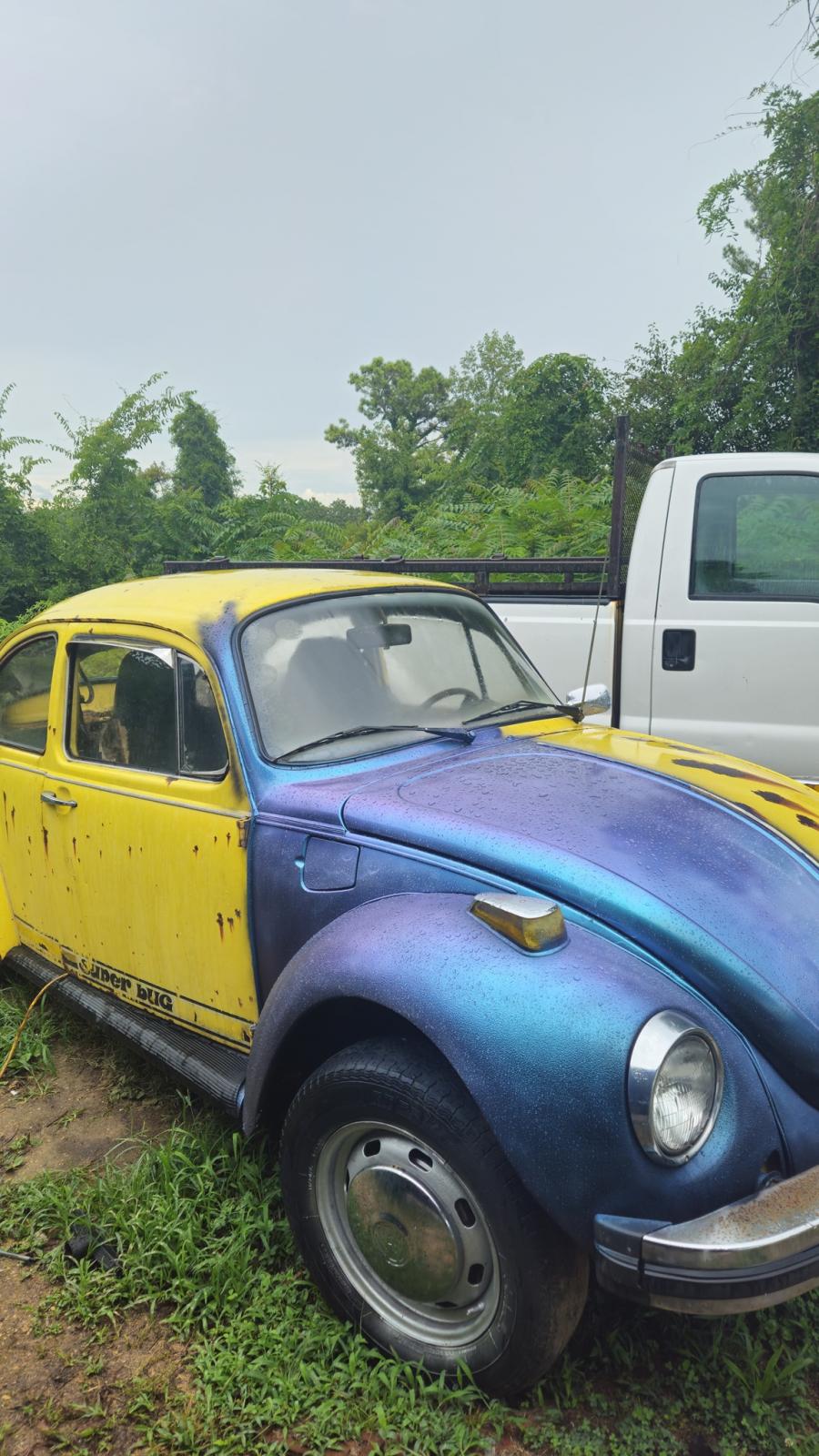

Coming along a little more =) look any better? Sanding sections before finishing with color shifting rustoleum paint. wasnt worried about the overspray on the tires as they will first thing to be changed once it is up and running again anyways. REALLY wouldnt mind replacing the seats at some point either if anyone has extras to sell. Wink
Busstom
Joined: November 23, 2014
Posts: 4579
Location: San Jose, CA
Busstom is offline
PostPosted: Thu Jul 25, 2024 5:45 pm    Post subject: Re: Bringing a neglected 1974 Superbeetle with A/C back to life Reply with quote
It's already looking better with that blue paint! I like that.

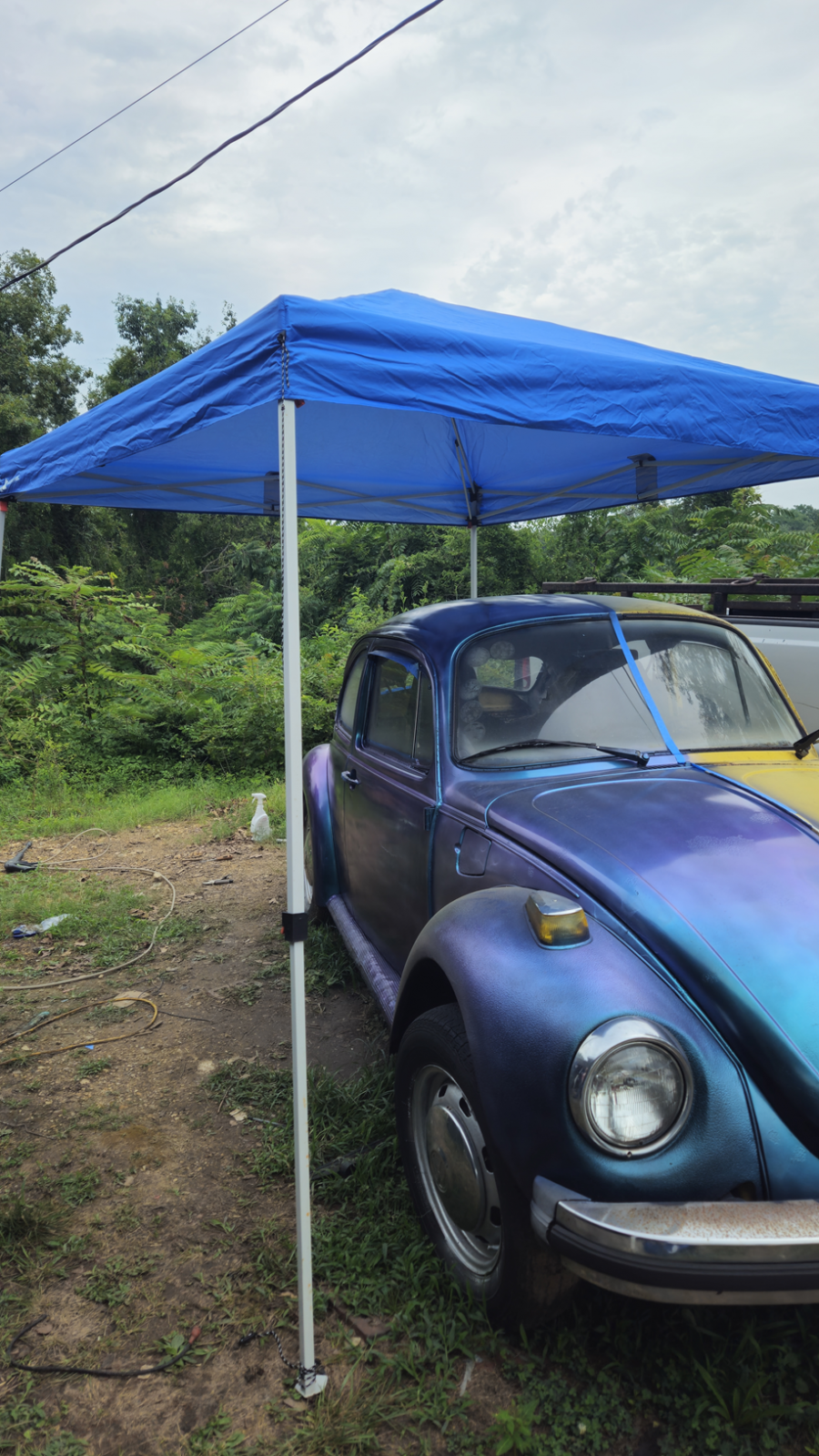

Todays fun. =) First sanding and 2 coats of flat black primer rustoleum then color shift paint started. New pea shooters ordered and on their way, new blinker lights and taillights as well next. Will wet sand all runs out before clear coat finishing.
