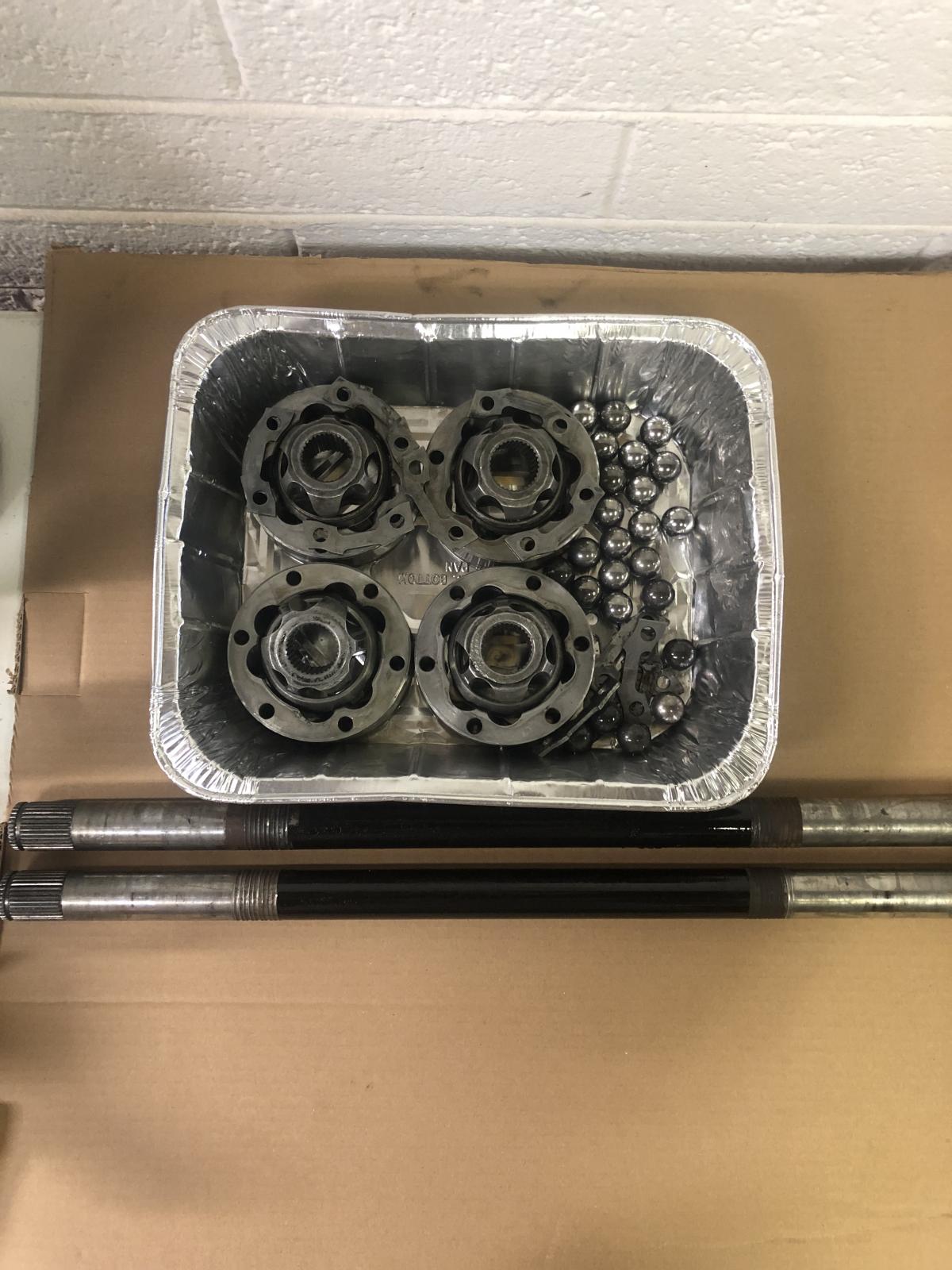

I was able to do an axle shaft rebuild. Two of the boots were in bad shape. This is pretty straight forward job. Clocking them is the only real thing I had to be sure I did right.
