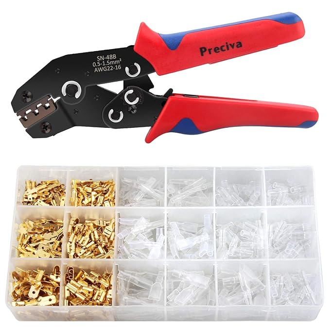

Do you already have a good ratcheting non-insulated terminal crimper and stock type non-insulated terminals? Like this:
The above set included non-locking terminals. You will need a mix of locking and non-locking terminals to re-create the steering column wiring and the relay bridge wiring. Note in the pic there are different width terminals. You will need the smaller ones if you are connecting wires to the pins under your steering column.

Also I am currently doing the same process with my '72. I dont recommend those terminal kits, the brass is thin and low quality. Instead I recommend buying a quality crimp tool ($40), and then buying the correct spade connectors from digikey, who will sell you the exact amount in any size you request. Navigating their site does take a bit of practice, but you can choose terminal size, thickness, material, locking/non locking, etc
