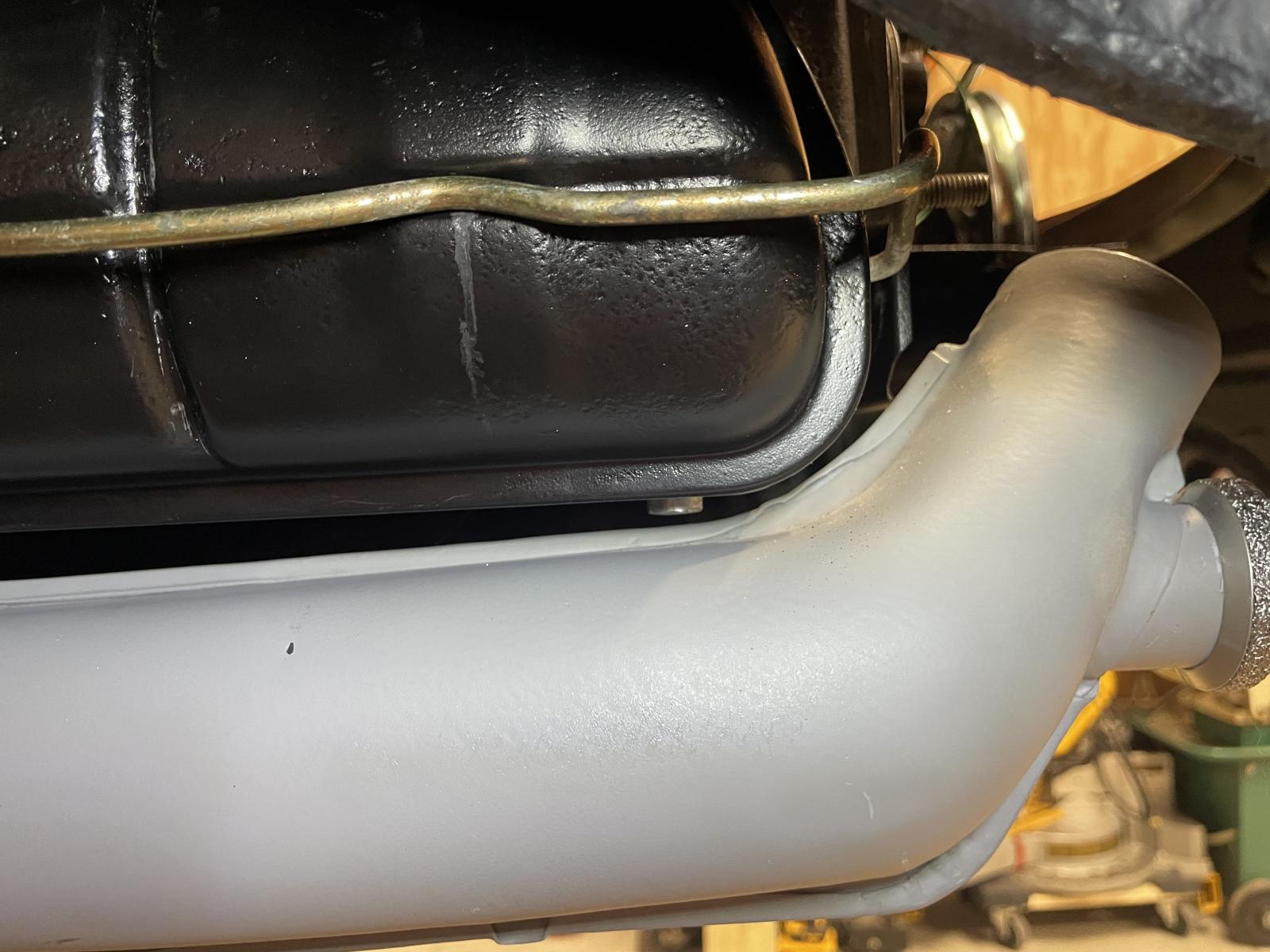

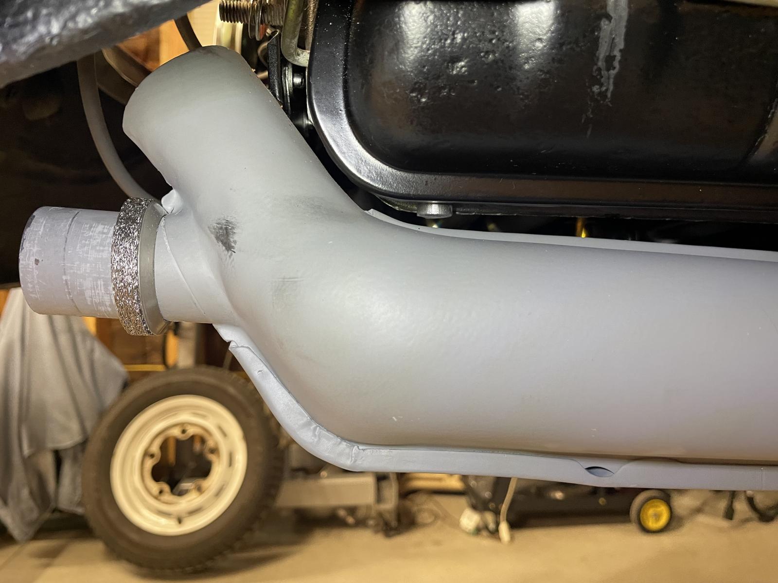

Brand New heater boxes and hardware kits.
Installed while still on the stand.
All set to install my Vintage Speed Muffler and what do you know.
No way are these bent correctly.
The J tubes are bent considerably (7-10 degrees) beyond 180.
Tailpipes dont clear the apron cut outs with this kind of angle.
It amplifies and becomes almost 3/4" by the time you get to the apron.
Never blame lazy people, they didn't do anything.

That is disappointing. Should be level under the valve cover. While I did have to cut about 13mm off of the length of tip of exchanger to fit vintage speed exhaust, that doesn't seem to help you in this problem.
My heat exchangers were an older aftermarket Dansk version ( I think) but the fit was factory like.
Mention the brand name if you would so others would know, unless you can get vendor to offer a correction.
Example of my 1835 vintage speed exhaust fit

I’ve personally bought one new jopex/dansk muffler from bus depot ten years ago and the experience installing it was not good. Jbugs guy’s theory is correct, leaving things loose then tightening it all up; but if you do that with as bad of an angle as yours, it puts a lot of pressure on those exhaust studs!
I guess you could heat the 90° bend up pretty hot and see if it would carefully bend to line up better. It would flatten the bend out some but shouldn’t be a big deal.

Map gas @ the bend and gracefully pull down till its straight. I could of fixed both in less time then you spent complaining. Everything needs extra tweaking. Its what we have, work with it. Are you a builder or a dealer R&R machinic. They were 150$ Cheap parts need to be fitted its the same with all classic cars. I'm thankful we can even get the parts at all. Imagine the bitching if they weren't even offered. You will be begging for those 150$ heater boxes that just need a fitment work.
Key is to have downward travel Preload keep both wheels on the ground at all times once you lift a tire your DONE. Guys worry about clearance instead think of the opposite you want the suspension to drop that tire in the hole and keep you going. A spider for example they keep their body low but their legs can reach pretty far so they don't (bottom out)

On mufflers for type 4 cars....Dansk has sucked in one or more ways most of my life. Either flanges not flat and parallel or spacing on pipes sucked or tailpipe don't fit.
For the most part, it has not been bad material or poor cutting etc.....its been shitty welding. The welding has not been weak, it's been oversized and sloppy closing up ports and obviously overheated on certain parts causing warpage to what is essentially a box of sheet metal and tubes welded together.
I think it's likely the mandrel bends on the head side suffered similar fate on the heaters boxes the OP bought.
I would start like this.
1. Take a gasket and match it up to your head outlet port on both studs. Make sure the port between the two studs is centered with the gasket.
Note: also if these are not actual original factory heads from VW....do not assume that the ports and studs are in 100% the exact place they should be. On not only aftermarket but some Brazilian cast VW heads, there are all kinds of mold "core shift" issues over the decades that can put an exhaust or intake port a millimeter or so out of place or even just out of plane.
2. After trying out the gasket on the studs and verifying the port is centralized with the gasket.....take the same gasket and try it onto the heater box flange that is going to bolt to the head port you just checked.
Is the exhaust port in the gasket in the exact place with the port in the heater box? Are the two studs holes in the gasket correct with the stud holes on the heater box flange?
Both have to be correct. If the port on the gasket matches up with the port on the head and also matches up to the port on the heater box.....but the two studs holes do not match up with the heater box....well.....then there is a chunk of your problem.
A simple solution might be to weld up and redrill them or pick the one that does you the most good to leave alone....and oval the other one out.
If none of those items turns out to be the issue....its a heat the tube and bend it kind of solution.
If these are anything like the problems I have had with Dansk over the years......sending them back will probably get you another pair just like them.
I would bet that it's caused by a combination of a jig that is not perfect and grossly overheating the whole pile of parts during welding. They will likely all be the same.
Don't let me throw too much shade on Dansk. Overall, good quality parts...just some rough construction at times.
Even dating back to 1979, I have never had a Dansk muffler that did not require at least a little bit of filing, grinding or a few taps with a hammer. Ray
