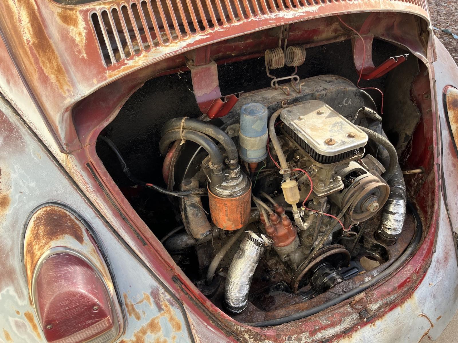

This is the 2nd 1969 bug that was posted today with a Weber carb conversion. Kind of odd since they are not as common on the upright type1 motors as they are on the late bus type 4 motors. For what you want to do with it I would get everything cleaned up real good, get it running before you pull the engine for the clutch so you know what you have. I hope it turns out to be as much fun for you as the beautiful plane you showed . Good luck Bob

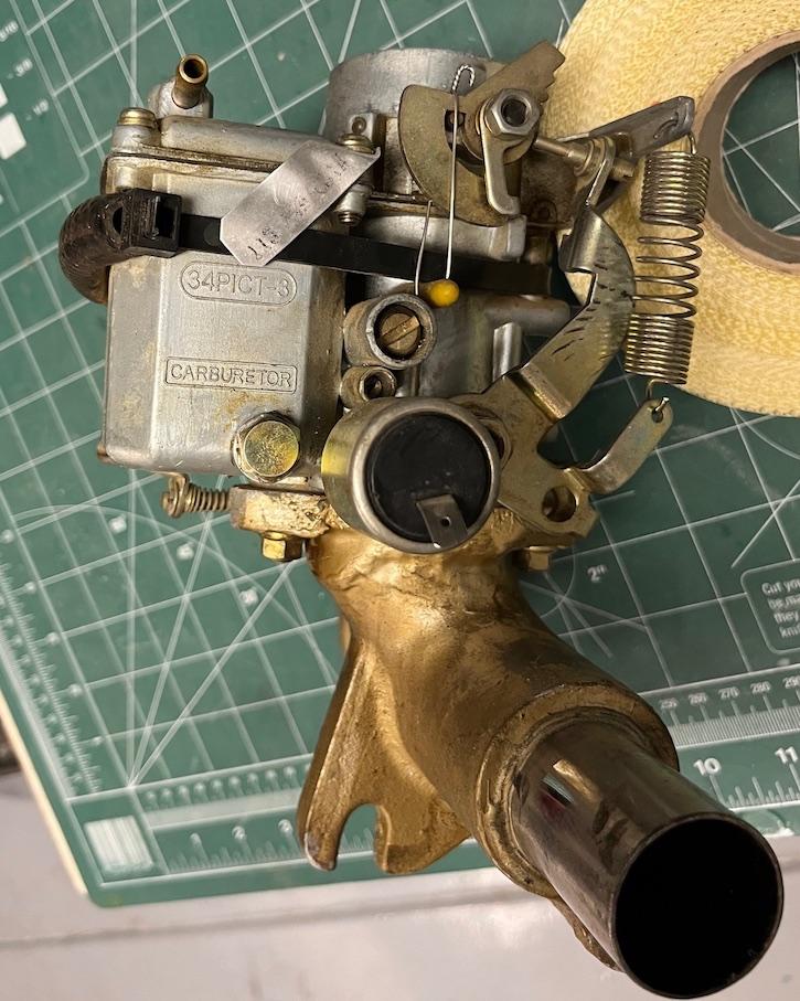

I'm NOT a car guy and new to VW's so please bare with me. Someone pointed out the carb is a Weber. I noticed its a 'two barrel'. A buddy took the pictured one off an airplane and gave it to me. He said he thought it was a fresh overhaul. Is it the correct one for this engine? If not, what is? If it is, it looks like I may need to find an intake manifold. I'll rebuild it of course. Can anyone tell me about the engine SN? Did VW actually sell re-manufactured ones? The best I can find is its period correct and probably 1500. Any thoughts? The VIN ends with 9485. Is it just coincidence the engine number is that close?

The engine is about ready to come out. I've pulled about 8 gallons of rat dung and nuts out of the engine bay so far. It was suggested I try to run it before removing it. With sitting for 30 years and the wiring all chewed up, I thought it was best just to take it out. I also think the shroud is full of poop and nuts. It has some funky oil cooler behind the fan shroud and that remote filter.
There was a NOS VW pump with the spare parts. I think I saw someone say they are re-buildable. I would like to get a known carb, new pump, rotor, points, wires, etc. I'll run it on the stand before it goes back in the car. It appears to have 109,000 before it was parked. I don't know where in the 25 years it drove the motor was replaced but the previous owner didn't think it had that many miles after the motor job. He is a good friend and he gave it to me for free ninety free so no reason to exaggerate. It does turn over easily by hand.

The carb on the car is a Weber probably a 32 36 progressive. The 34 pict- 3 you just showed would be the original equipment carb for a 71 thru 74 US market federal emissions for a factory dual port motor. In the initial photos you took I cannot see because of leaves on the sides of the engine bay whether your manifold is single or dual port. The pict-3 fits directly on the dual port manifold with the removable ends. The pict-3 will not fit the manifold that the Weber is sitting on. The 69 probably had a 30 Pict-2 originally. Hope this helps- Bob

I would like to get a known carb, new pump, rotor, points, wires, etc. I'll run it on the stand before it goes back in the car. It appears to have 109,000 before it was parked. I don't know where in the 25 years it drove the motor was replaced but the previous owner didn't think it had that many miles after the motor job. It does turn over easily by hand.
Just for future reference ...
For distributors and Pierburg fuel pumps, Bill is the guy to contact:
https://www.sparxwerks.com
For a quality rebuilt stock carb, Tim is your guy:
https://www.volkzbitz.com/home.html
Turns over easily by hand? If super easy, then maybe weak compression or worse, no spark plugs ... pray for the former if it's been sitting around like this for years. Wink
More likely a Weber clone than a genuine Weber.

I only turned it back and forth 10 degrees or so. I won't turn it more until I get the valve covers off and the fan cleared out. Is that Weber worth keeping? I kind of want it stock. Its single port heads. I did shoot an email to Tim. Thanks for the tip but he may be out of my price range for now Smile Anyone want to trade stock stuff for the Weber and 34?
My friend said it was running great when he parked it. The clutch went out and he nursed it home.
Any help on engine numbers?

If it is a real Weber(made in Spain or Italy) it will say Weber and the country on it. If it's real you could probably place it in the classifieds with the manifold and someone may be willing to trade stock parts for a 69 bug for it.

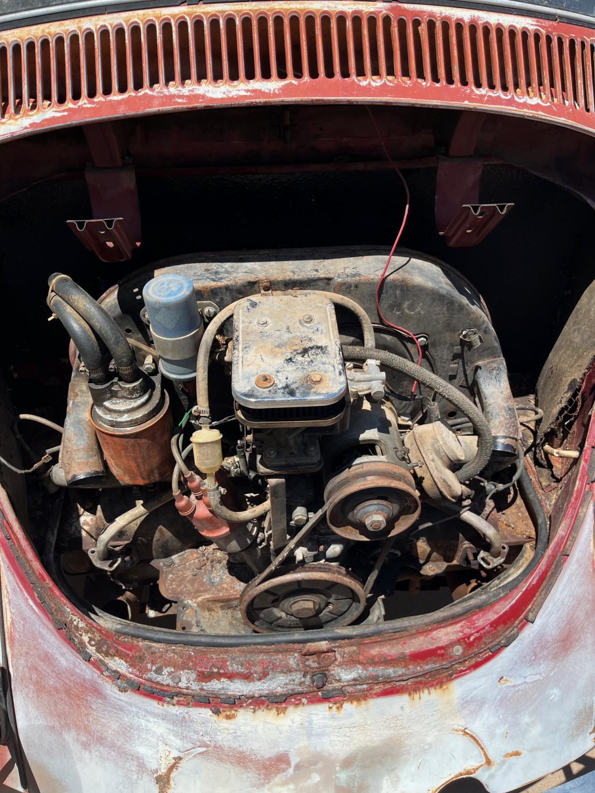

Looks like a dual port based on the manifold boot visible under the oil filter. Likely a 1600 now.

This is the best photo I have right now. The car is at a friends house or I would go take another one. Its a single port. Both of my airplanes are dual. I'm a bit disappointed at the mods and am really looking forward to a better look once its out. Again, I want is as stock as practical.
The tin is out. All the bolts/nuts are off and everything is disconnected. Is all loose now and tomorrow we are attempting to drop it.

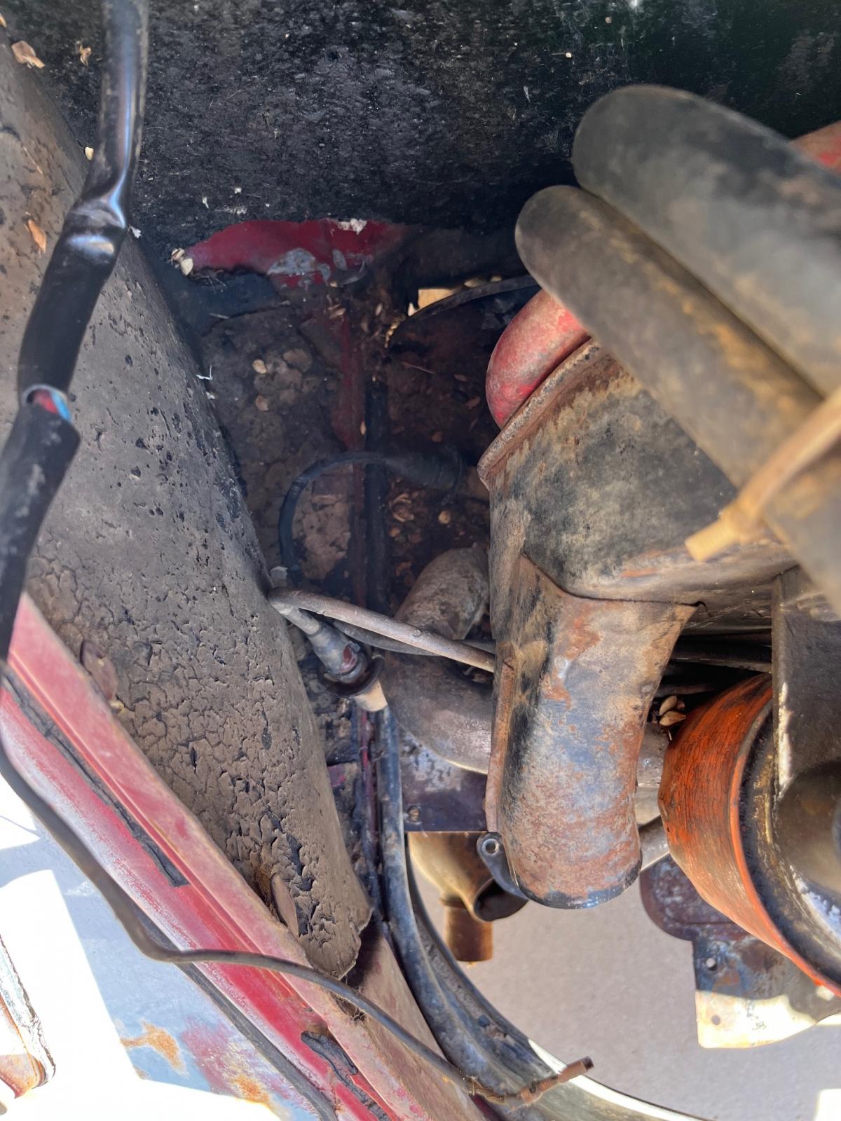

Here are a few photos I just took. I'm a bit concerned about the tin by the heads allowing it to move aft to clear the drive shaft. Do they need to come out too?
We have 3 floor jacks, 4 jack stands, and a transmission/ATV jack.
