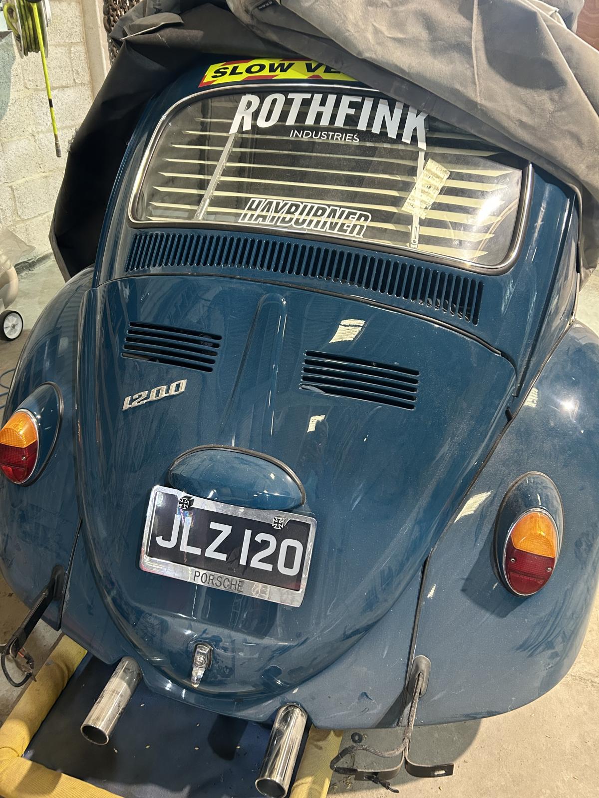

Hi Gentleman
Well after the so far very successful 1800cc Build, and ready to build a 2007cc
I have a small change in plans. Rolling Eyes
I decided today to put the 2007 on the back burner for a while, and really want to get my Bug back on the road. The poor little thing has sat under cover for the best part of 2 and a half years Crying or Very sad
It is the very reason I decided to build an engine in the first place, as I had paid a lot of money to have this built for me, and only got about 200 miles on it before a knocking sound started Rolling Eyes around that time I had the Bus anyway, and the poor old Bug sorta just got forgotten. Crying or Very sad
Anyway. Back story is that I have no build sheet, only what the builder told me in 2019. Covid then hit and when we eventually tried to install the engine, the Builder had passed over Crying or Very sad
This is what I'm working with Built Dec 1965, so a UK supplied 66MY.
New VW AS 41 case
Bergman 69mm c/w VW crank kit
VW 311 rods
Engle 110 cam kit
Barrel/Piston kit 90.5/1776cc MAHLE
Mofoco 042 heads 40x35.5
Full flowed Schadek 26mm oil pump kit
Dual Dellorto 40 mm carbs with CB manifolds and Vintage speed linkage
Vintage speed big exhaust
Bergmann Porsche fan kit
No Heat
As I said, I uncovered her today, and have removed rear brake and fog lights, and have removed the bumper. I will post some photos of her today, but Ideally looking for advice on a complete rebuild ?
I'm a lot more confident about engines than I was then, and very pleased that I'm at the point where I think I can pull this engine and re-build it myself.
PS: in my stash, I have a new CBP 74mm Crank, and a new set of stroker clearanced 5.4" rods. Laughing I'm hoping to re-use the (90.5mm) B&P's, and the Mofoco heads. but not sure whether the W110 is the right choice ? I never wanted a 'screamer' but somthing that will cruise at 60mph, room to accelerate and pass lorries, 5500 rev limit ? Still has the OG Gearbox which was clearanced for 200mm flywheel. I would really like to have this old girl ready to run for next year.
As always, your thoughts are more than welcome

Does it still turn, and it just knocks, or is it locked up?
I would tear it apart and see if the crank survived. If not, use the 74mm. Figure out what the knock actually is.
It might be a bad cam gear sounding like a knock.
The cam and heads aren’t ideal, but they will work with a little touch up on the heads. They are also paid for at this point
I think you are plenty capable to knock this one out now. Tear it down, investigate as you go, find the problem, then start from scratch with all these parts on the bench. Build it just like you did the 1800cc. Don’t skip any steps, measure everything.

Thanks Brian
No, engine turns over fine, I have no idea where the knocking is coming from, and as you say, will have to strip it right down and and check everything, was hoping to keep the $$$$ spend to a minimum on this one, and as I said, has approx 230 miles on the clock from new, so praying not too much damage, if any ?
Good news is that I have a removable rear apron, so once I get her in the air I can get the rear wheels off, and remove the fenders and the apron, and get the engine straight on the stand.
One of the things I will be asking along the way is about cooling though, as not too clued up on the Bergmann shrouds. Hindsight is a wonderful thing, and in retrospect I wish I had gone for a straightforward Type 1 shroud with all the correct OG tins, but back then I was blinded by the bling and did not understand the science. I could of course still go back to type 1, but still like the 'look' I just want to do right for the engine/car if that makes sense ?
I will be spending on a new Thermostatically controlled Filter head, something like the Improved Racing one I have on the Bus, or a Mocal unit, and will be also looking at the Empi cooler and fan on there, as on the Bus I have the Setrab/Spal kit, and they seem to be quality.
I'm hoping the Crank is OK but as you say, I have a new CB 74 to fall back on. If it's the cam gear, I have a new one, along with a new W100 cam and new Engle 6001P lifters, but would probably want a suggestion of something more suitable for the Bug ?

Did you have those vents put in the engine lid? My 65 didn't have those though it was still a 1200.

Hi @Zed999
No, The decklid I bought, it was from a 64 Vert I believe. I bought this and also stand offs as even from day one I had trouble with it spitting and farting ? and wondered if it needed more air ? Don't think those dells were ever set up fully correct ?

“Knocking” can be a lot of things.
Are you -sure- it’s an internal noise?
Mayne try starting it up without the fan belt on, see if it’s related to the fan?
Also,
Is it 1/2 crank speed?
Some valvetrain failures can be fixed with the engine in place.
Hope springs eternal.
Sucks to pull an engine apart and find nothing amiss.
BTDT.

Hi @Clatter
That's strange you said that, as about a year or so ago a friend of mine said are you sure it's internal ? To me it definitely sounds internal, but I'll be back there at the workshop tomorrow, and for giggles will probably try and start it without the belt, although I may have problems getting it to run as it's been standing for quite a while.

Cover is off. And pulled her out of the grain store today, Engine is coming out tomorrow with luck. Very Happy
Actually really looking forward to getting her back on the road, and I think she's a pretty little Bug.
The big decision is whether to go back to stock tin-ware, Doghouse cooler etc, or stick with the Bergmann Question Wink
Oh well, we'll see what the 'knocking' problem is first

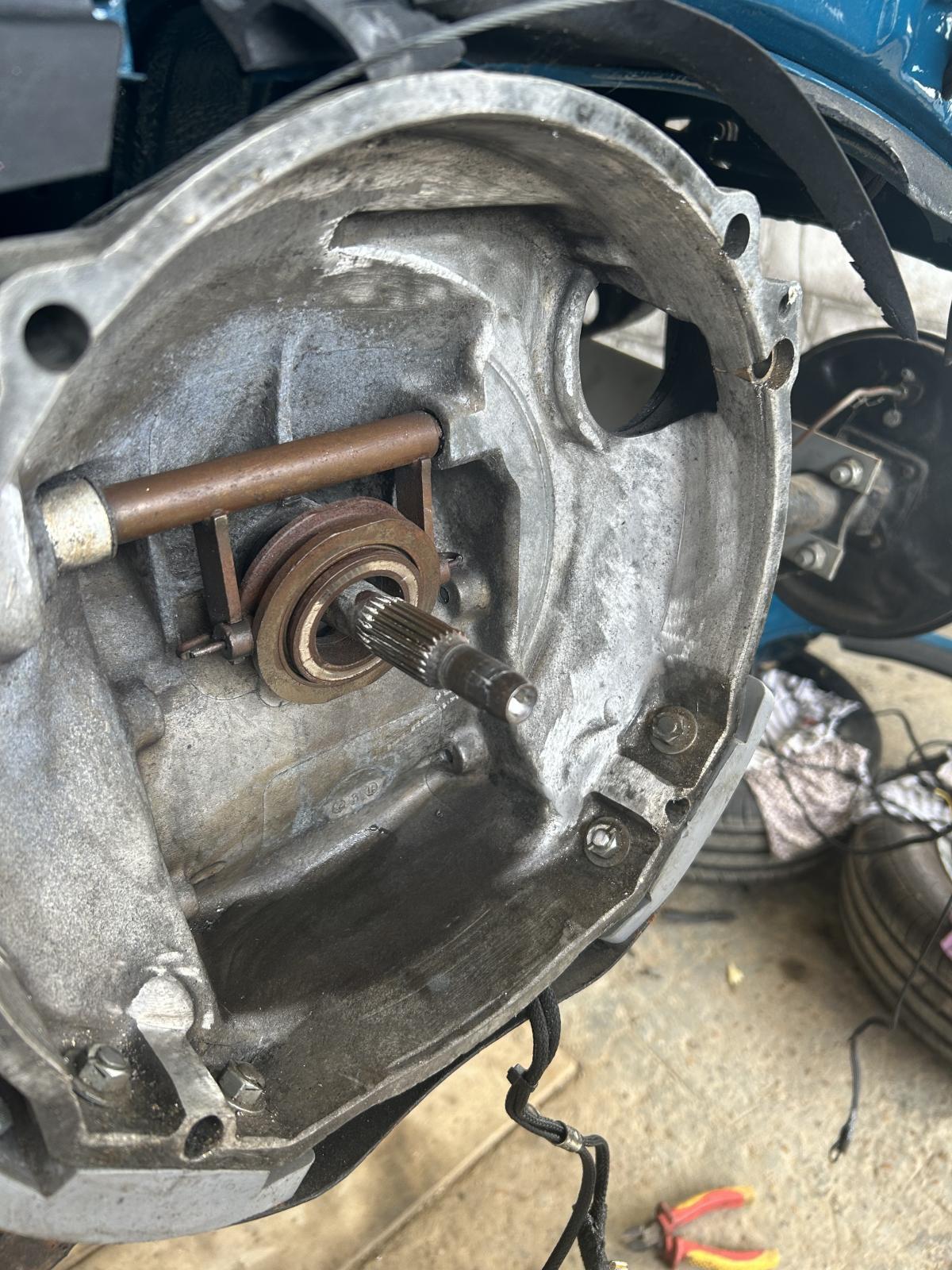

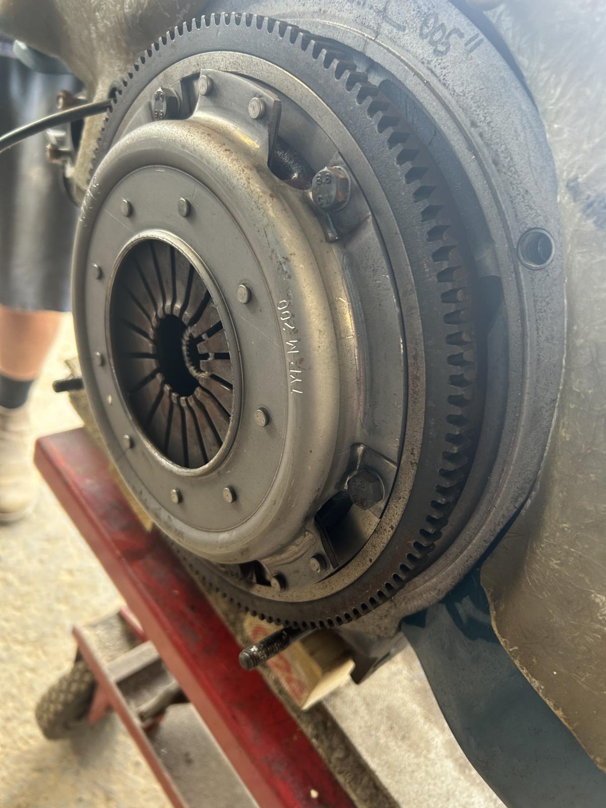

Had a good day today and the engine is out. Prior to the start of the knock starting, I had a horrible squeal from the clutch as well.
This is what it looked like as we pulled the engine. The Throw out bearing moves all over the place ? Something is not right

Ring on pressure plate is missing.
That would make some noise.
I did that once 45 years ago. Ha!
My 68 bus made it to alberquerqe, NM. Before clutch to bearing kicked sideways and came loose.
Drove all the way to Santa Maria, CA with no clutch. Trashed synchro in that box.
What a story that was! And I was flat towing a 63 vert to sell at orange county swap meet.
Wonder what became of that vert? It was nice.
Fix the pressure plate.

So, I tried turning the engine over with the belt disconnected, Fan spun perfectly, but the noise was still there.
The throw out bearing was barely on, and there was a lot of movement on the shaft in all directions, so new throw out bearing and clips ordered, and a new PP.
I can't see how but would that possible be the 'Knocking' sound ??
Dropped the oil, and no word of a lie it was crystal clear and golden, could not find any contaminants, plus the filter was the same, although I didn't cut it open.
Anyway, going on the stand tomorrow, and will fit the Zalex starter ring, and spin it over again to isolate the clutch ?
Im sure you got the right parts, but I just have to ask, did you get an EARLY PP to match the EARLY TO bearing? what you have now is early TO bearing and late PP. They need to match or else you will continue to have problems regardless of if they are new or not.
drive your split.
