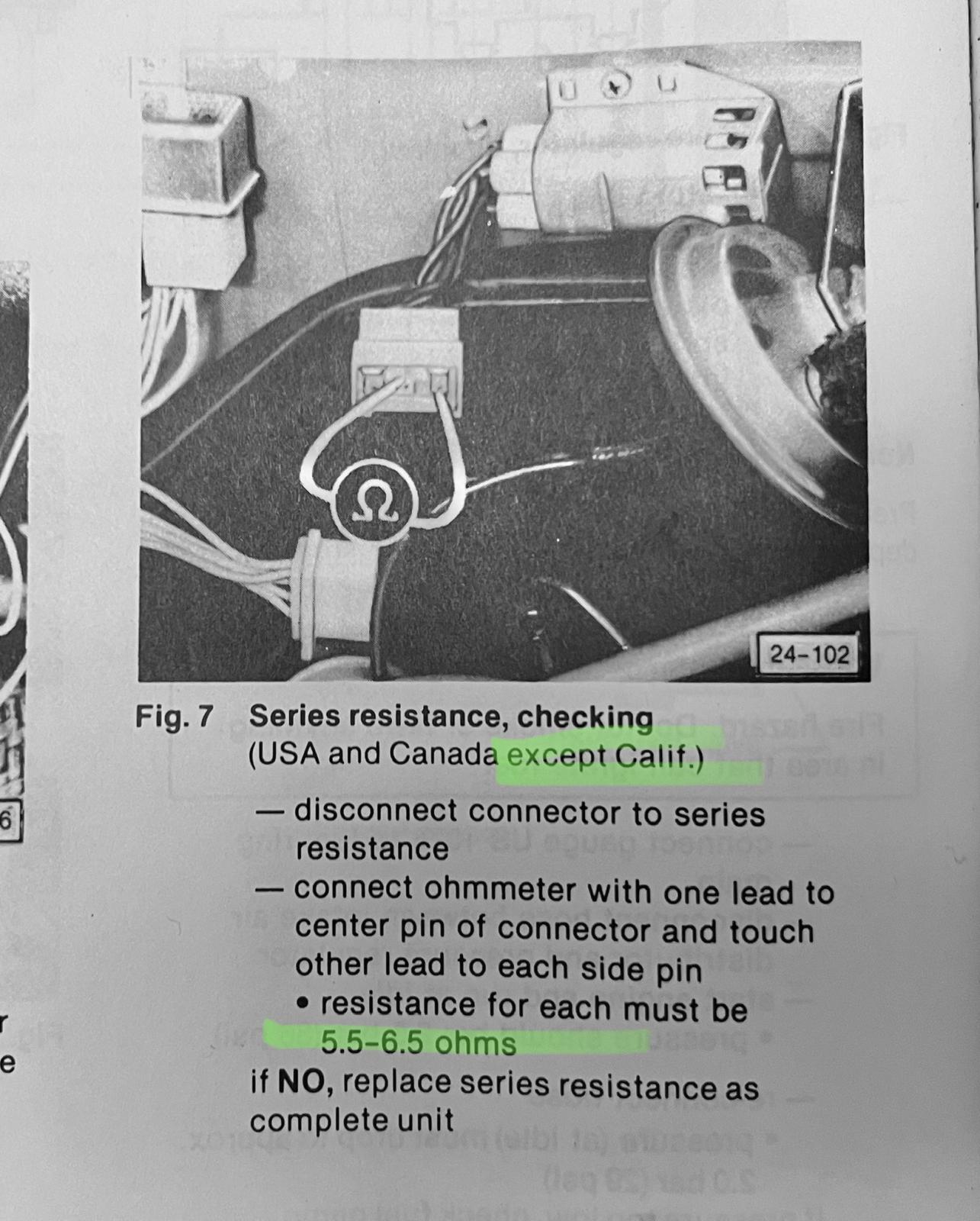

More information… the pictures are a little out of order…
I have measured Ohms on 8 of my spares of this part number above. 2.3 to 2.5 Ohms on average. Not done with the research yet…

You’d want to compare resistance of an individual injector. There are 2 types. Low resistance and high resistance. They are not interchangeable. Flow rates for most vanagon injectors are likely similar. You’d want sets of 4, don’t mix and match and you should be fine.

Yep, the California smog engines have all sorts of weird one off parts that are hard to find and only used on the Cali rigs as well as weird differences like missing the resistor pack. The Federal (standard) aircooled Vanagons are much closer to the Bay Window engine. I'm not certain what the injector differences are on the Cali variant as mine is federal but the Bentley should give you a part number for the Cali injectors if they're different.

I'm getting concerned about what I see regarding new fuel injectors for sale. The late Baywindow L-Jetronic system used a stand-alone voltage resistor pack for the fuel injectors.
The air-cooled Vanagon does not use that - I think the resistor is integral to the injector, or the controlling voltage is handled by the ECU.
Yet...
All of the new fuel injectors I see for sale show compatibility for all fuel injection years from 1975 into the late 1980's. So I am concerned that either I am ignorant to some information on how the injector voltage is handled, or the vendors are selling the wrong injectors.
Example: Standard Motor Products FJ634
Anyone have some solid input on this issue?
Please don't suggest I send out the injectors for servicing. That is not the point.
The aircooled Vanagon DOES use the external resistor pack unless its a California Smog model.
Yet...
