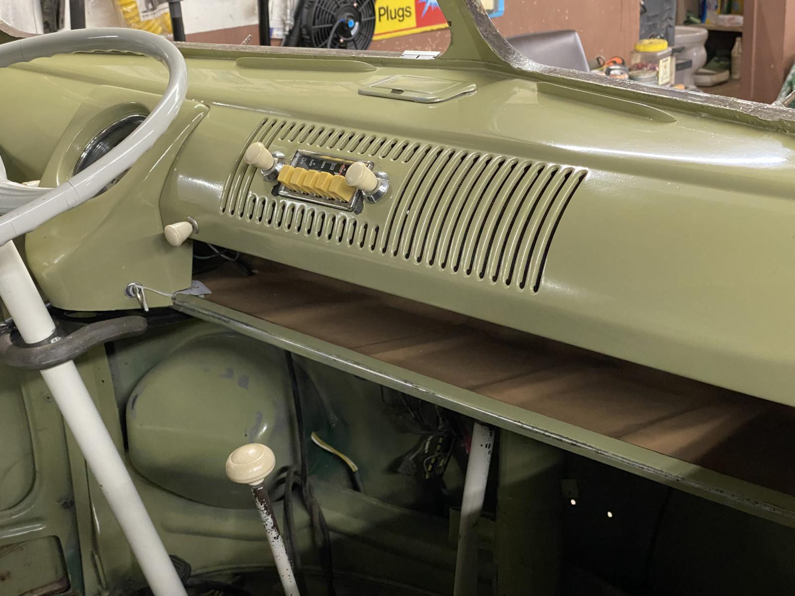

This is a great thread. Here’s my parcel tray after I recovered it…not perfect but I like it.

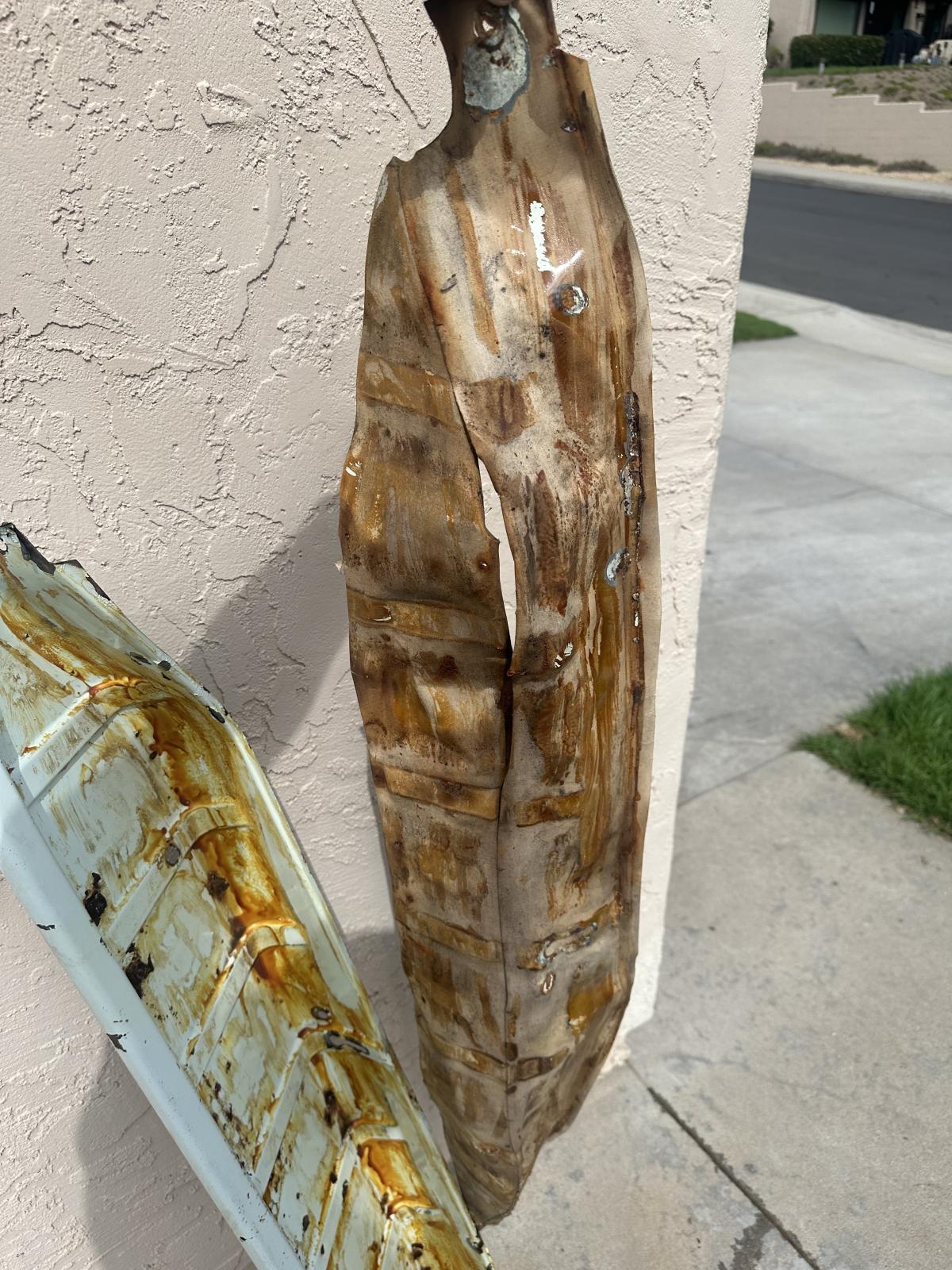

No stitching.
It's glued together along the whole length though, where it connects the bottom/storage area piece to the back piece.
I do have this tray here so I can take more pics if needed.

Here's a Como Green tray with the original covering
Does this have stitching like zimblewinders one?
shiny paint doesnt make it worth any more

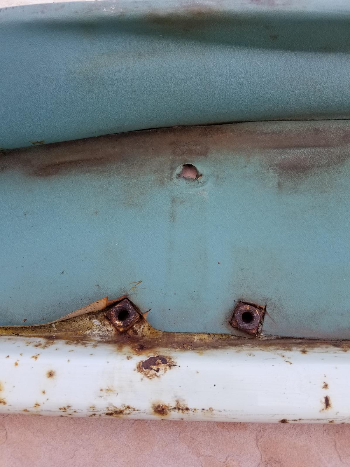

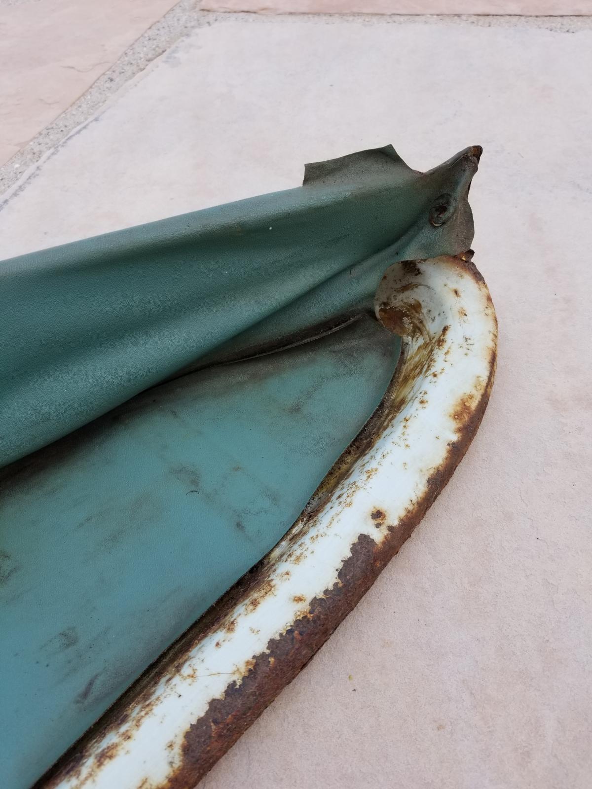

The ends of the front vertical piece are folded back too.

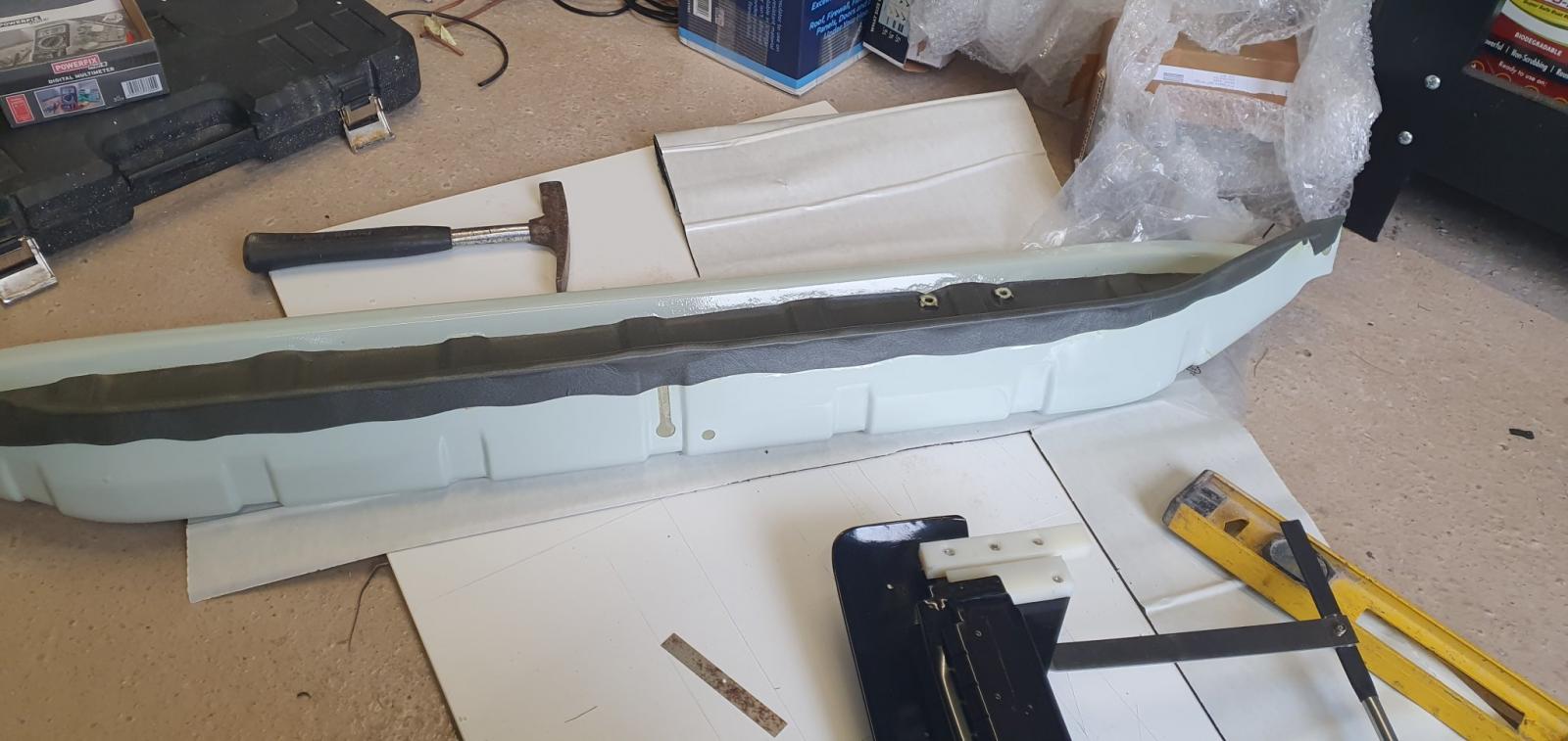

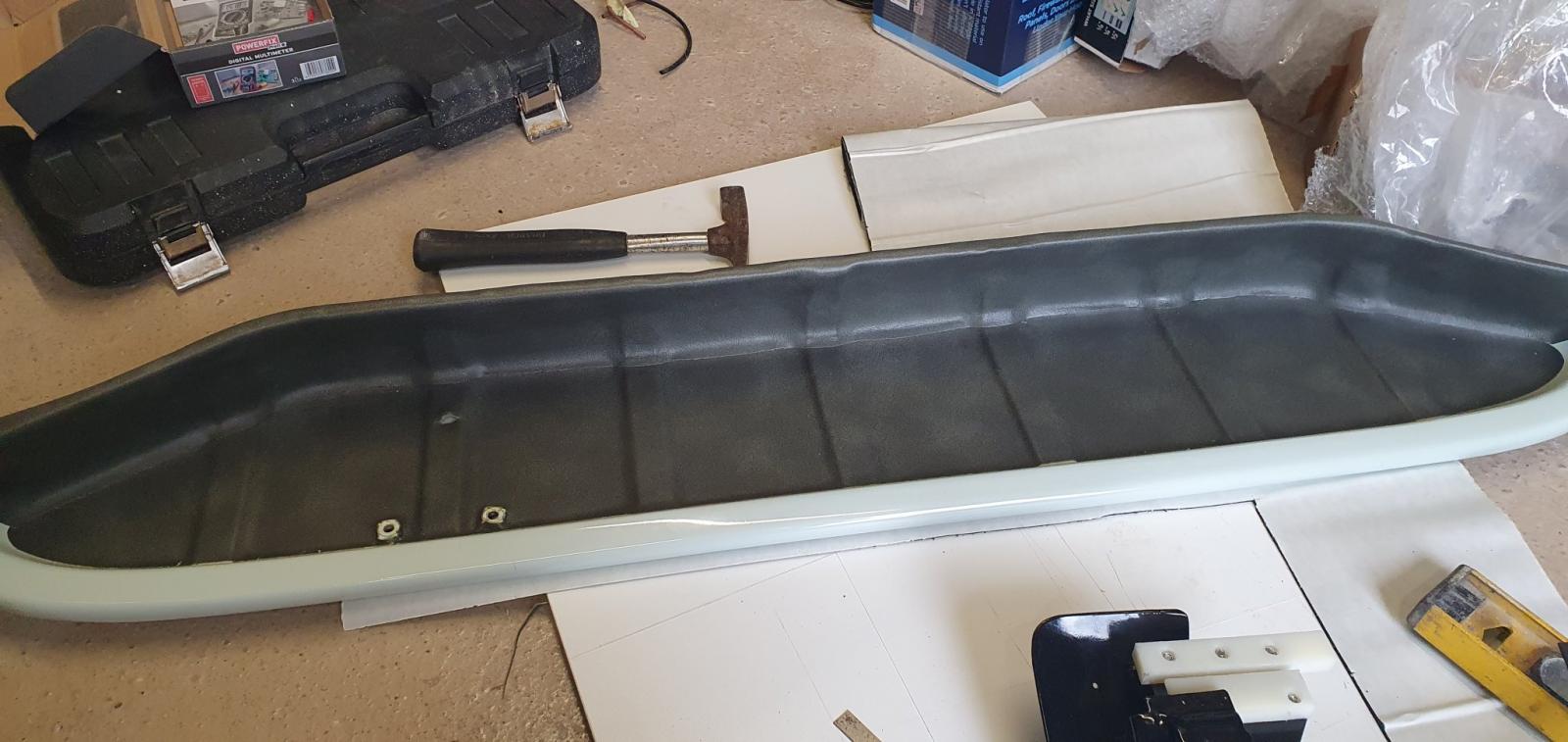

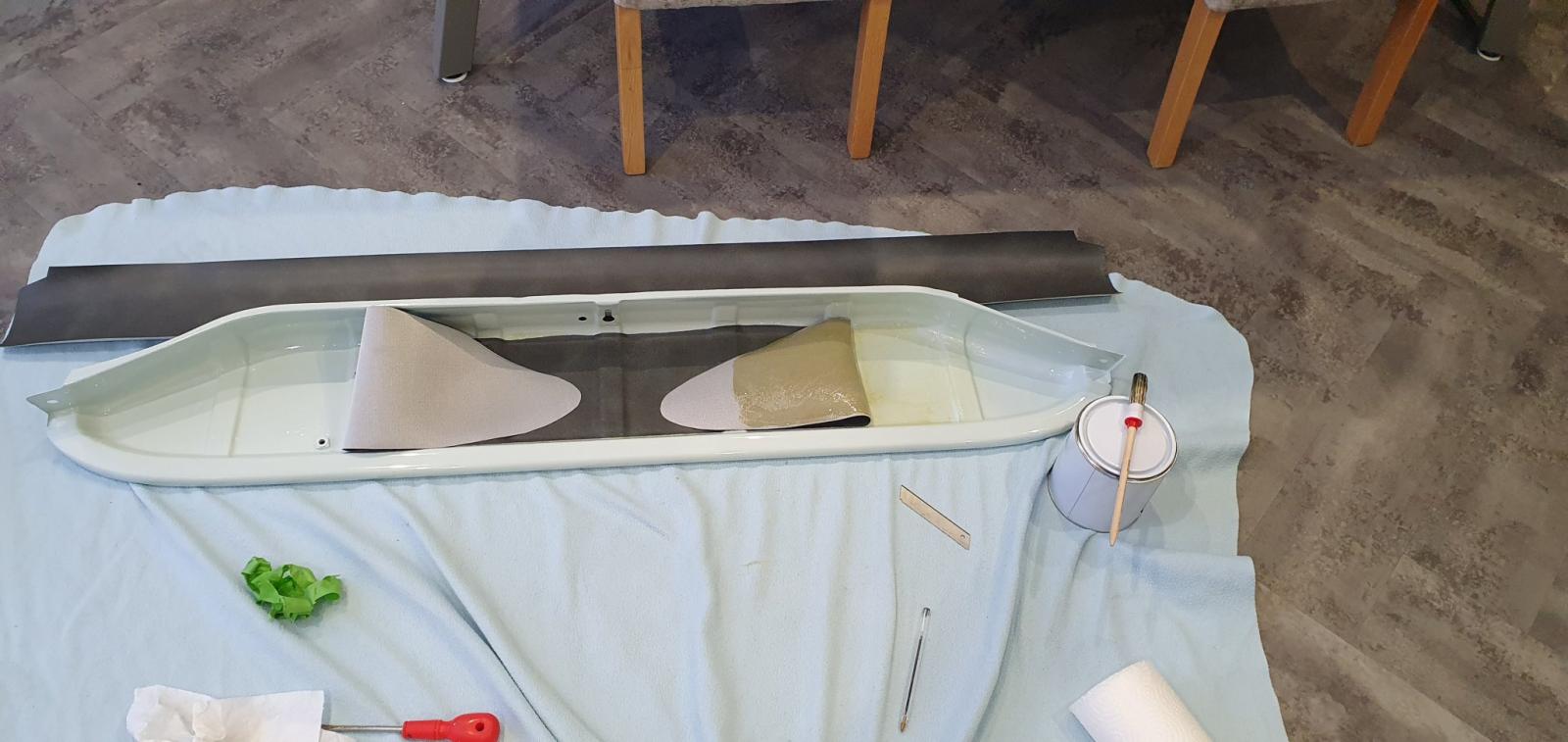

PostPosted: Sun Dec 03, 2023 9:03 pm    Post subject: Re: Parcel shelf / tray covering? Reply with quote
I tried to replicate the original the best I could and used contact adhesive in a can with a brush. I think a spray would have been much easier though.
As you can see from the original one above it was glued clear across. Over the years the vinyl shrinks and usually pulls the sharp bottom corners up only staying stuck to the flat top surface. I traced an original onto paper then the paper onto the fresh vinyl. A few adjustments still had to be made to fit properly. It depends on the heat of your vinyl, tray, glue, etc.
I did the front (back of the parcel tray) first and did the bottom the next day. The whole process took me weeks which is ludicrous since they probably did it start to finish in three minutes at the factory… Laughing

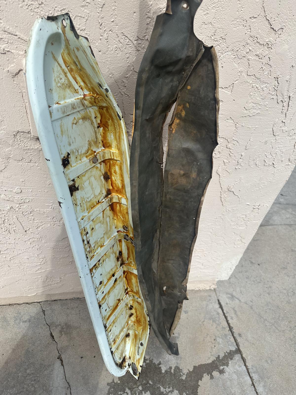

I haven’t yet. But will ask Sewfine, who’s making everything else to send me a yard or so. It should be the same material the door cards/panels are made from. So they’ll obviously have it in stock.

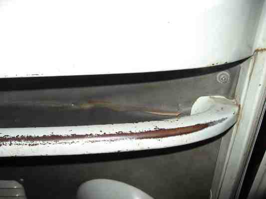

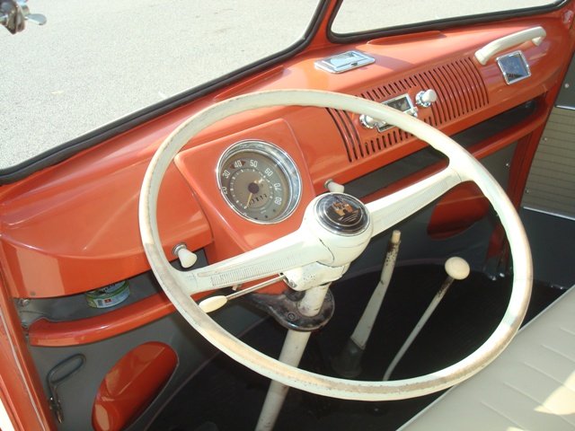

Here is the original liner on my under-dash tray...

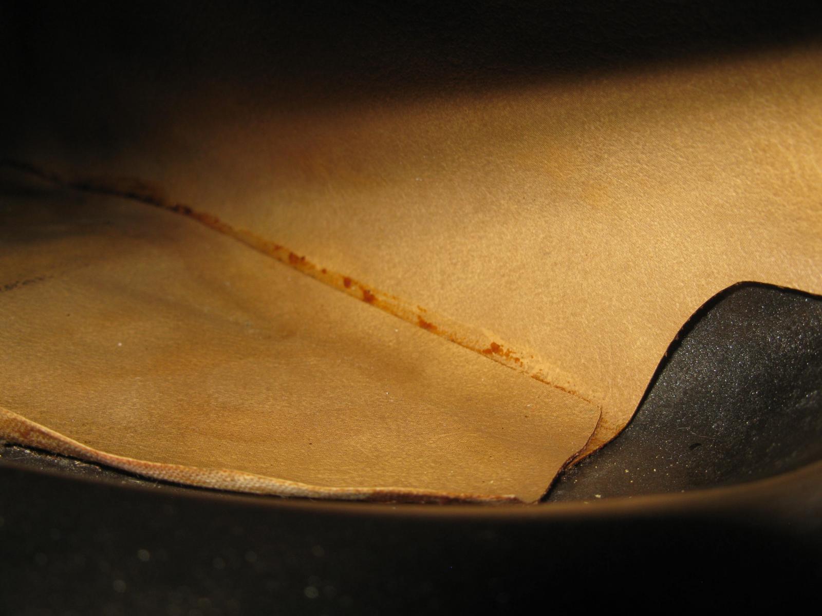

I have a mango (59-61) parcel tray with an original caramel brown liner. It's two pieces. I don't know what actual year the tray is from though.
