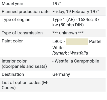

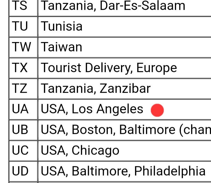

Anybody have an idea why my mcode plate shows delivery to UA, Los Angeles but mcode decoder shows destination as Germany?
Hi,
Wrong data input gives wrong results. I corrected your Mplate and here is the result Wink
David.
Yup, my mistake. Thanks for the correction.
Hi,
David.
Uncode your bus MPlate and MSticker

busdaddy wrote:
Then it's most likely an error on the decoders part, German buses had none of those things.
Makes sense.

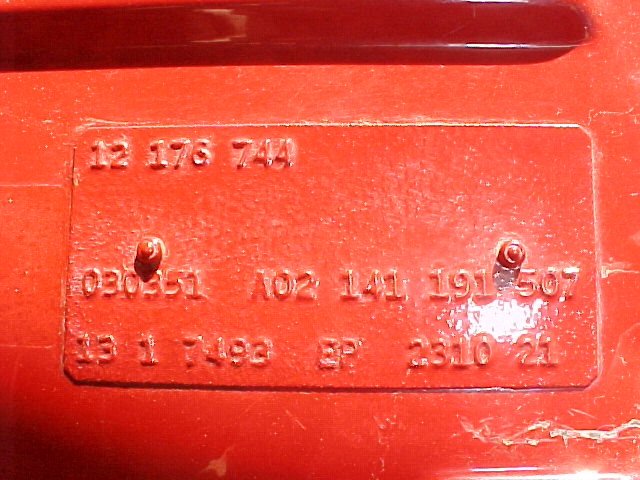

dwill49965 wrote:
calebmelvin wrote:
The plate under the dash reads:
82 034 999
733
J4R152 D50 227 246 732
40 3 7364 UN 2218 61
****** 1st line ******
(22) = Microbus
8: model year 1978
2: this is an extra number that was used to distinguish 1970ties and 1960ties chassis numbers. The '2' would turn
into a '3' as soon as 1 million vehicles of this model been produced. This never happened with the Transporter production.
034999: the serial number.
****** 2nd line ******
733 = not listed in book
****** 3rd line ******
J4R152 = paint- and interior code
J4 = L57H Reef Blue
R1 = L90D Pastel White
52 = Leatherette, alabaster (Grey)
D50 = Mcode: group code consisting of:
012 - exhaust emmission control installation and speedometer in miles instead of km
067 - 12V 54A battery instead of standard 12V 45A battery
102 - rear window heating
508 - one sliding window in sliding door and one in the opposite side panel of the pass compt.
227 = Mcode: Detachable headrests in cab
246 = Mcode: windscreen free from import duty for USA
732 = Mcode: - not listed in the book
****** 4th line ******
40 3 = this code is a date. This date is most likely a few days later than the actual production date.
Week 40, day 3 (=Wednesday), of production year 1977 means 5 Oct 1977
7364 = ?production planning number
UN = Vancouver, Wn, import destination = USA, New York
221 = Microbus, 7/8/9 Seater, LHD, Sliding door right
8 = 7 seater, seat arrangement 2-2-3
61 = 7 Seat microbus, Manual transmission, 70 hp
6=type 4 engine, 2.0 L, 1= 4 spd manual
Also lists mcode 157/251, 147 extras.
157 = fuel injection ('75-'79)
251 = type 4 engine
147 - seven seater model instead of 8 seater model
Any ideas what this means or what the mcodes are for these?
The 700 series codes are actually called "Special Body" codes (S-codes), for special built-ins or special labour that had to be done on the busses during production.
All information taken from "VW Transporter and Microbus Specification Guide 1967-1979" by Vincent Molenaar and Alexander Prinz, The Crowood Press Ltd, 2005.
