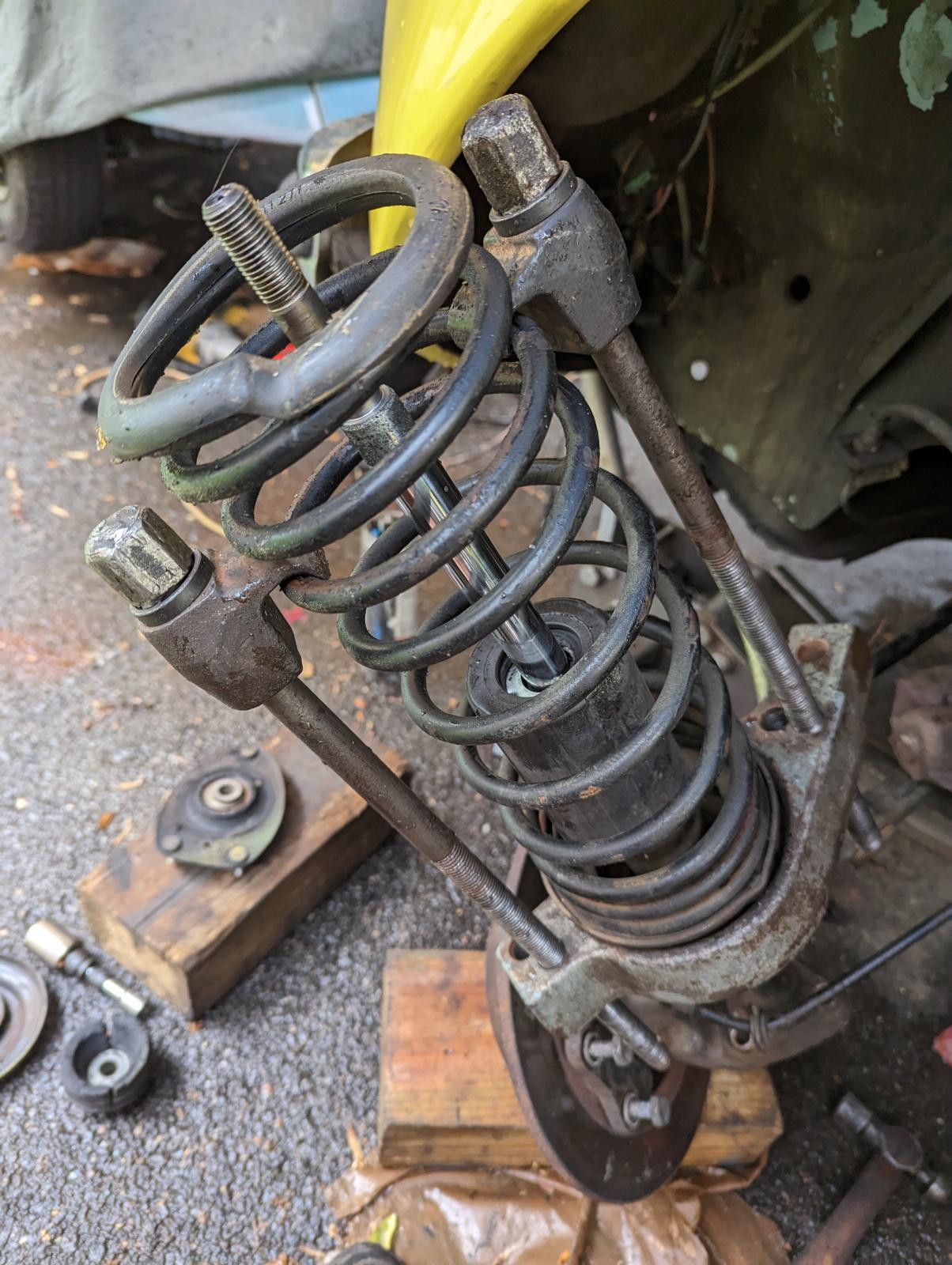

I was considering something like this:
https://www.amazon.ca/ATPEAM-Macpherson-Compressor...mp;sr=8-11
Ok- that is an awesome looking tool. Small, light (unlike the VW tool), looks like it would solve the problem of slipping springs. I'd love to know how it works.
boxer74 wrote:
Taking the strut assemblies out of the car and re-installing takes no time, but fighting with my damn 2-piece compressors is the time killer.
Not on the 3-point ball joint assemblies! Those are easy to remove, pain to replace. And I have to redo-mine after taking them apart a couple of weeks ago to replace bad ball joints and decomposed rubber tops below the strut bearing. I used these from Topline, which Jon wrote me to install a pair to a side, fat ends together, but this defeats the lowering springs I have and causes the front to bounce too much because they're hard urethane and super restrict the shock travel. So...I have to go thru the R&R again in the near future.
https://toplineparts.com/product/bump-stops-for-all-lowered-super-beetle-pair-87-0258-2/
I actually used those topline bump stops. But not a pair per side. I have only one per side with the smaller end facing up. Seems to work okay this way. No bottoming out.
The problem with the cheap 2-piece compressors is that the threaded rod is positioned too close to the jaws so when using it on these tapered springs, you end up rubbing and scratching the crap out of the upper and lower spring perches. You also need to alternate side to side with a box end wrench and the whole thing just frustrates me. Has to be a better tool for the job.

PostPosted: Wed Apr 26, 2023 5:35 am    Post subject: Re: Official "Super Beetle" lowering topic Reply with quote
You need this - a VW factory compressor, no problem w/the compressor hooks sliding around the spring! Cool
'75 Super Le Grande...we hardly knew ye. Sold 2025 for peanuts.

PostPosted: Wed Apr 26, 2023 5:21 am    Post subject: Re: Official "Super Beetle" lowering topic Reply with quote
vamram wrote:
I'd go a notch lower...
Nice Super btw!
That's kinda what I'm thinking. My wife won't be happy! Been messing with this too much. Gotta find some different spring compressors since these tapered springs are a pain with the set I've got.
