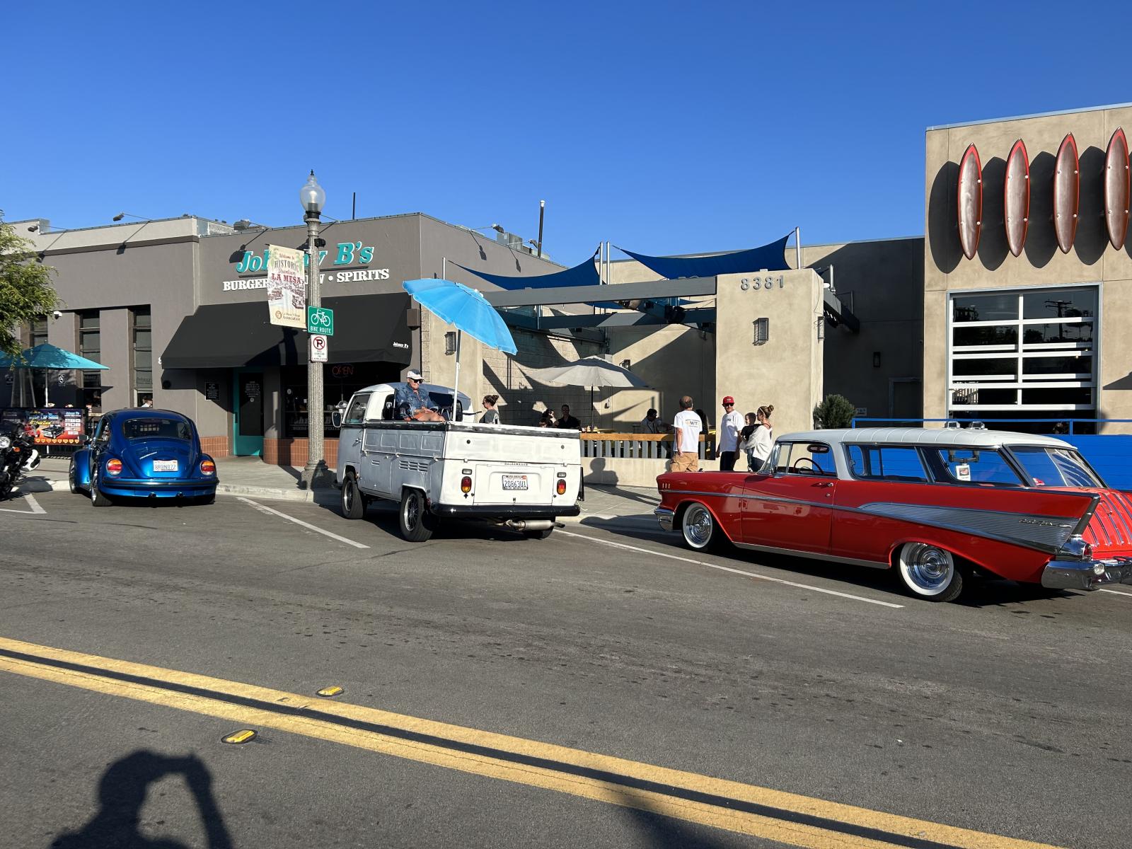

PostPosted: Mon May 26, 2025 1:54 pm    Post subject: Re: Plump Truck & the Gutless Wonder Reply with quote
Yet another motor delivery! Cool

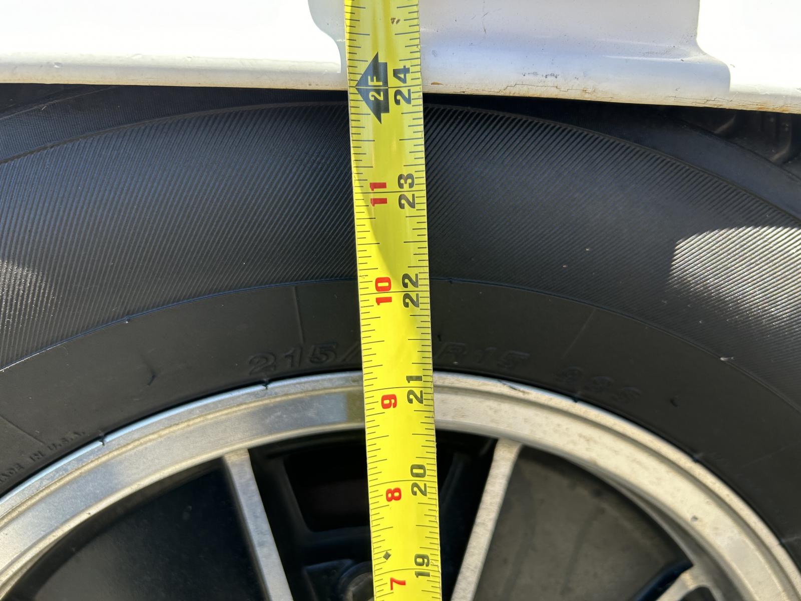

PostPosted: Mon Jul 01, 2024 5:32 pm    Post subject: Re: Plump Truck & the Gutless Wonder Reply with quote

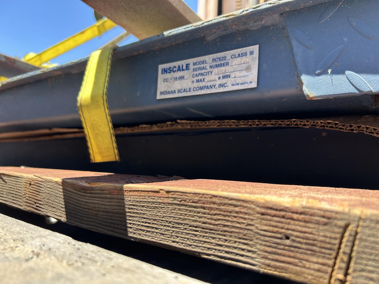

Lowered it again! Razz

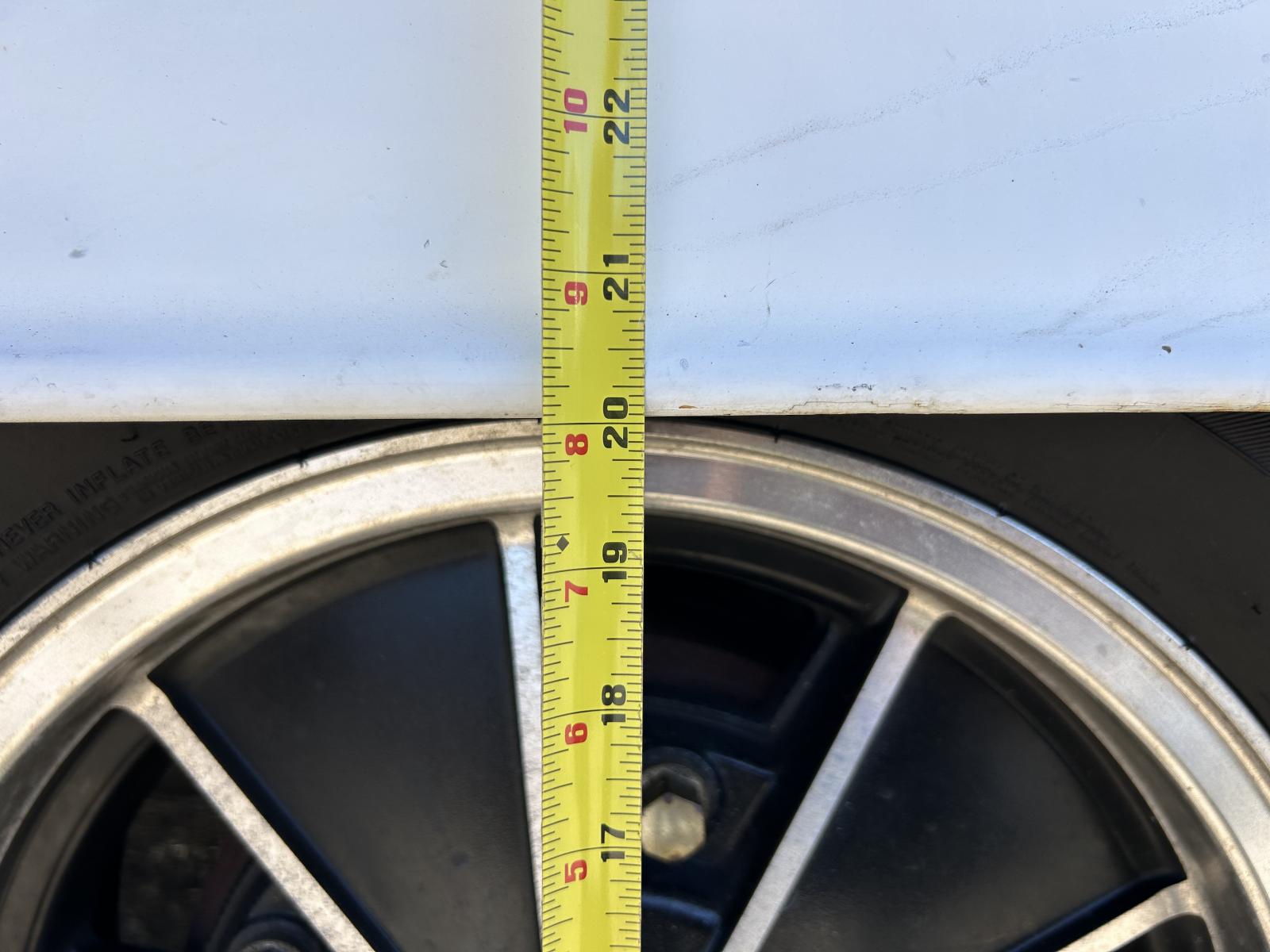

TWO 10,000 pound scales!
8 feet tall lift! Shocked

PostPosted: Tue Mar 12, 2024 6:03 pm    Post subject: Re: Plump Truck & the Gutless Wonder Reply with quote
busdaddy wrote:
pyrOman wrote:
Mini me! Cool
Are those truck rated tires?, what kind of oil do you use in that? Razz
3 in 1 Question Confused

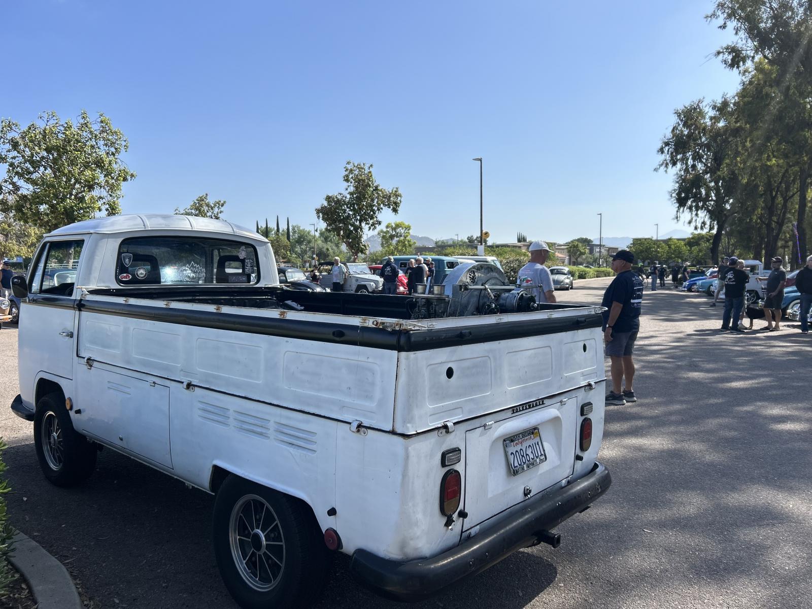

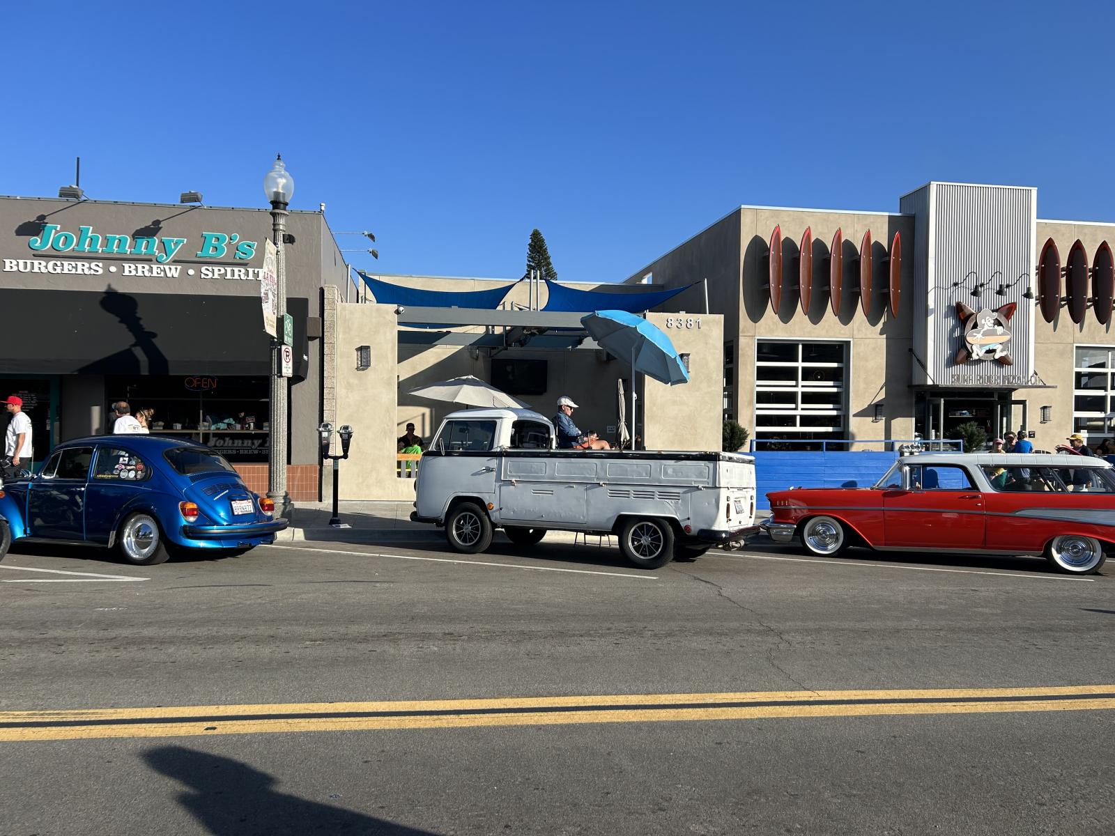

pyrOman is offline
PostPosted: Tue Jun 27, 2023 2:44 pm    Post subject: Re: Plump Truck & the Gutless Wonder Reply with quote
It received a lot of kudos at the cruise nights last week! Cool

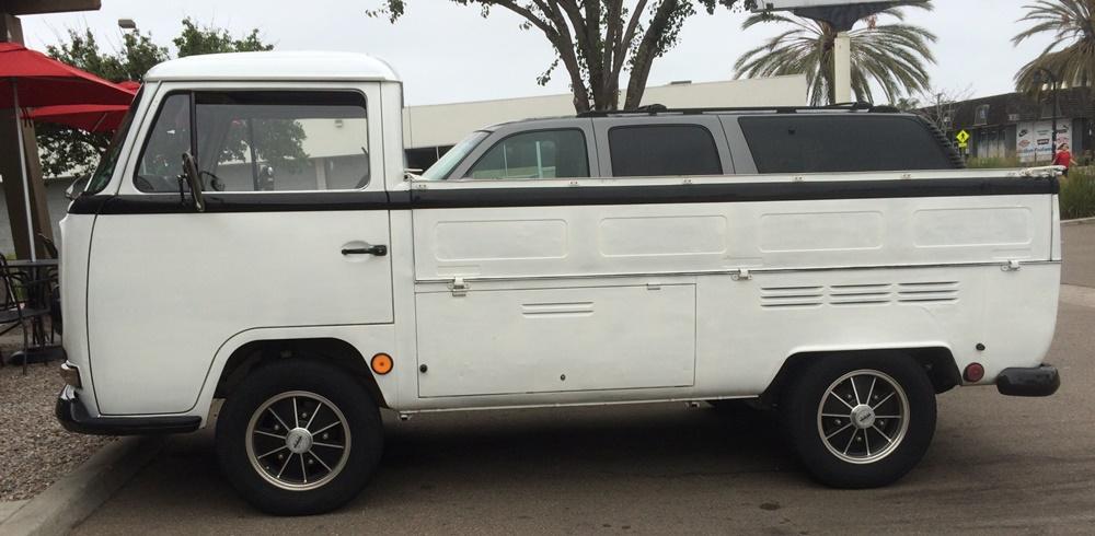

PostPosted: Tue Jun 27, 2023 10:57 am    Post subject: Re: Plump Truck & the Gutless Wonder Reply with quote
OB Bus wrote:
This story has been going on for so many years. What you purchased all those years ago was a pile of crap. You put it all back together and have a marvelous work truck. A work truck that still looks great! In my younger days, I would say “inspiring“ and pledge to get right on and doing something similar myself.
Those days are gone, however.
Enjoy that truck for many many years ahead.
Thanks! Indeed I am enjoying it and will until I can't drive anymore... God forbid THAT ever happens! Shocked

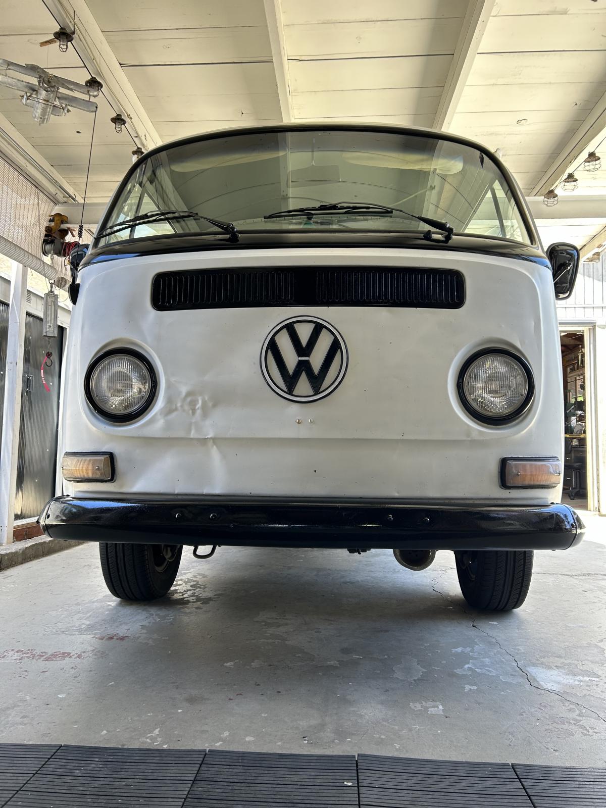

PostPosted: Fri Jun 23, 2023 5:03 pm    Post subject: Re: Plump Truck & the Gutless Wonder Reply with quote
Recap! Laughing
pyrOman wrote:
Way back in August '16 I wrote:
Spike0180 wrote:
babysnakes wrote:
Spike0180 wrote:
I want to see pictures in 6 months and a year. My experience gives me low expectations.
I think pyrO is in the dry south west. Should last a while. That shit sure wouldn't work for long in S.Floriduh.
it would be pealing within 3 weeks in detroit.
Again, it's just a rattle can job, even in 6 months it will look a lot better than it was! Very Happy
OB Bus wrote:
So it has been close to a year now. How's the paint doing? Any chalkiness? Peeling? Any rattle can stripes showing up?
See for yourself. Taken just a few minutes ago! Razz

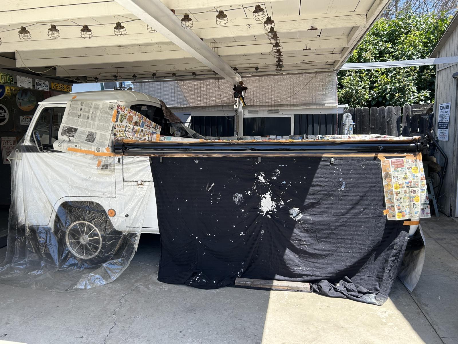

PostPosted: Fri Jun 23, 2023 4:58 pm    Post subject: Re: Plump Truck & the Gutless Wonder Reply with quote

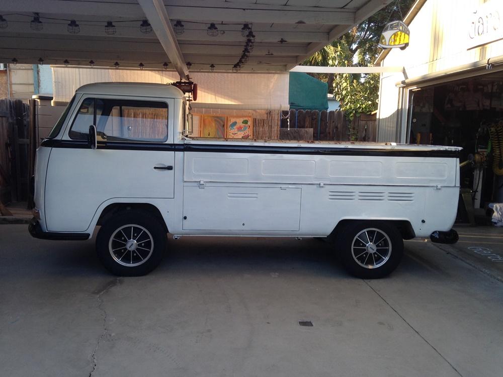

Touching up the black accents…

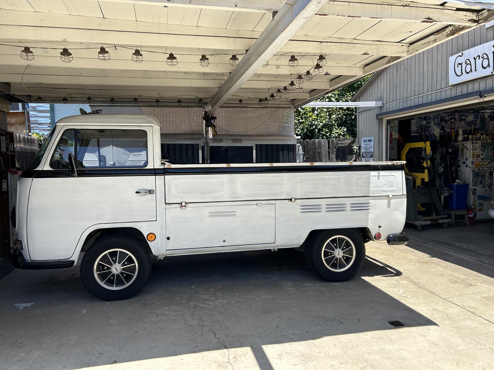

This shit will never get old! Laughing
Just now….

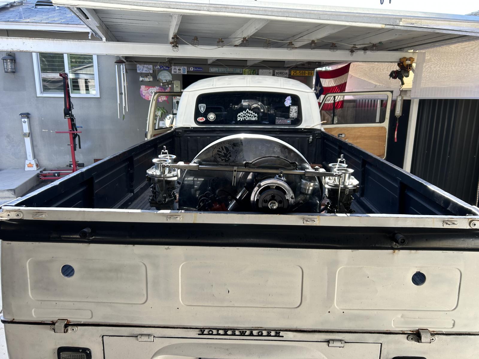

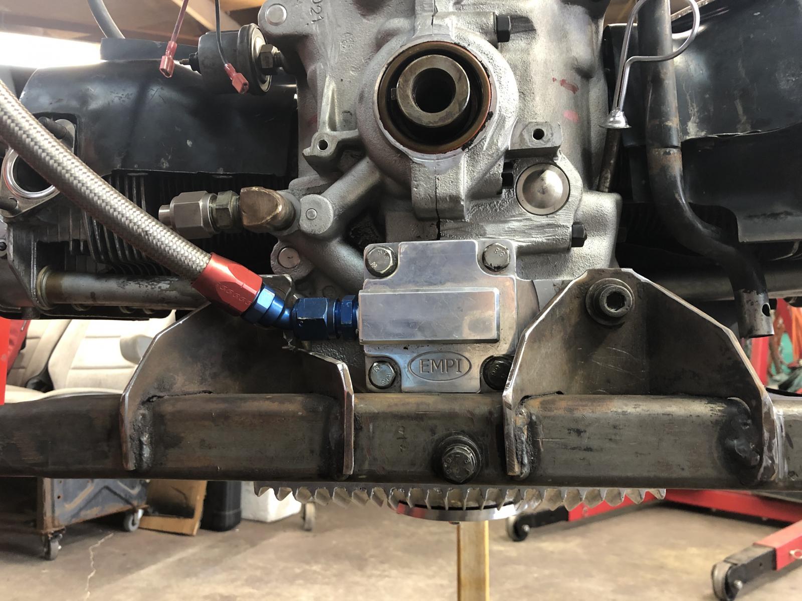

Yeah, it's been a little while since I posted ANYTHING here, but here's the latest update on the Plump Truck. Rolling Eyes

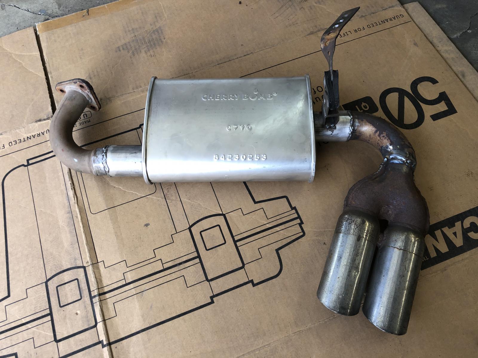

Many things have happened to the Plump Truck, like I had built a 1700 stroker motor which did quite well for it. However, after building a brand spanking NEW 2276 for the Dormy and the leaky old one from it just sitting there, I decided to install it in the truck. While the 1700 did ok, I really do load up the truck often and figured it could really use a bit more power. Now, you would think an engine swap is just that and it'd be a quick job. Well, it took me 3 full days since the 2276 is a full flowed case and I had no provision to have that in the truck! Some modification just needed to be done and while I was at it also decided to get a new muffler to replace the "ok" one that sounded like a rattle can. Confused
Anyway, here's the 1700 out...
And the dual Dellorto'ed 2276...

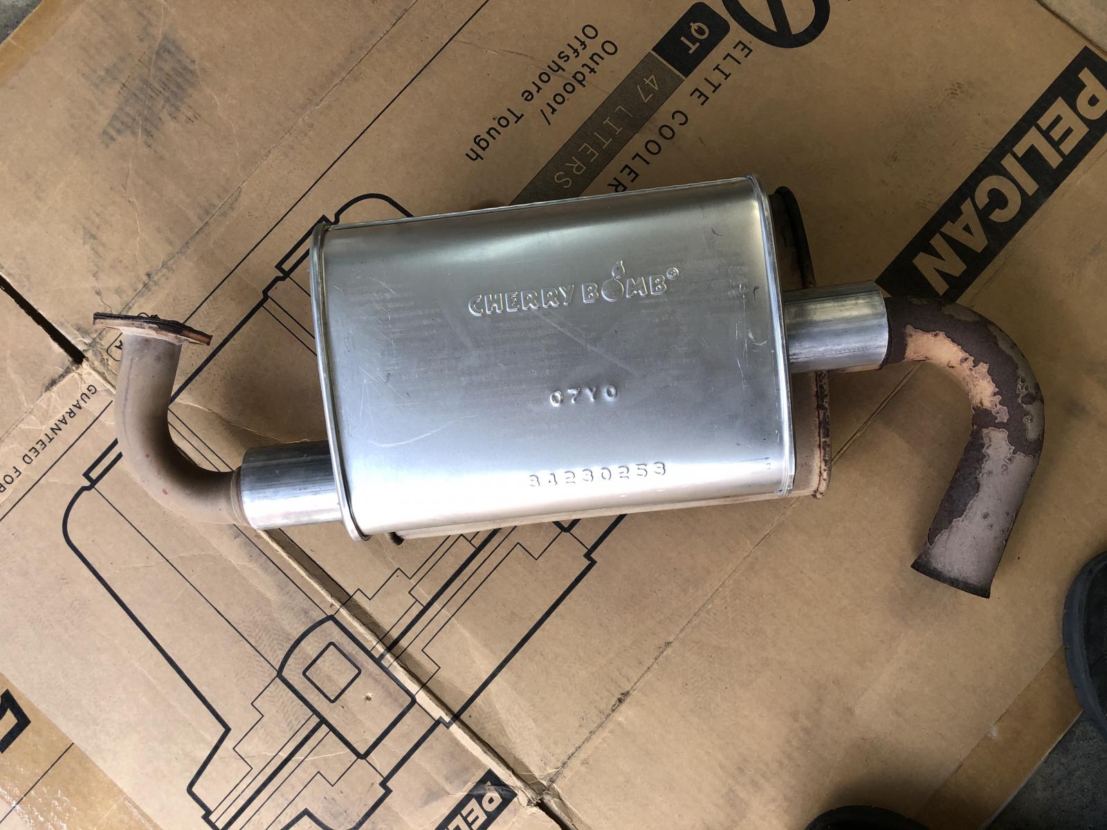

Mod on the moustache bar...
Filter location...
Size difference between the mufflers...
As usual, I sliced the old muffler ends and weld them up to the new one. At only $33 for the muffler, it beats the hell out of paying over $100 for an empi! Razz
The dual tail pipe was in my stash of parts for about 20 years! Shocked
Autozone has them in stock! Cool
