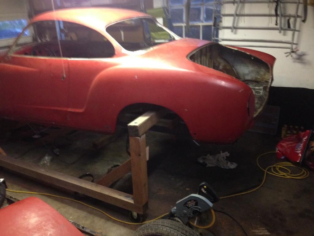

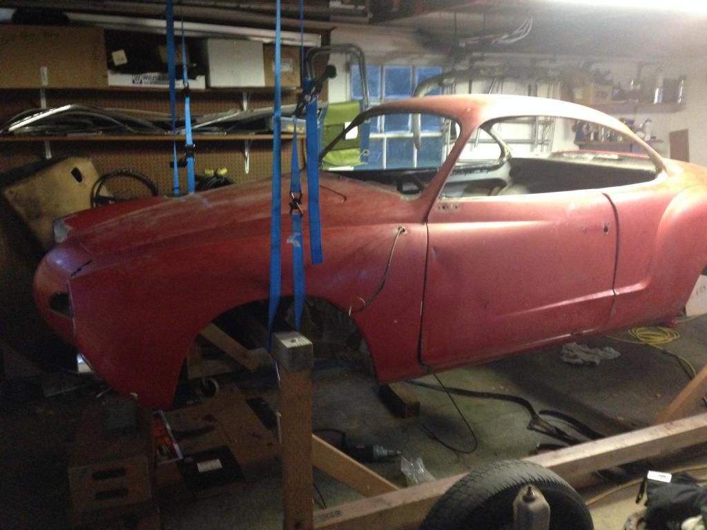

Straps were for lifting the cross member so I could get the new 24" riser sections in, they were still about 2" short to clear the shock towers!

Used your general dimensions and built mine. Couldn't find that big of a caster so I went with 5". I made my risers 2'. Rest is the same
Got some cleanup to do now so I can really get going

Also keep in mind the wheels that are pictured in Bella's pictoral are pretty tall. I made a dolly recently but didn't realize (till now) that the body on the dolly wouldn't clear the shock towers, so I made my verticle peices 24 inches so I can roll the pan under the dolly, and will also make getting under the car for welding & repair that much easier.

Something I found out about this wood dolly that others in the future may
want to know......I built mine in place on the car. It seems everyone was
building the frame and putting the body onto the dolly. But this is what I
did and it worked. Removed the front tires. drums/discs, motor/tranny
already out and horizontal 4x4's slid into place....then I lowered the pan
down instead of having to find others to help me lift the body. I was able
to do the whole thing by myself, except for a few minutes of holding the
long 4x4 with the dollies already bolted on. Clear as mud Question

I made mine and put my Ghia on it last weekend.
Now I can get to working on the underside of the car again. Have a new heater channel to go in, and a new drivers rear fender to follow.

Worked Perfectly! So with some minimal help from my brave wife (quickly moving underneath the car to put the last 4x4 in place, we perfected the 2 person lift using a partially collapsible body dolly. looking at the pictures, it almost make me want to put hydraulics on the ghia! (almost, but not enough)
I used 30" uprights and 4" heavy duty casters, which gave lots of clearance.

awesome idea... I'm going to make one this weekend w some slight tricked out mods. If you make on end detachable, you can raise the rear of the body and slide the dolly in, then raise the front of the body and attach the front of the dolly. I have drawings but no clue how to post them. This makes it possible to lift the body with one person, no problem!! Solidworks renderings attached... yes i am an engineer and a proud nerd!
