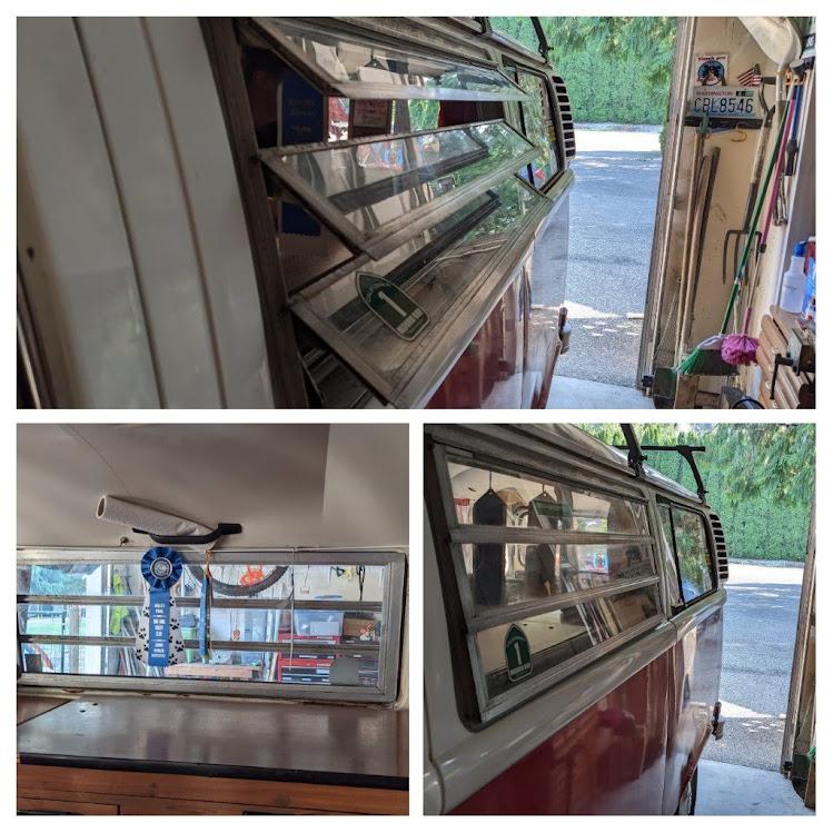

cdennisg wrote:
On the jalousie/slider debate, I will use a slider on the sliding door, and a jalousie on the other side. Jalousie windows tend to rattle too much, and the slider seems to exacerbate that issue. I like sliders, and I have one with a screen, but being able to have an open window during a rainstorm is a good thing for camping.
I'm with you.
My favorite config on a Bay (so far) is dual rear slider windows, a slider window on the sliding door, and a jalousie on the driver's side middle spot.
I'd be curious about trying one vent window on the rear driver's side (with 2 sliders on PS and a jalousie on DS), though... for a a bit more fine-tuned control over airflow.
A jalousie on the sliding door is much more useful than fixed glass, but does feel kinda janky flopping around, and all that door slamming doesn't help things any.
Having a driver's side jalousie, with the screen and the ability to basically leave it open all the time, even in the rain.... is pretty ideal, IMO.
I also like running the opposite-side jalousies (e.g. passenger side on the driver side) so you can operate the knob from the front seat.... it's easy to reach behind you and open/close while driving.
The repro jalousies are also really nice quality. With near zero play in them, they are much nicer to keep open while driving... although, doing that is usually what gives them all that play - as the Westie manual text warns...as the kids used to say - yolo...

Realize this is an old thread, but just did this on my Transporter. We're slowly converting to a Westy Weekender. Easy fit.
1976 VW Transporter, 2.0 FI Engine
