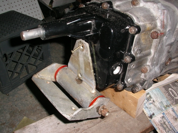

Can you please tell me the measurements from A , X , Y and Z
I am trying to build a Bus-to-bug-mount , these measurements will make it a lot easier. In mm or inch.
Thanx in advance Very Happy
greetings from the netherlands ,Bajadude
[url] http://www.keversite.nl/fotoalbum/fotos/29541.jpg [/url]
[url] http://www.keversite.nl/fotoalbum/fotos/29540.jpg [/url]

Allright, straight back from the garage, and my caliper says that the front mount varies from .198 to .205. Probably as you said Skiddy, 3/16.
The rear mount is .25.
All of this is in inches, BD.
If you're going to build one, a few things to watch out for:
-The lower right part in the pic mounts to the pan. The semi-circle bite out is necessary to clear part of the tranny nosecone.
-The 'W' shaped part fits below/forward of the bellhousing, and is designed to clear two webs on top, and give access to the tranny drainplug on the bottom. It doesn't do either well.
-The 'W' shaped part is where the 10 degrees comes from. It's not 90deg from the axis of the red bushings.

I seem to recall that the plate it's made of is .2 inches...
In cold rolled or hot rolled steel it would be either 3/16" (.188) or 1/4" (.250"). I haven't seen much on the market in between those. The 3/16" size would be more than strong enough. Cold rolled would paint or plate easier due to lack of scale on the surface. Just my $.02 (since I am not working on my car right now... Very Happy )

I finally tracked down Ron Barrett a few months ago. He's totally out of the business, working for some wholesale parts supplier, so there is no old stock. He did say that he was OK with people copying that mount, though.
I plan to do just that as soon as I get done with CAD drawings of it. Plasma cut, jig welded...
I'll let you guys know when I've got a few ready.
In the meantime, BD, you might check out McKenzies weld-in mount. It's the one that's shown installed in "Transmissions For Dummies", pg 3:
http://www.thesamba.com/vw/forum/viewtopic.php?t=143138&highlight=transmissions+dummies
The Barrett one is shown there uninstalled.
