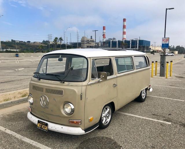

BYeaton wrote:
Here is my '70 Deluxe Sunroof:
Front has a 4" Valley Autowerks beam with Wagesnwest drop spindles and their babystang disc brake kit.
Rear is Wagenswest 4.5" horseshoe plates, adjusted splines for about 1" more drop, pipe notch just like tbellisimo posted above, Monroe air shocks with about 35 psi in them.
Wheels are American Eagle polished 5-spokes. The front 2 had 0.25" machined off the mounting pads for more offset and use a 165/65R15 tire (23.4" OD). The rears are a 205/65R15 tire (25.5" OD, stock 185R14 is 25.7"). Hand painted center caps.
Have a set of 17" Raders that are at powder, and those will be an alternate set for me. I'll post when I get those on.
love it

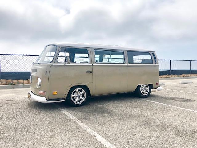

Here is my 1971 Bus. 4" narrowed beam, 2.5" drop spindles with 3.5" horseshow plates. Wheels are 17" BRMS.
