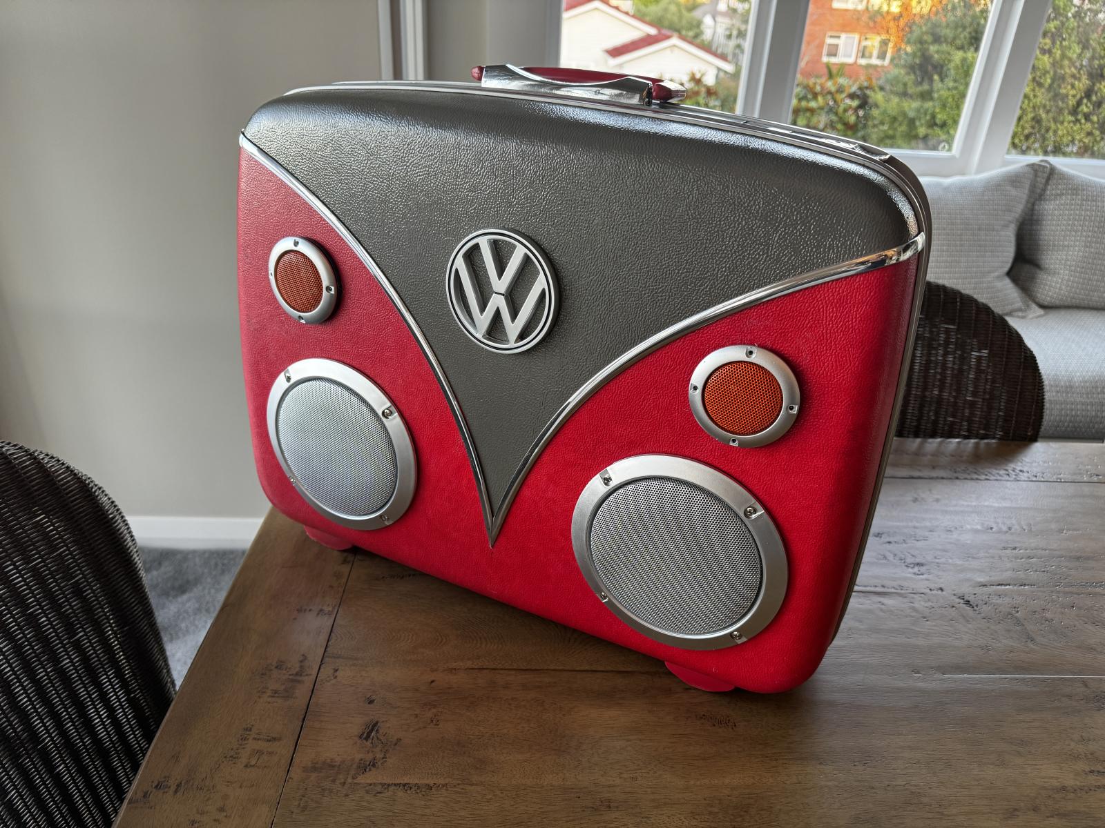

I just put the Retro Style Blue Tooth head deck at the front with a 2-Way speaker mounted under the dash and have made a Blue tooth boom box that is portable and can also sit on the rear seat and act as rear speakers.

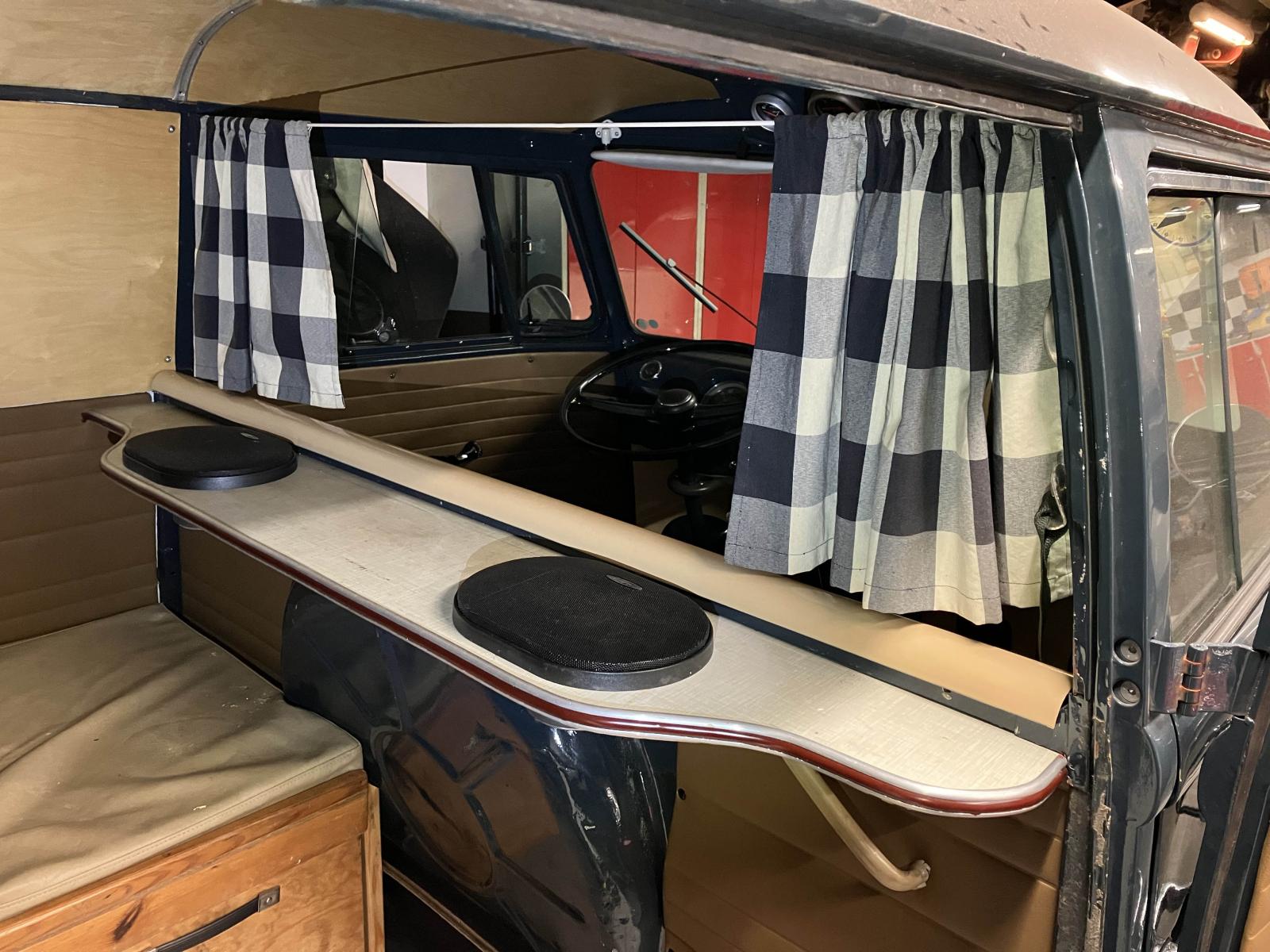

Made this speakershelf from a vintage countertop. Will build some storage below the shelf. Maybe paint the speakers to make them blend more in. Or make custom covers..

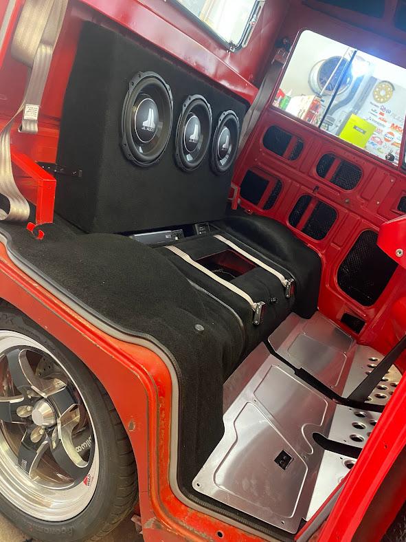

Squeezing 3x 10in subs into my single cab...

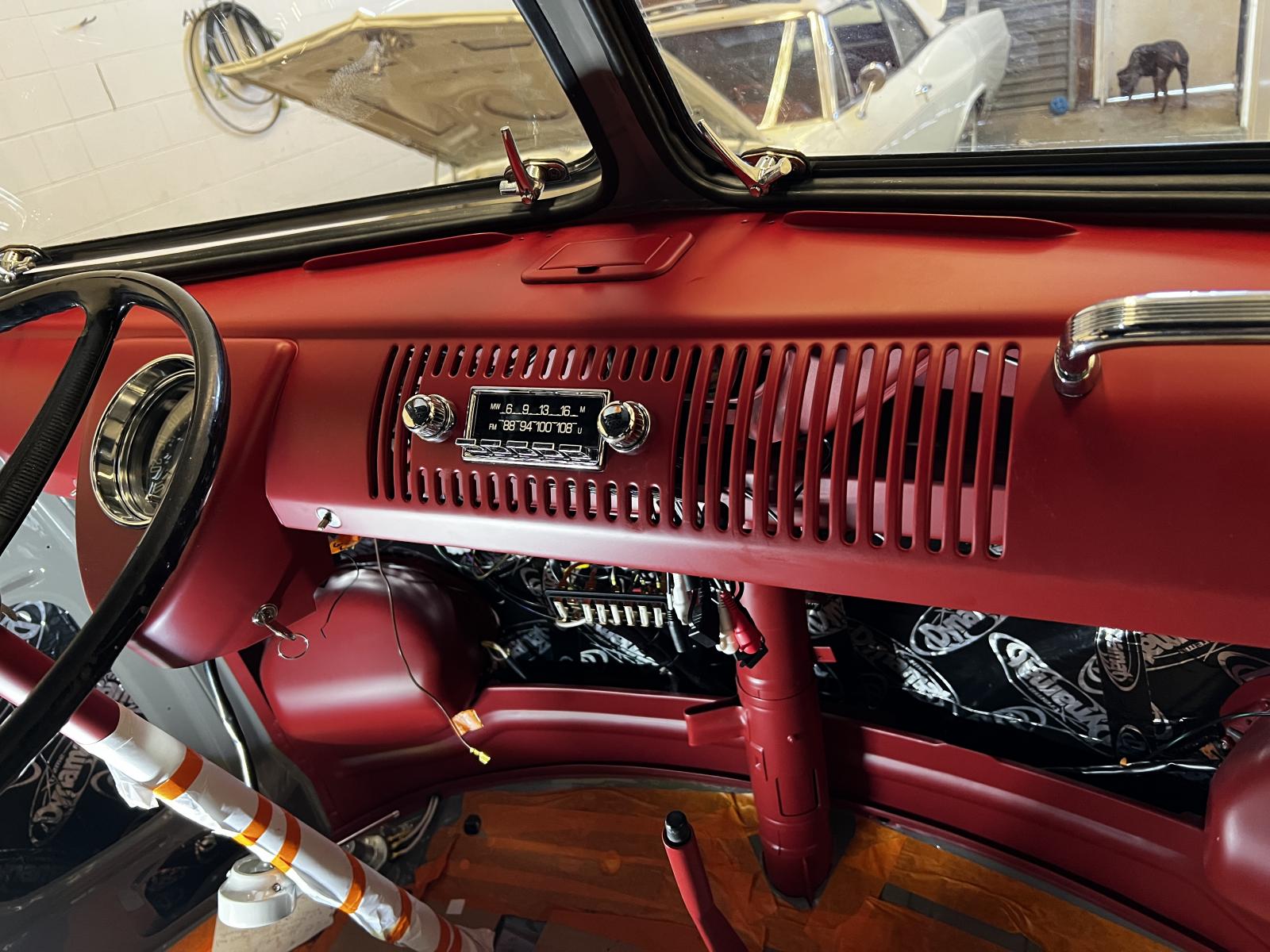

Anyone recently install a stereo with a really clean install? I am starting my research and this thread has been helpful. I am just seeing if there are any updates from last year! Thanks!

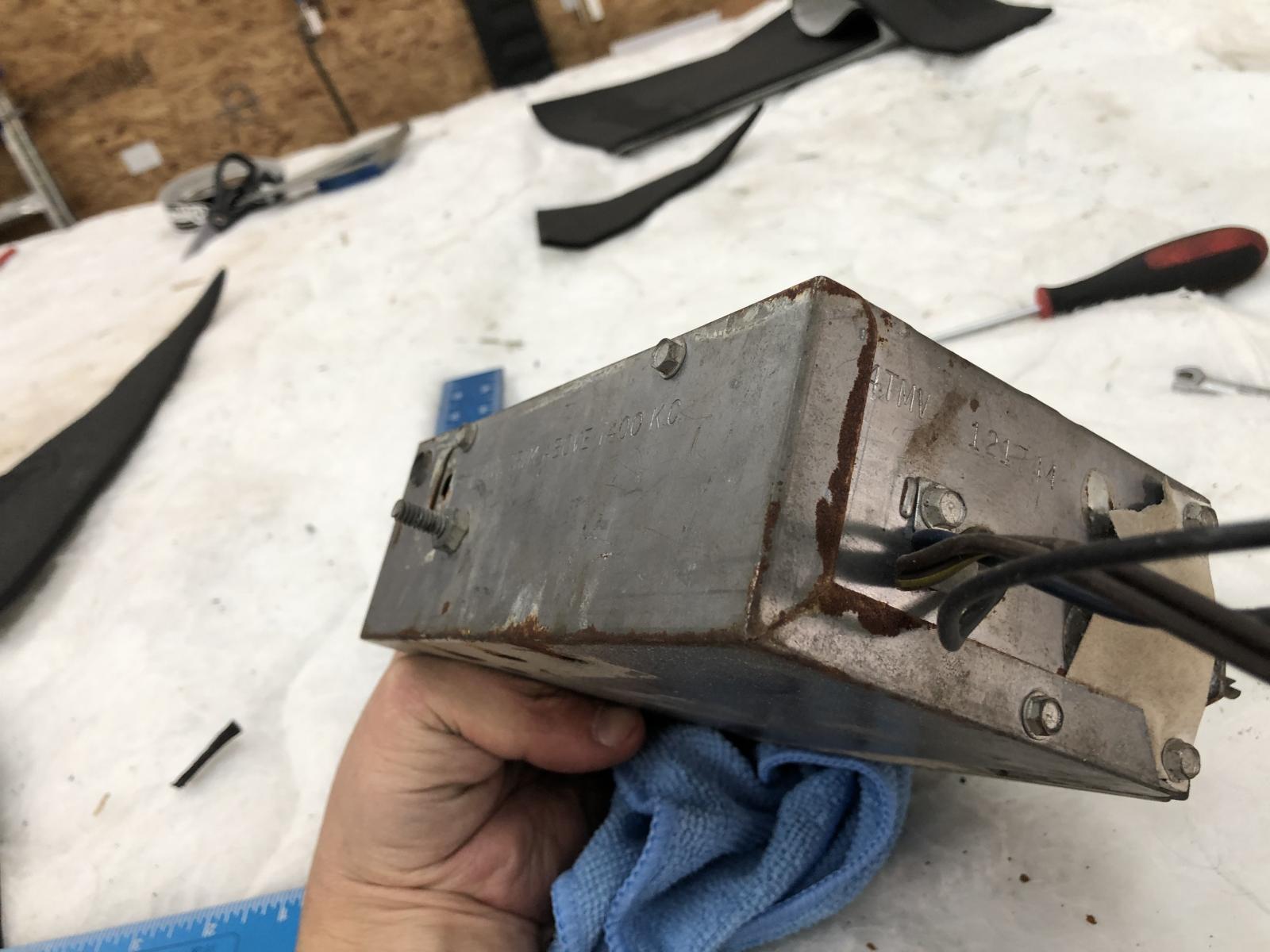

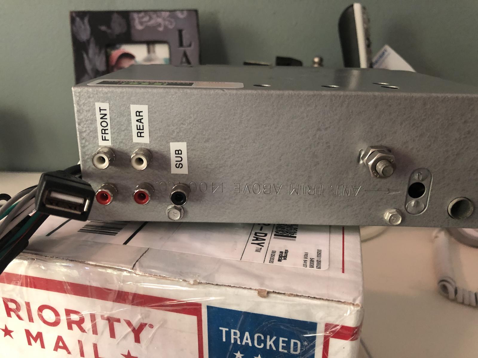

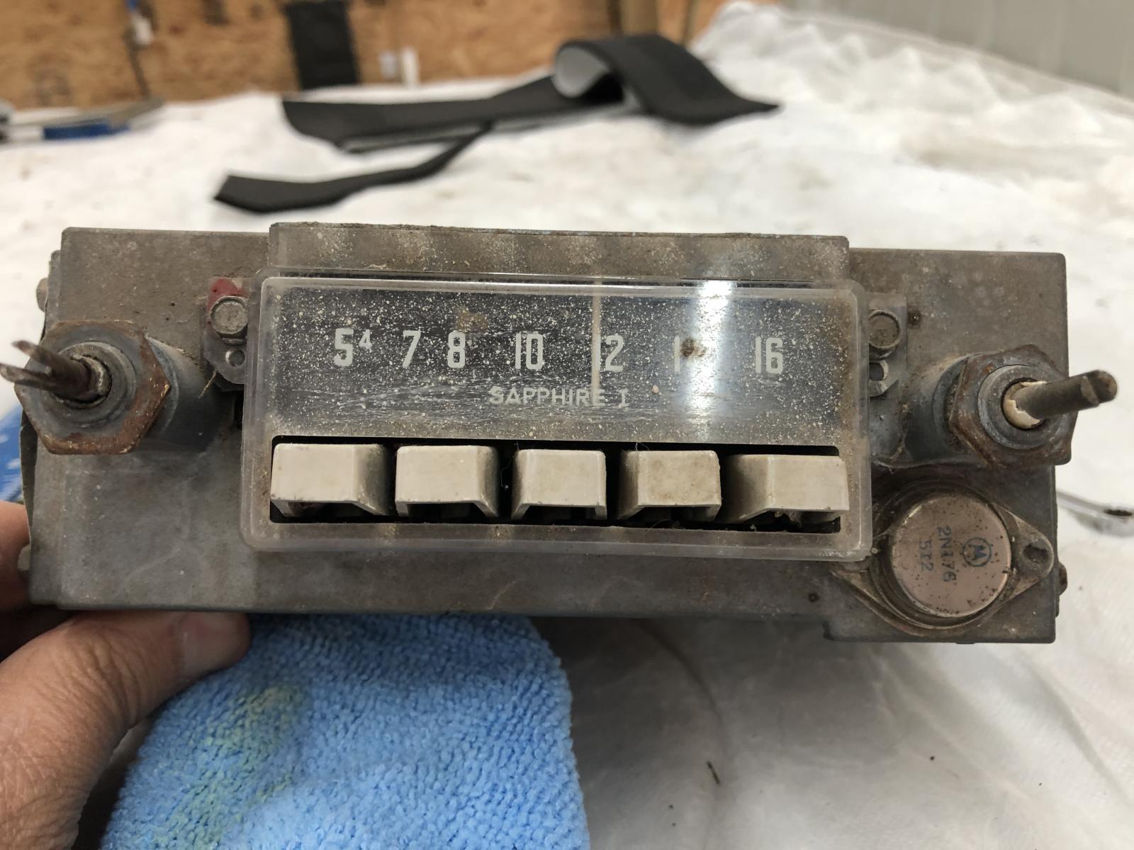

I'm working on the sound system in my 1960 Double Cab. I sent an old Sapphire I to Joe's Classic Car Radio Co. for restoration and upgrading. Joe added Bluetooth capabilities, USB input, and RCA's for Front, Rear and Subwoofer. It turned out great. Here are a couple before / after pics. I'll post more pics of the install soon.
Before
After

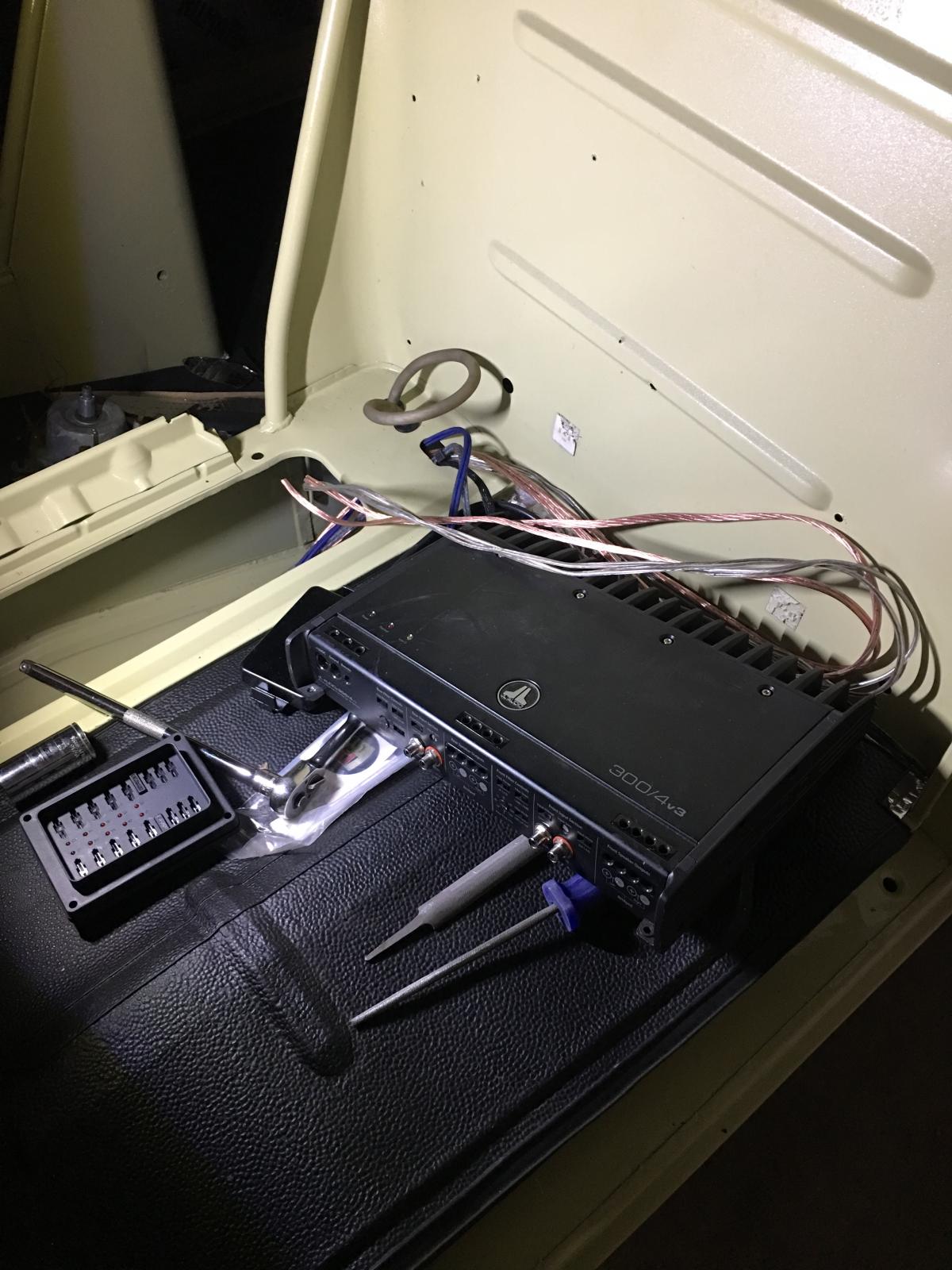

I put the following set up in my bus. The volume module has an aux cord that goes into my XM radio or can hook into a bluetooth receiver. Part number is JL Audio CL-RLC from Crutchfield. Blue light is power to turn on the amp the black knob is volume.

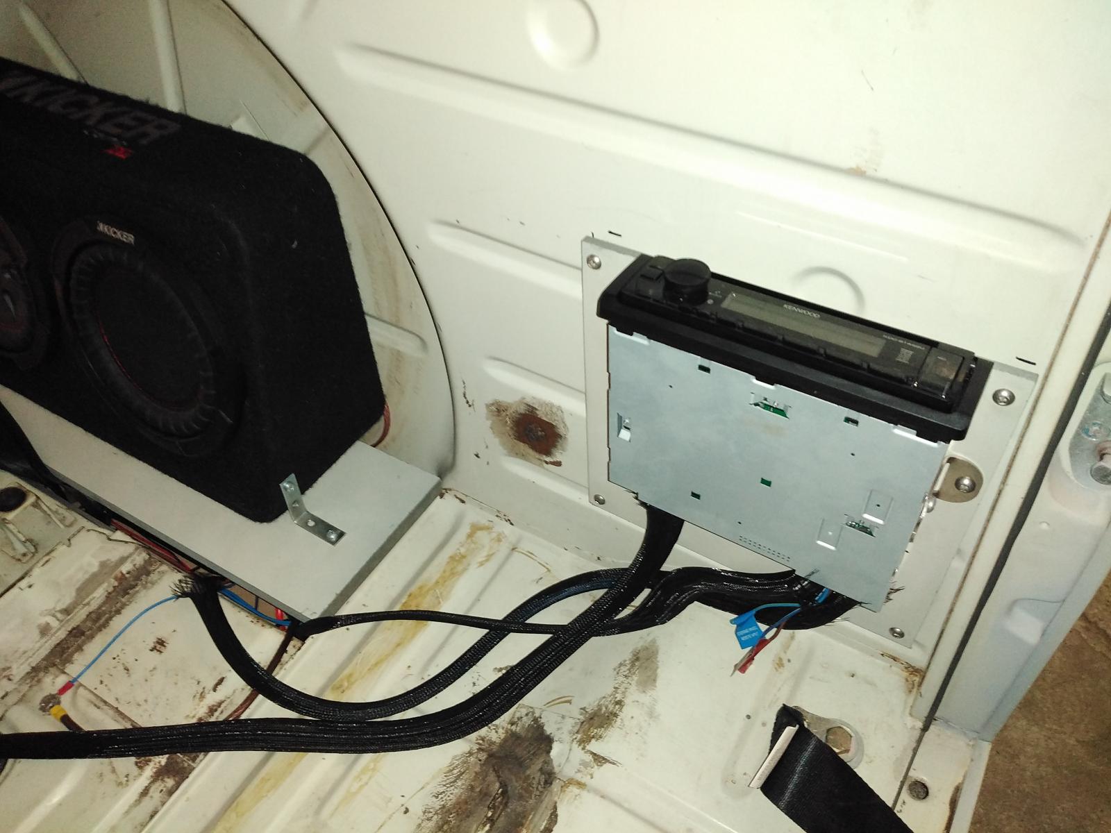

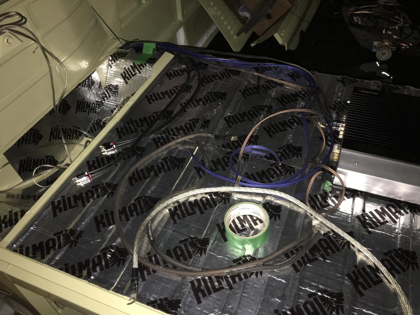

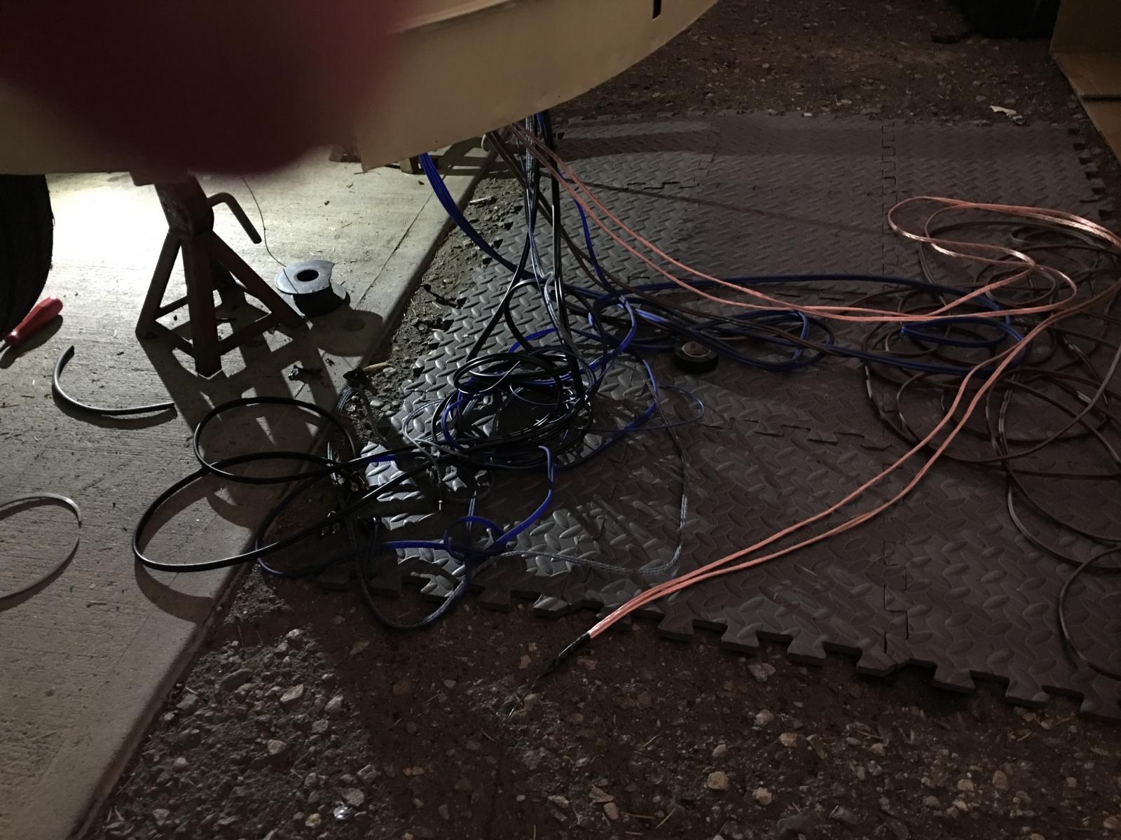

Here is the setup I've just put in my 65 Panel.
2 amps in the spare wheel well. A JBL 600 watt amp to run an 8" sub and a smaller Vibe 400 watt micro box to run the mids in the toolbox and the doors.
I had two spare JBL 5 1/2" mids so mounted them in the toolbox. Never seen it done so what the hell.
Made some pods for MTX 6 1/2" mids in the doors (door cards are aftermarket - definitely wouldnt have cut originals). Couldn't figure out a suitable way to get them into the kick panels. Waterproof covers are provided inside the doors. Temporary arrangement for the door cabling until I figure out how to get them through the door jambs without drilling.
Here is where I chose to mount the headunit. Mounted on a piece of 6mm MDF and fixed to the cab divider with rubber shocks. Out of the way of water and pretty well hidden. Also was the best way to keep the wiring tidy. Have a Kenwood app on the phone that you can fully control the head unit with so it's not a problem it being behind you.
Everythings running off a separate battery with a split charge system so the ignition and other electricals are entirely independent of the system. I was a small sub skeptic. Not any more. This little 8 is UNREAL and with everything being in the cab, the sound quality is really nice.
