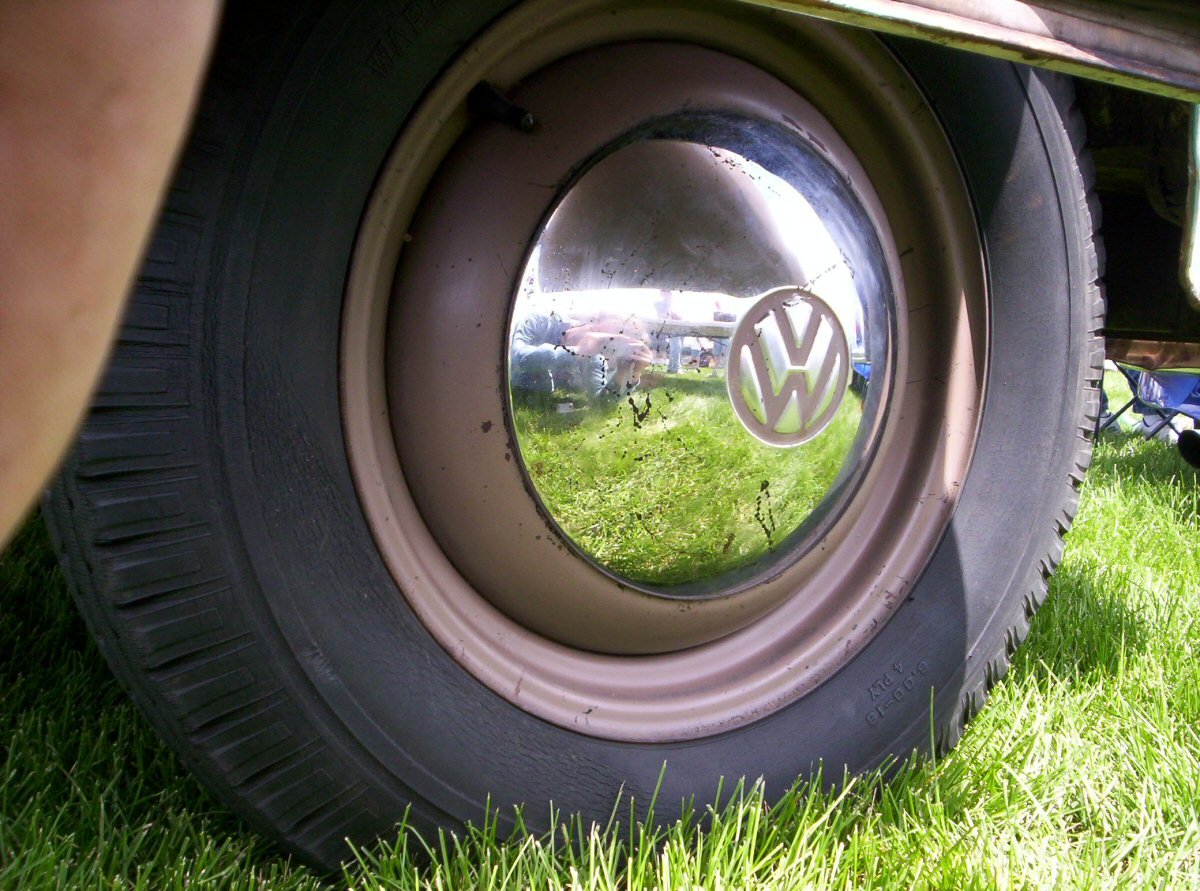

Rusting Hulk wrote:
An old thread i know, but i just wanted to know if the logo in the centre should be painted black or red? If red is correct what red is used.
for a barndoor deluxe the center should be red. I am not sure if it is exactly sealingwax red. for the standard buses, it is the light brown color.
I had a few original paint red center caps earlier this year, but I gave them away since a friend of mine needed them for his barndoor deluxe, and I had no real need for them. he still needs one red center cap if anyone has one.
here is a pic that I took of a rare original paint barndoor hubcap.
