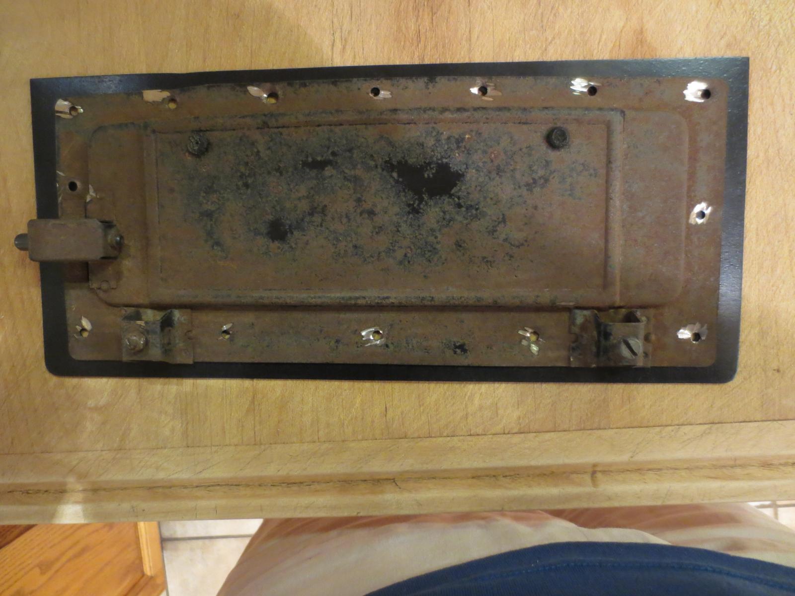

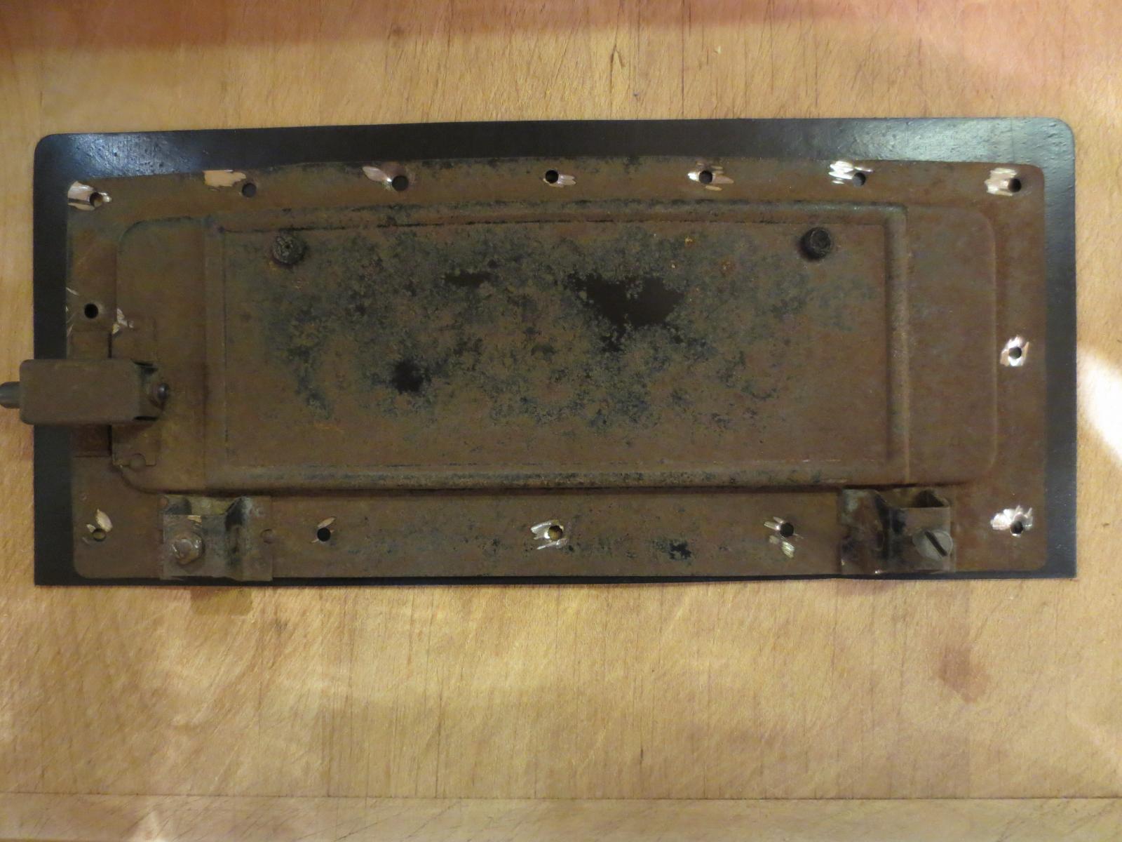

OK will do. I bought the seal from Airhead. I looked at their add as well as everyone else selling the same part. No one had a decent and descriptive picture.
These pix are a bit hard to see. In both pictures the holes on the seal are lined up with the rivet holes on the metal flap.
In the first one there is an extra part of the seal showing at the top.
And if I rotate the seal 180 degrees the rubber seal is square on the plate.
Would having things all equal insure success? I just do not want to do the riveting twice.
Thanks!
Larry in OB

PostPosted: Mon May 25, 2015 6:48 pm    Post subject: Reply with quote
OB Bus wrote:
The new seal has a longer flap that goes on the "top" (near the roof) OR the bottom. Any ideas which side get the longer flap?
Can you post a picture of the seals or link to the kit?

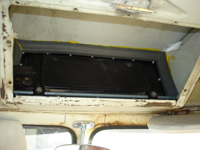

Jerry J wrote:
Major Woody wrote:
This is a very satisfying small repair to do. Replacing all the seals in the flap area, sealing it up tight and also replacing the rubber on the directional flap is a pleasant project and there is nothing like the soft "whump" of the flap snapping into place or the flaps moving smoothly from side to side.
I got NO air leaks now, and all the metal up there is rustfree and smooth gray! Very Happy
Did you use the seam sealer like Everett said? I had that shit all over me trying to get it pressed into all of the seams.
Yah sure, you betcha.
I actually used Vulkem polyurethane caulk, which I believe is the most tenacious gooey substance on earth. I put about an inch of it on the tip of my finger and applied it that way, little by little, after priming and painting. There was a little bit of a mess on me but everywhere else was fine.
When I pulled mine apart, the flap was stuck open because of a big ol wasp's nest and there was another one in the vent, preventing the directional flaps from moving much. The rubber on the flaps was all crusty and folded over and hard. Now everything just glides like butter.

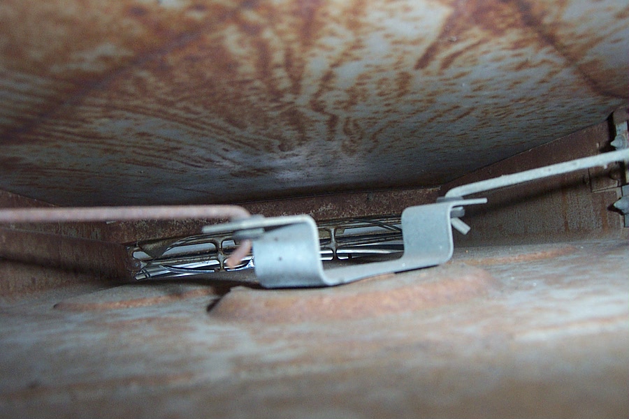

So after the rain yesterday and this thread going, I was curious as to what's goin' on behind the scenes up above. What I ended up finding was:
3 different size screws holding the cover on
which one is correct?
backside of cover needs a little treatment
you can actually see rust streaks blown up by the wind, kinda cool really but still need some POR or equivalent
and do dry desert buses look like that up there??
and this view was a first for me, also needs treatment
