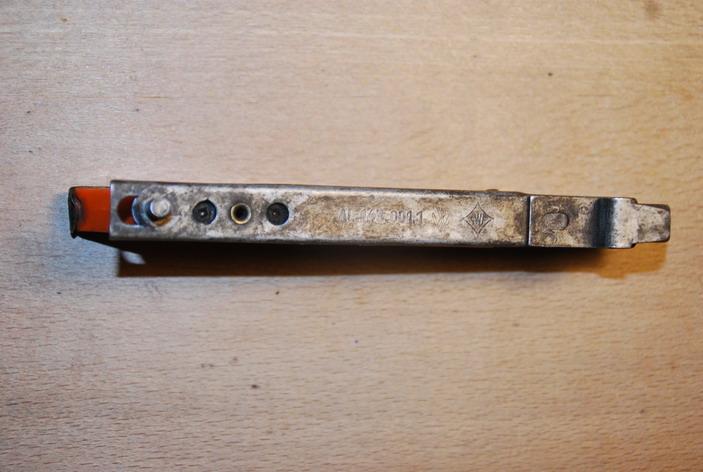

PostPosted: Mon May 18, 2020 7:16 am    Post subject: Re: Date coded semaphores? Reply with quote
M is used on SWF ribbed sems, I have restored several sets. Must be for the rare 13th German month. Weird...

PostPosted: Sun May 17, 2020 10:23 pm    Post subject: Re: Date coded semaphores? Reply with quote
To clarify:
The date code thread says I and O were not used for the year and I was not used for the Month.
The date code thread said "A-M, I was not used" for the month stamp
I changed it to now say "A-L" instead.
Please confirm you have never seen an M for the month field, otherwise some stuff is going to be off

PostPosted: Sun May 17, 2020 6:27 pm    Post subject: Re: Date coded semaphores? Reply with quote
johnshenry wrote:
No, they used "I" despite what this thread says. I have restored several "IC"s myself.....
I know u restored alot, i was convinced it was september 51 after ur reply Wink just wanted figure if letter "I" was used or this was just "J" bad stamp since at swf data code is mentioned that I and O was not used, seens it was, at least at semaphores.
Thanks alot for this info, small details that say a lot for those who want to learn more, i know more today. Thanks again.
johnshenry
Joined: September 21, 2001
Posts: 9414
Location: Northwood, NH USA
johnshenry is offline
PostPosted: Sun May 17, 2020 6:14 pm    Post subject: Re: Date coded semaphores? Reply with quote

franklinunes
Joined: August 06, 2007
Posts: 414
franklinunes is offline
PostPosted: Sun May 17, 2020 6:12 pm    Post subject: Re: Date coded semaphores? Reply with quote
johnshenry wrote:
franklinunes wrote:
Hi guys
What makes this SWF semaphore "IC" month and year? For sure 1951, but month? Any idea? Any help appreciated
Regards
Sept 1951
Thanks John, This is letter J? Looks like an I or they used both for september?
Thanks
johnshenry
Posts: 9414
PostPosted: Sun May 17, 2020 5:48 pm    Post subject: Re: Date coded semaphores? Reply with quote
franklinunes wrote:
Hi guys
Regards
Sept 1951
John Henry
'57 Deluxe
'56 Single Cab

PostPosted: Sun May 17, 2020 4:39 pm    Post subject: Re: Date coded semaphores? Reply with quote
Hi guys
Regards
