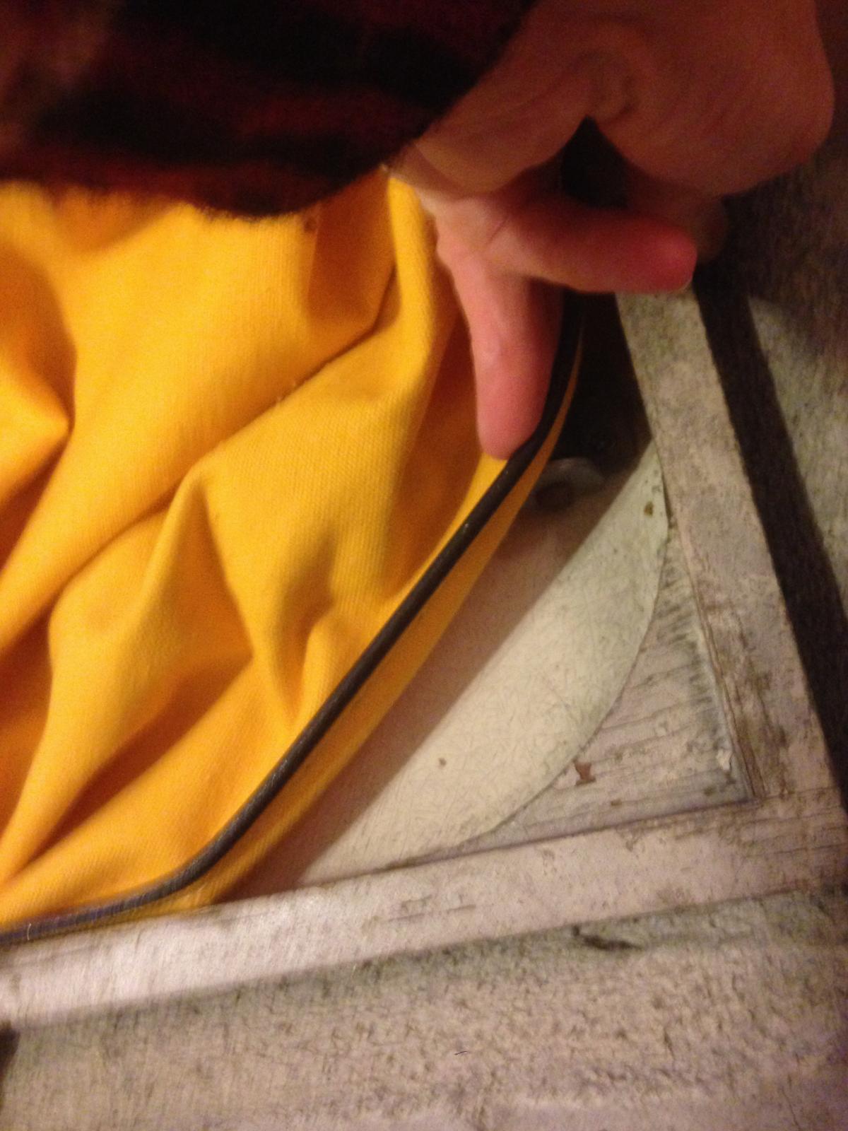

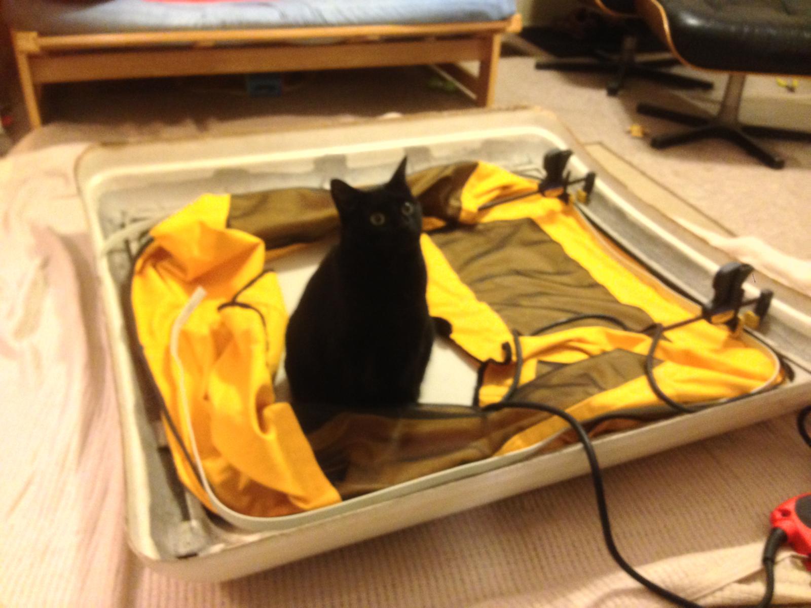

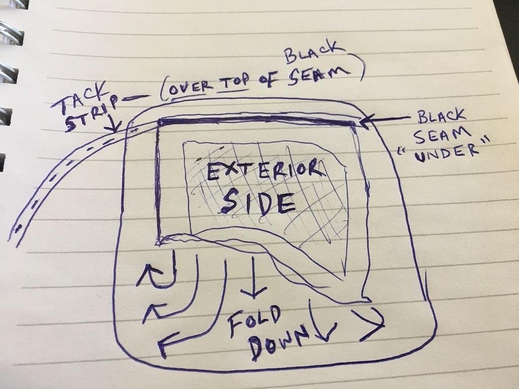

Now I see what I have wrong. yea, yea that's the perfect photo finish, thanks crofty.
I finally located all the hardware and halted the install because I need new elastic lock nuts which I am guessing will be difficult to locate.
crofty wrote:
Now I can see what you drew jeremy57ride, I'm so glad I didn't staple it in yesterday.
jeremy57ride wrote:
Ain't pretty... but maybe?? Confused
Got it thanks srfndoc.
srfndoc wrote:
This picture shows it pretty well as part of the canvas is ripped away so you can get a better idea of how it was done:

Think hoodie. You more or less drape the canvas over your head and staple it upward- remembering inside vs. outside. While you are stapling- you are looking straight out into blue sky through your open top because it is hanging over your head like the veil of a freshly revealed bride!
I started after numerous test fits from the center of each straight section- working toward the corners to get the tension close. Then you pull it back over yourself and let it hang from the tack strip- if that makes sense.
