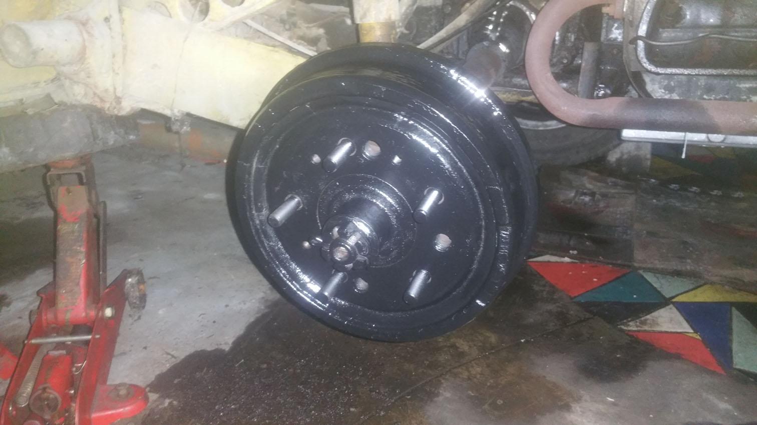

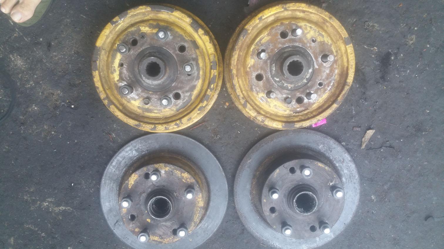

After removing the rear drums and the front rotors it was time to have these re-drilled to Porsche 5x130 bcd bolt pattern.
The finished re-drilled drums and rotors.
I also installed the tires onto the Fuchs from the Sprintstars EMPI. The latter wheels will have to be stored in our attic for a long long time, I may say.
After installing back the rear drums and the front rotors, I applied a few coats of flat back to give a fresh look.

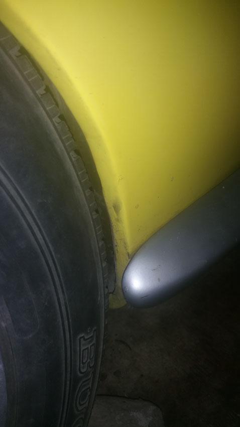

The Fuchs with the 165x15 tire was looking so tight on the left side....
.... also the same tight fit on the right side. I can't imagine how close the tires are to the leading edges of both rear fenders near the both ends of the bumpers.
The rear shot of the Fuchs already installed. So tight by mere looking at it!
The front view with the Fuchs and tire looks so relaxed and with ease.

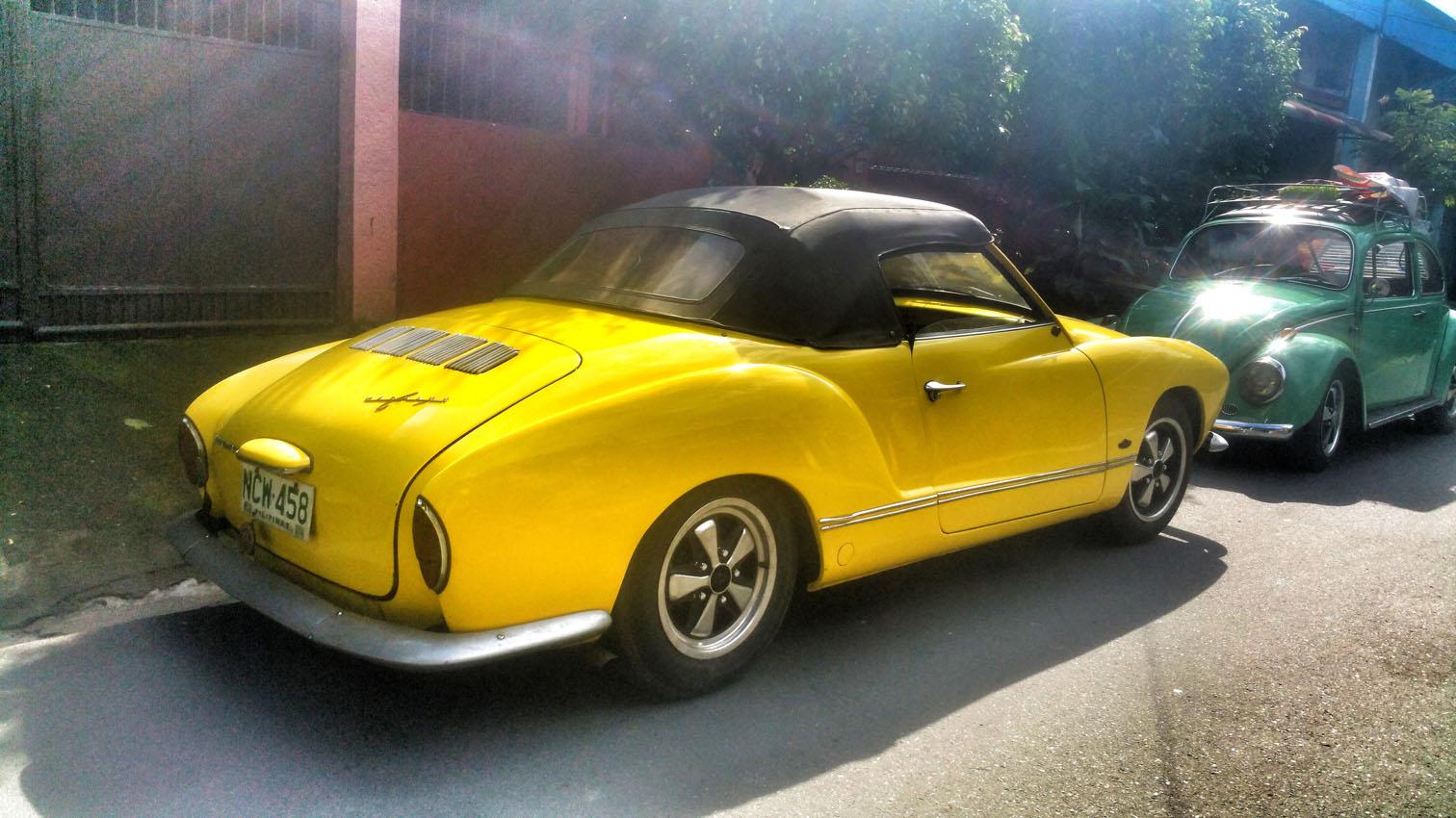

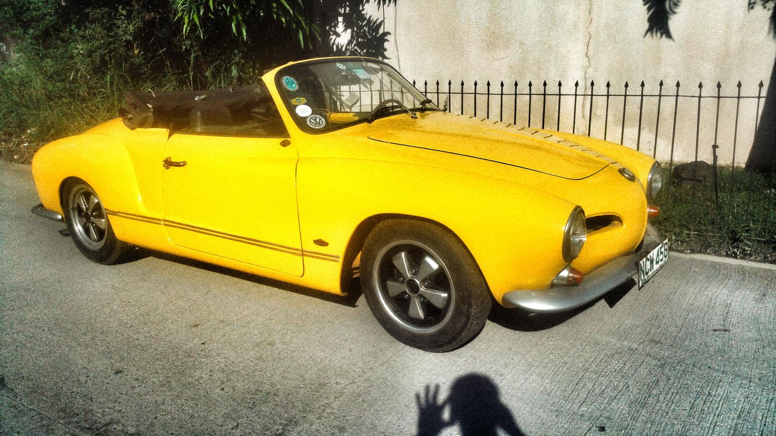

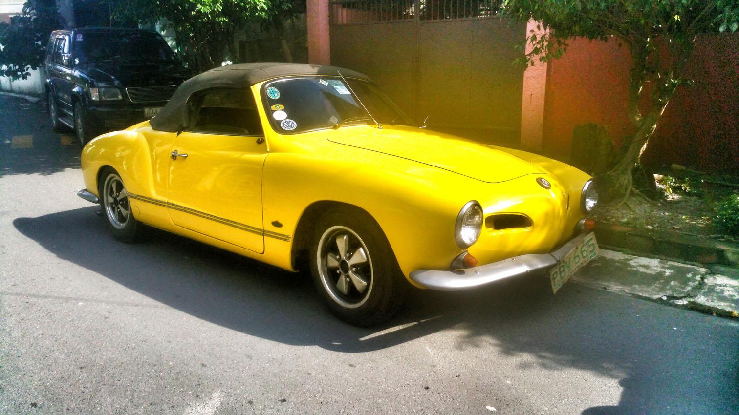

I drove the Mickey to test the engine with its dual Kadrons and the Fuchs and to determine whether there are issues that needs to be addressed.
I also photoshopped the picture. I hope I did not over do the saturation of the colors. Another view.
One more view.
Another one.
This one too.
And one more.
I like the overall look of the Fuchs with Mickey.
So far, no issues with my fear of rubber rubbing the fenders at the back. Though I have some issues on the Kardons as the smokes is color black when I apply some gas. I know that it supplies more gas then needed by the engine. I will see the jettings of the Kadrons this weekend.
And one more thing, I don't have yet the Fuchs center caps. Soon of course!

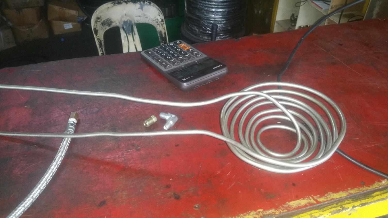

I also fabricated an oil cooler in a vintage speed theme.

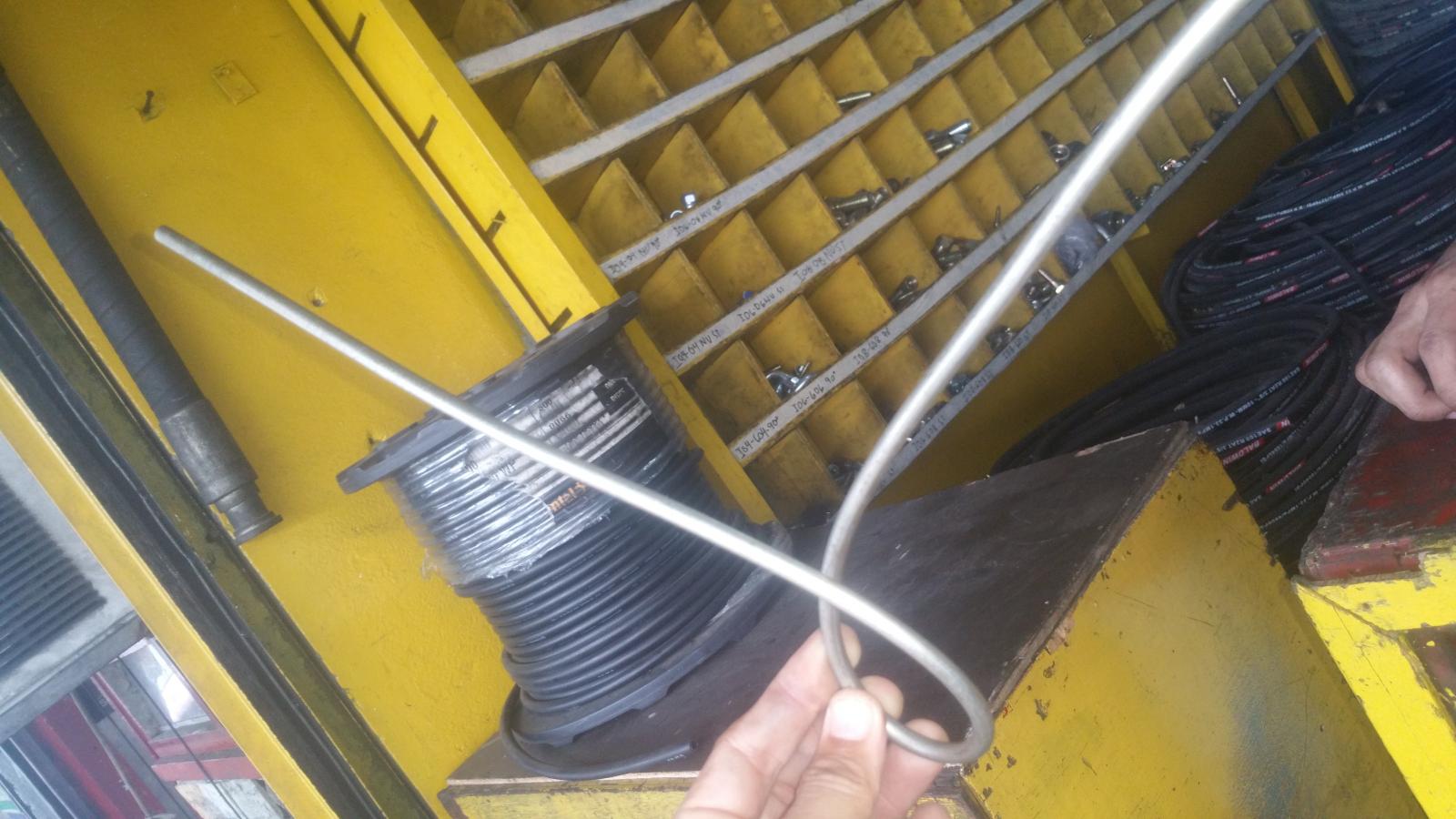

The tube that will be used to mimic the okrasa style oil cooler.
A little of twisting and all, there you have it, a spiral-like tubing.
I welded the swivel elbow fittings for the braided hose.
A view from the outside looking into the back of the engine with the spiral tubing hidden from the prying eyes.
the hose on the left is coming from the Fram canister oil filter and the hose on the right is where the cooled oil passes back to the engine.
The return. It is quite awesome because once the engine is in its normal operating temperature, touching the tubing on the right reveals that the oils is hotter and when you touch the tube on the right it is immediately noticeable how the temperature dropped dramatically. It work!

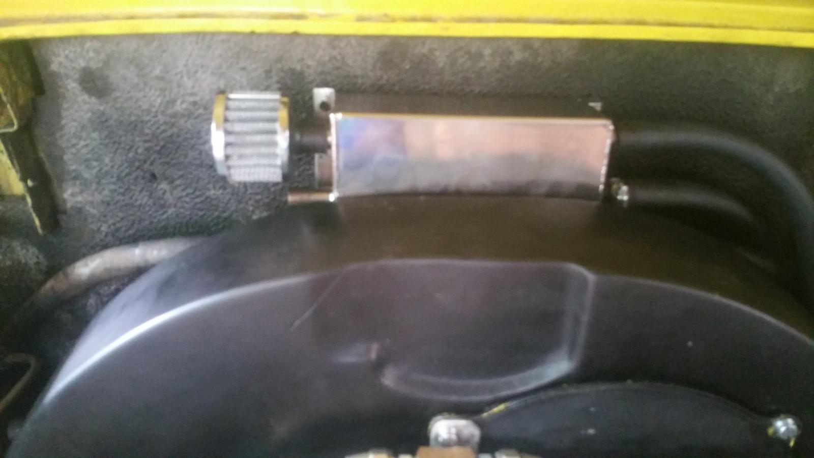

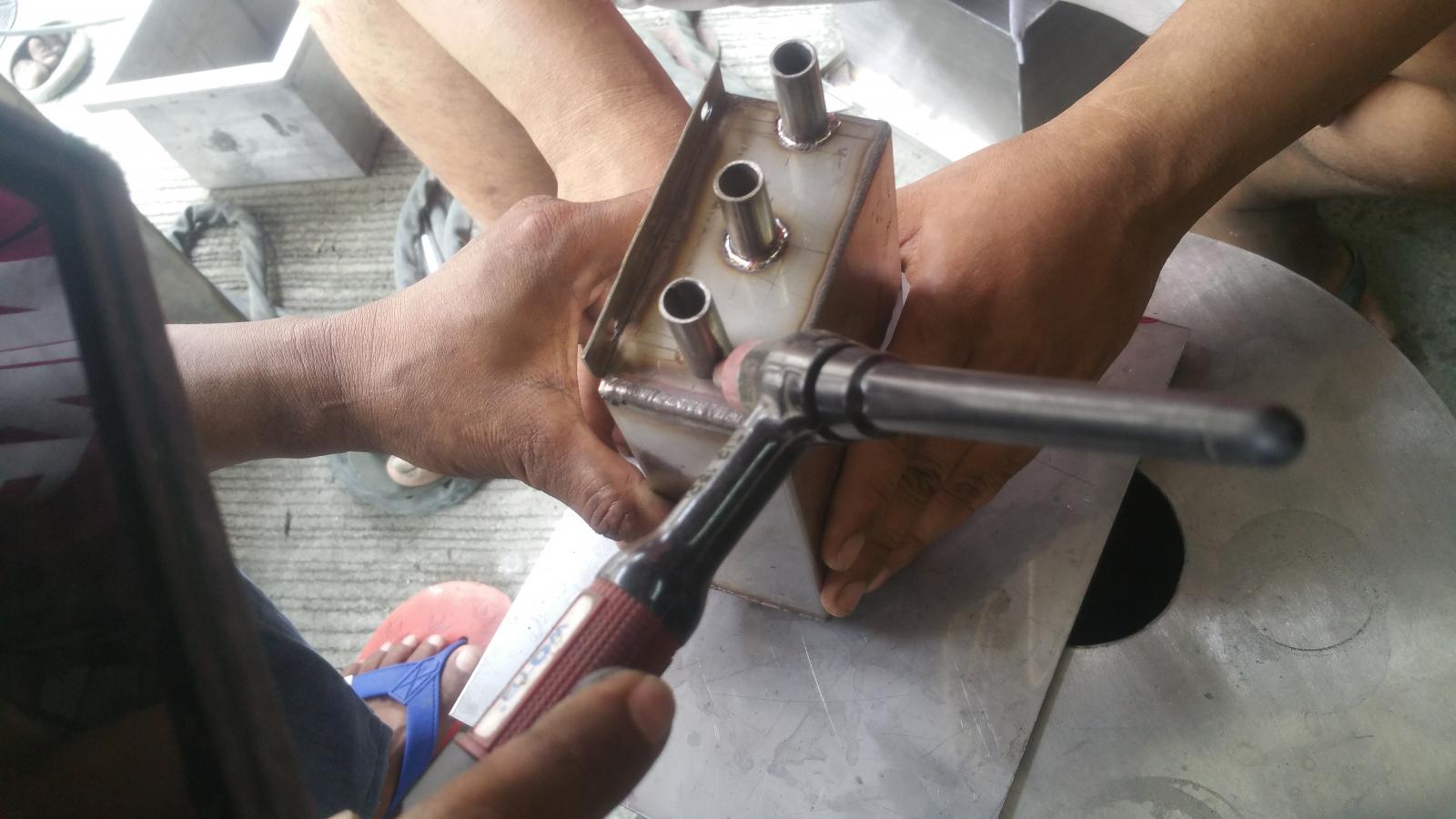

About a month ago I fabricated a breather box with the help of an expert welder.
Measuring the stainless steel sheets for the buffers and provisions for the ports.
welding the buffer using a TIG welder.
Welding the ports for the hose. I opted to install six ports, Two for the valve covers; 2 for the dual carbs aircleaner; one for the oil breather beside the oil filler; and one as breather.
Some filing touches.
Installing the finished breather box.
