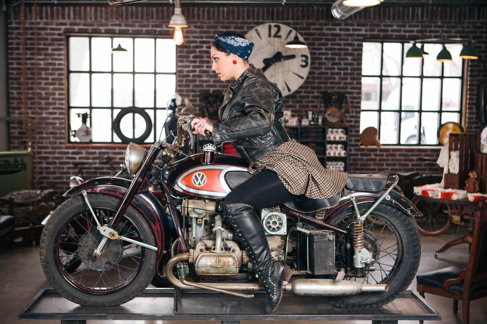

PostPosted: Fri May 15, 2015 8:19 pm    Post subject: Reply with quote
Adding picture..
Just because... well.. why not.. topic needed a good bump....
and here ya go ...one Helluva bump... Wink

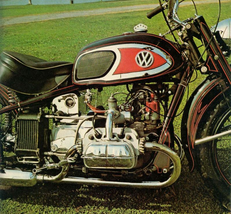

PostPosted: Wed Feb 13, 2013 1:03 pm    Post subject: Reply with quote
VOLKSWAGNUT wrote:
The Von Dutch XAVW bike, Frankly... thats awesome.
