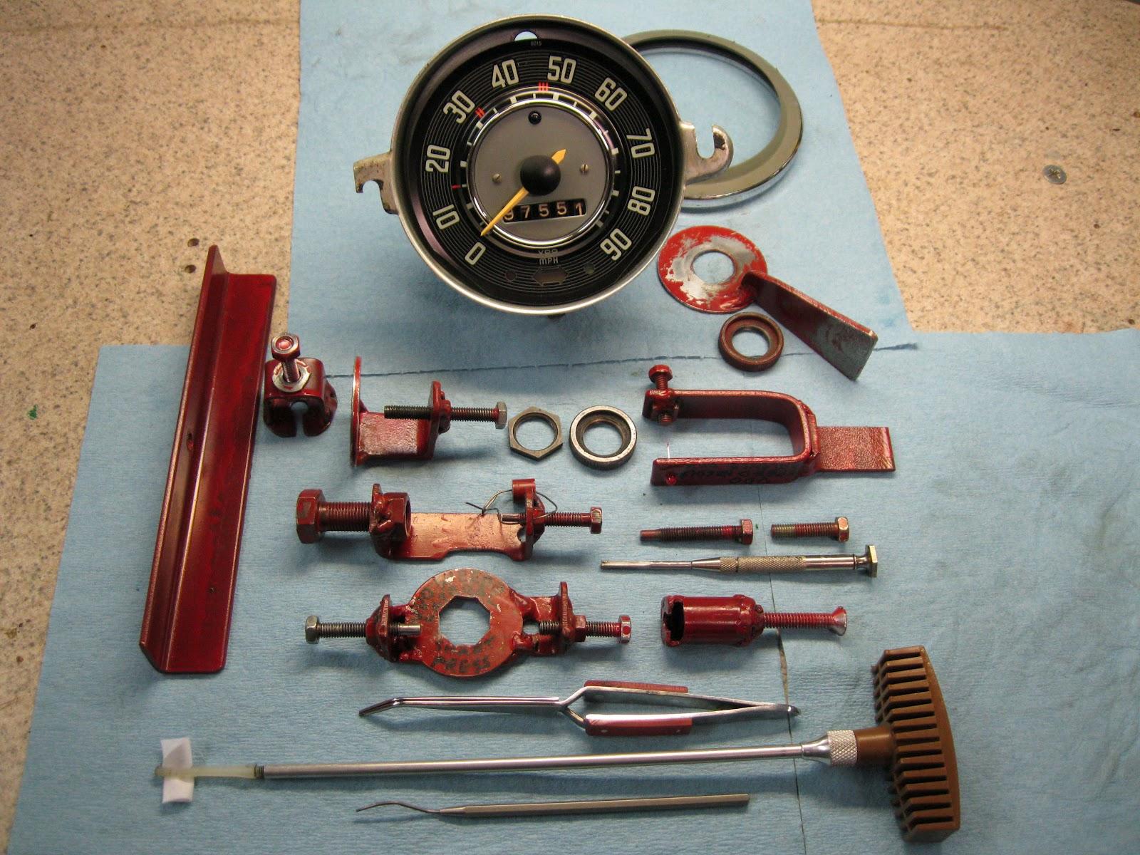

Here's the tools to remove the needle. The cutout in the "bridge" (that goes across the face of the housing after the bezel and glass is removed) Gives some space for the needle to pop off without breaking. Some of these needles are on REAL tight and take quite a bit of pulling to get them to pop off. But this setup allows you to lever pull real hard, straight up, and not risk bending the spindle. It has worked for me every time for about 4-5 years now...
Putting a new needle on? I usually just give it a light tap down with a small hammer and wooden dowel on the cone. Want to be real sure, dap a TINY (and I mean tiny) bit of JB weld on the spindle first....
Am I the only one here who finds this setup amusing?
That is a very imaginative approach. Nice work John.
I remember hearing something about using a fork to remove the needles, and came up with the bends and wood "bridge" on my own. I am told the "factory" removal tool is a steel bridge and a knuckle fork puller that you tighten a screw down on to pull off the needle. Would be fin to make, but this one works just fine.
Just hope we never have more than 7 over for dinner now........

Ok, I found the time...

I restore the clear speedos and will be happy to post a pic of the "tool" I use to pull them. However, I will say that I have yet to put an original clear needle back on. My Zarwerks parnter Jim casts them in clear resin and I always use new needles on all restos. They require a bit of finishing out of the mold, and then the white stripe needs to be painted on the backside. I use magnifying glasses to finish them, did you ever see Toy Story and the guy who repaired the dolls??? It can get like that sometimes.
I'm leaving for the holidays tomorrow AM and don't have time to get my speedo tools out and post a pic, but I will tell you that the tools are made from an old fork with 2 prongs cut off (and it is bent in a big way), a small piece of wood and a large flat blade screwdriver....
Heres a pic of a needle on a zwitter speedo.
