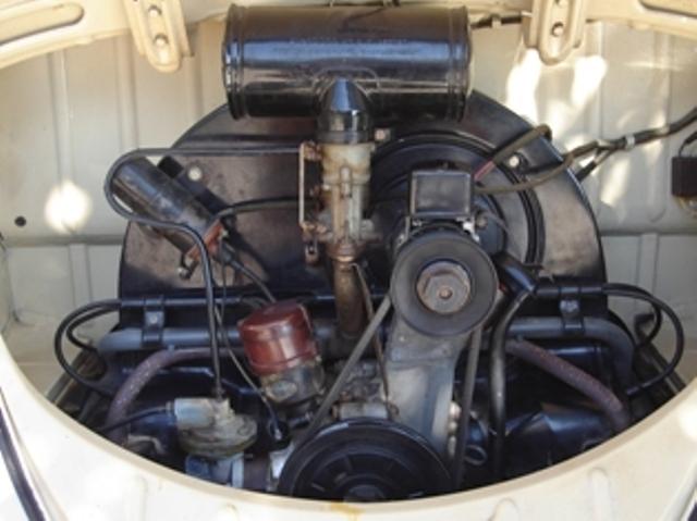

PostPosted: Mon Jan 08, 2007 4:54 pm    Post subject: Reply with quote
johnshenry wrote:
johnshenry wrote:
Heb623 wrote:
In all the years before the years before 1951 there was NO hold on clip!
Then why does the manual printed in Sept '50 show the hold down clip?
Or are you saying that there was a '51 only version of the filler, with no dimple and cone shaped filler flange and case bore opening??
PR says: 1 Aug 51 1-0278121 Oil Breather Now: Filler cap with clamp spring.
Unless we have a different PR, you typed in data from 2 different entries. What I posted is correct.
My bad. I read the VIN from the line below.... Ev is right.
John Henry
'57 Deluxe
'56 Single Cab

PostPosted: Mon Jan 08, 2007 3:24 pm    Post subject: Reply with quote
So every split beetle produced before Aug. 1st no hold down clip?
I can live with that! Atleast it wasn't me not telling the truth!!!
Twisted Evil ET

PostPosted: Mon Jan 08, 2007 12:54 pm    Post subject: Reply with quote
splitjunkie wrote:
My October 51 engine has the hold down clip.
from progressive refinements Aug 51 chassis no. 1-0272706 Oil Breather Now: Filler cap with clamp spring.
Chris
My earlier quote concurs with Everett's.
Chris

PostPosted: Sun Jan 07, 2007 5:01 pm    Post subject: Reply with quote
splitvws wrote:
. It does fit snug but I can't see it just sitting there and not coming out.
That is why the added the clip. What you describe sounds correct to me.
Chris
splitvws
Joined: February 12, 2004
Posts: 142
splitvws is offline
PostPosted: Sun Jan 07, 2007 4:42 pm    Post subject: Reply with quote
So if I am reading this correct a 50 would'nt use the clip to hold down the breather? I pulled my Feb 50 case out and the bore for the breather is straight and not coned and the breather I have has no dimple on top and is also straight where it fits in the case. It does fit snug but I can't see it just sitting there and not coming out.
Dave

PostPosted: Sun Jan 07, 2007 9:46 am    Post subject: Reply with quote
johnshenry wrote:
John Henry
'57 Deluxe
'56 Single Cab

PostPosted: Sun Jan 07, 2007 9:44 am    Post subject: Reply with quote
1 Aug. 51
Chassis No. 1-0 272 706
Engine No. 330 345
Oil breather

PostPosted: Sun Jan 07, 2007 9:37 am    Post subject: Reply with quote
In the 51-52 Tech Service manual there is no hold down clip shown in any of the pictures, nor is it mentioned in the various disassembly procedures. Anyone consult Progressive Refinements yet on this?

PostPosted: Sun Jan 07, 2007 9:26 am    Post subject: Reply with quote
John Henry

PostPosted: Sun Jan 07, 2007 12:31 am    Post subject: Reply with quote
In all the years before the years before 1951 there was NO hold on clip! How do you think the oil filling pipe stayed in than? Because the tube of the pipe was cone shaped! The engine hole to put the pipe in was cone shaped too! An oil filling pipe of a '52 does not fit in a '51 engine because that pipe IS NOT cone shaped!! A 1952 oil filling pipe IS NOT cone shapedand the hole of the engine is not either and thats why they put an hold on clip!!! Before you start to say thart I am wrong again first check one time the differences between the original oil filling pipe of a 1951 (without dimple on top) and a 1952 oil filling pipe (with dimple on top)!
And than start talking again, you will see that I gave you the correcy answer!

PostPosted: Sat Jan 06, 2007 8:55 am    Post subject: Reply with quote
splitjunkie wrote:
johnshenry wrote:
Wrong again.
There is no flare of the intake runner tube inside the endcasting on the 36 intake. The tube end is chamfer cut (inside bevel)
John, I suspect that the only one who gives a crap about this at this point is you. Bevel, flare, whatever. It is still tapered. You can split hairs all you want to try to maintain your position as the early vw manifold expert of the world. I'm sure you were up late taking pictures just so could sleep because you could not take the fact that you might be wrong.
I don't really care.
Rareair and oval53 make assertions all the time and sometimes they are wrong and I never see them go the the great lengths that you go to beat their position to death to try to prove that they are right or get all defensive.
If I make an assertion that proves to be wrong , I look at it and say "wow, I learned something" Unlike you, I don't think I know everything. I don't see this as a contest. Of course when somone approches the debate t the way you do, it just turns me and others off. Every discussion group has at least one, and you my friend are it.
Chris
You obviously care and give a crap or you wouldn't keep posting refuting opinions (opinions because you have yet to show any data that supports what you say). So that makes 2 by my count.
I am not an expert, but I have invested a lot of time with early intakes, so when someone says something incorrect about them in a public, technical forum like this, I will a) speak up and b) provide data to support my assertions. Get used to it. I don't know everything and learn new things here often.
For areas where I am not sure, or do not have data, I will always say "I think" or "I beleive", such as my first assertion that the carb riser tube was the same size, before I actually measured it (I poasted "I beleive tha the carb riser tube is the same between the 25 and 36 hp manifolds").
I am not getting defensive at all, just making sure this thread contains verifiable data so that when others come here they do not get incorrect information. This is not a debate. This is a discussion of the technical aspects of a VW engine part. There is no opinion, ambiguity. A tube is either flared or it isn't. Debate is for thing like if VW look better lowered or not.
So either look at it and say "wow, I learned something", or post some pics of your rare "flared intake runner tube" manifold and we'll go from there. Smile

PostPosted: Sat Jan 06, 2007 8:44 am    Post subject: Reply with quote
Heb623 wrote:
I keep saying that my march 1951 split window like all other early 51 or late 50 splits had no hold on clip!!!
Oil filling tube on top flat!!
Late 51 and early 52 had a dimple on top of oil filling tube!!!
Twisted Evil ET
If there was no clip, how did it stay on? I have drivin my splits an forgotten about the clip and the breather jumps out of the case almost immediately...
John Henry
'57 Deluxe
'56 Single Cab

PostPosted: Sat Jan 06, 2007 2:34 am    Post subject: Reply with quote
Twisted Evil ET

The 25 hp has a smaller opening because the end casting is smaller. There is no flair inside a head end hole on a 25 hp manifold.
Chris
