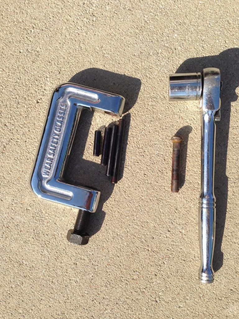

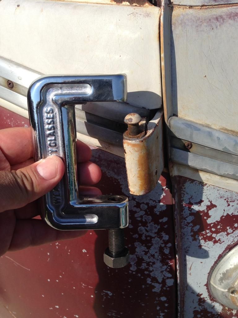

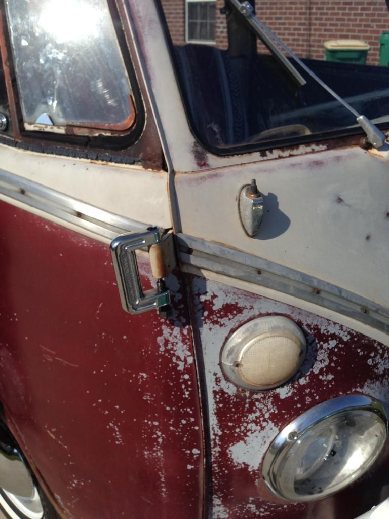

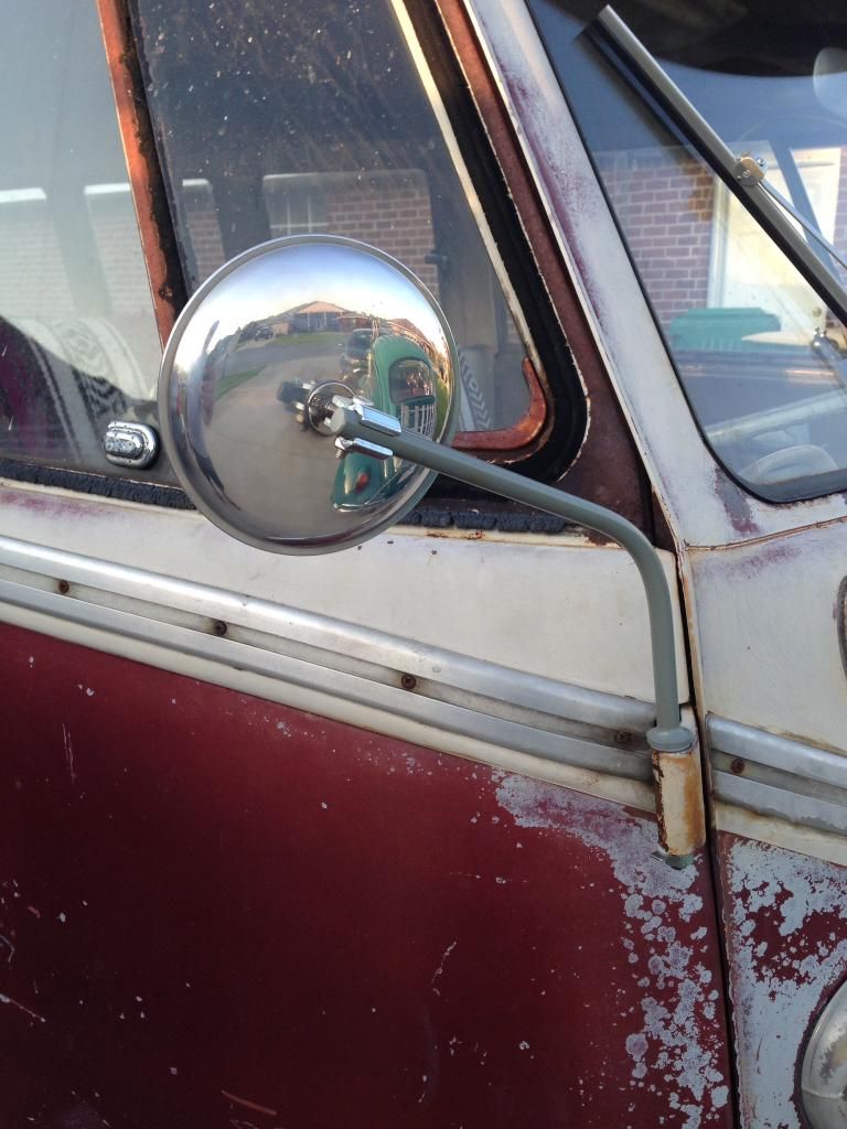

Got the tool from Bob Drake Ford today. Like I said, after soaking with PB for four days I didn't even need the tool...coulda punched it out easily with a drift. The used repop mirror I bought on here went it perfectly...real snug in the middle part of the hinge so no sag! It was a lucky job. If anybody wants to use the Bob Drake tool, I'll send it out to you. All you have to do is mail it back a week later. If you break or lose one of the four pins (you can only break them by not keeping things straight they say), just replace what you broke, or the whole tool. Chances are great the job will only cost you postage!

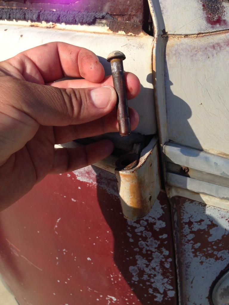

Here I am an hour later, and the pin slipped out the bottom with almost no effort. I now have the pin remover tool coming on Friday and it has nothing to do. Rolling Eyes

Here we are a few days later and the shaft is totally free, just by constant soaking with PB Blaster and an occasional twist on the Vise Grips. The pin remover is scheduled to be here Friday, and will easily push this guy out. Maybe it's my bus (doubt it as it's always been here in the mid Atlantic), but penetrating fluid and patience (time) always does the trick. Of course, not everybody has the time to let something soak forever...some do this as a job or have to get things done in a more timely manner.

I ordered this tool from Bob Drake yesterday. Thanks for the guidance. Ben soaking the pin in PB Blasterâ„¢ for about 48 hours and I can actually see/feel that it's loosening up. I have enough of the shaft hanging out the bottom that I can grab it with Vice Grips and see some minor movement at the top end. I anticipate the pin remover doing the job just as it did for you...no heat, air chisel, etc. I'll report back after the tool arrives.

This was suggested on another hinge pin thread. Needless to say, $25 well spent versus the $300+ option. 24 hour WD-40 soak and 20 minutes of my time. Addtionally, the pin puller is forged steel and will take a beating!
https://www.bobdrake.com/ItemForm.aspx?Item=TL-100
