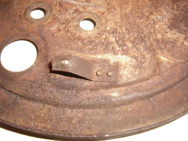

While replacing a leaky rear wheel cylinder on my '67 Bus and freshening everything up in there, new cylinders and a set of shoes on both sides, I noticed that one half of the adjuster spring leaf broke off on both sides (one adjuster star being held in place and the other not).
Okay, other than spending a lot of time trying to make some up from scratch, or locating and buying new or used backing plates in good condition, does anyone know of a source, either NOS, used or repro, of a quality replacement brake adjuster leaf/tension spring "correct" for the rear brakes on a 1967 era Bus?
I hear/understand that you can't really successfully weld spring steel to the cast housing metal (incompatible), that one could try to un-swedge the casting to remove the old and install the new spring and re-swedge, or drill small holes and hollow-rivet the replacements in. I plan to do the latter if I can locate a suitable pair of replacement leaf springs.

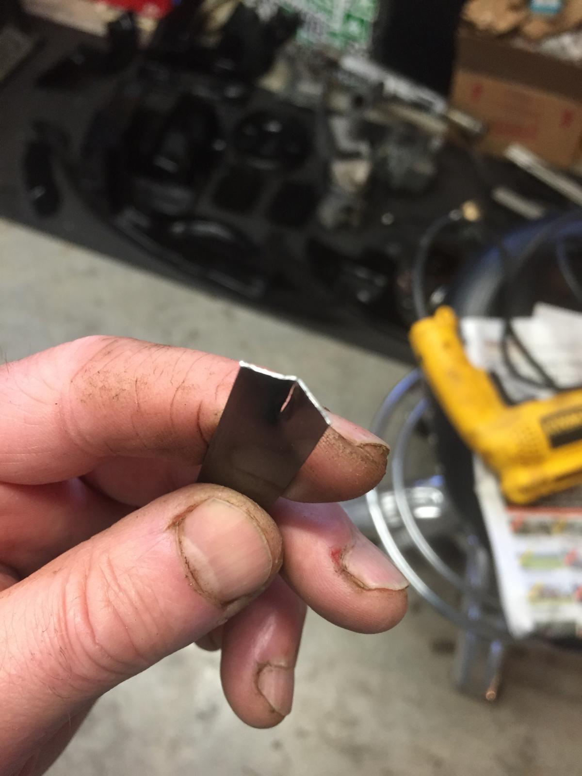

I was able to get the new fabricated piece into the old uncrimped groove, and get it solidly seated! No drilling...no welding. Very pleased. I bent the middle a little so it would decrease it's width. Then, once in the correct position I was able to use a punch and hammer to flatten it out...increasing its width, into the old groove.
How were you able to put crimp in middle of fabricated piece? Using a punch? I am having the same problem with a broken spring but I cannot get the backing plate off so I have been trying to use a punch to install the new one while the plate is still on the car----not an ideal situation.

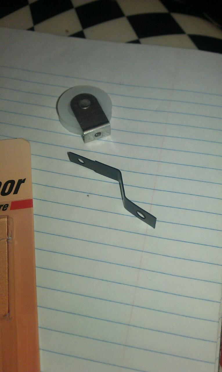

ritchiet002 wrote:
2Pack wrote:
I made some once using a strip of sheet steel from the hardware store. I attached them using hollow aluminum rivets also from the hardware store. The rivets worked well, but didn't turn out real pretty. I was happy with the fix overall. This was for front brakes on a 64.
Is the one on the left the original? Mine are a little different, but what you made should work. Nice fabricating!
Doing the front brakes on my buddy's '62 SC and the adjuster springs are rusted completely off. Went trolling through The Depot's hardware isle and found this cool little thing that is going to work great. It's replacement wheels for a screen door. Ground the rivet off the wheel mount and pulled out the tension spring.
I'll use a small pop rivet to attach the tension spring to the backing plate.

Just to add to the information somebody might wanna get out of this thread...
The spring is crimped in the channel and it's 10mm wide (50mm long as I said before).
