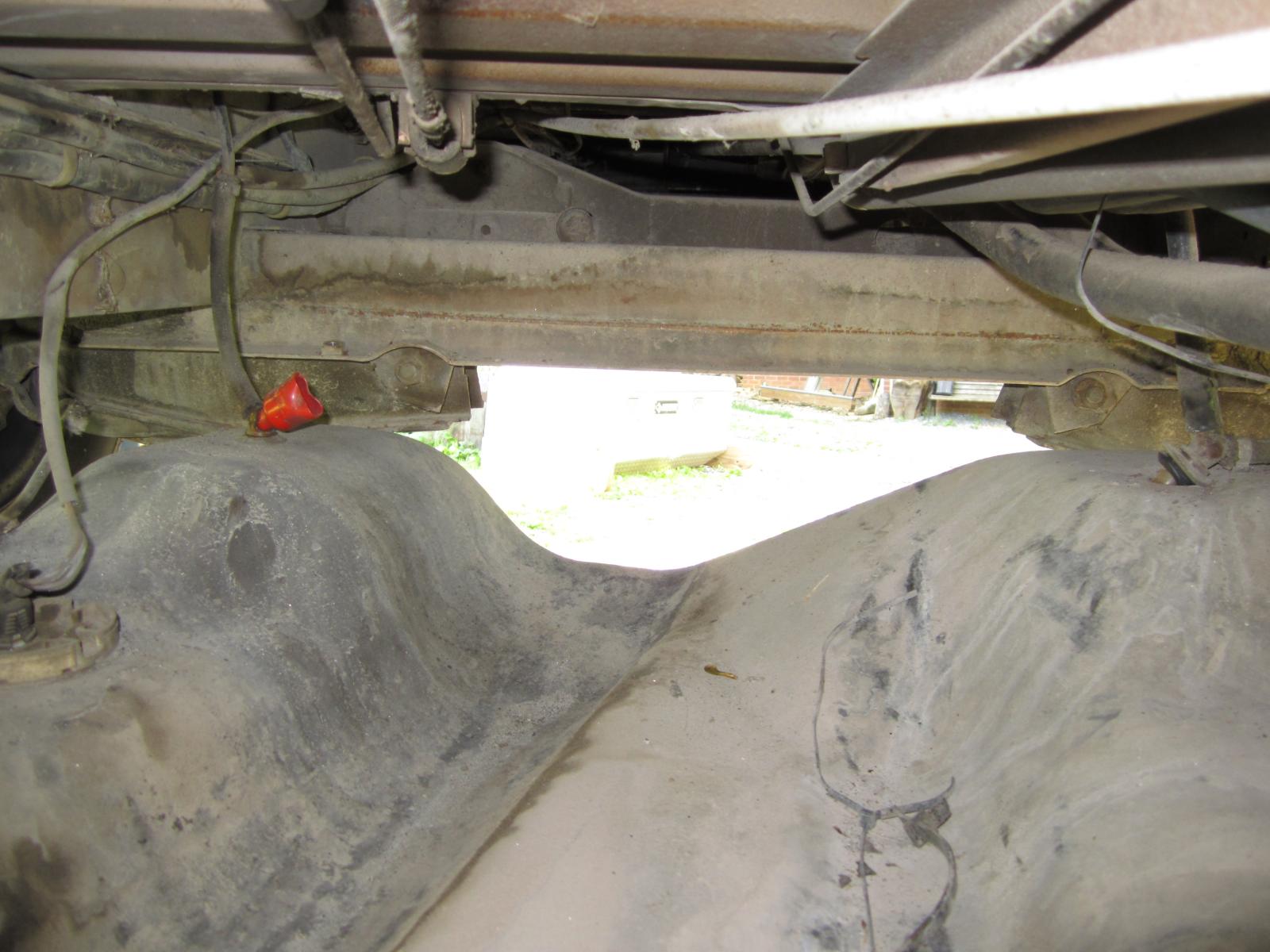

Uh. no. I m pretty sure it went up like it is in the pic. Why would it go above the shifter rod? I ll have to check some other rides to see if they ran them above from the factory, I guess!? I haven't had any trouble out of it...
dhaavers
Joined: March 19, 2010
Posts: 8412
dhaavers is offline
PostPosted: Mon Aug 24, 2015 6:41 am    Post subject: Reply with quote
Please tell us you put the crossover tube ABOVE the shifter & hoses on your reinstall...???

I completed my fuel system upgrades with great success i am confident to report at this point. I ordered Van Cafe's aluminum vent kit and their fuel lines kit with their billet fuel rails. I did all the rubber from the filler neck to the fuel injectors, so that I would feel safer knowing I had fresh rubber holding my gas in. My only issue was that several weeks after completion I smelled gas and after checking my new fuel rails, I found one wet. I tighted a clamp and fixed it. I thought I'd post a few pics to aid others.
A couple tips for share.
I used ramps for the front wheels and jacked the read and put bus on stands and had plenty of room to drop tank.
3 Irwin Quick Grip squeeze clamps (carpenter tool for home improvement supply) were really clutch to help me keep gas out of the ground. Don't pollute!
my tank coming down showing what your old lines might look like , red plug on the left is what was keeping gas from spewing on the ground at fill ups.
My tank on horses with new lines and vents. You can see I did a new sender unit and seal. Don't botch that up on install or your be repeating the tank drop...
