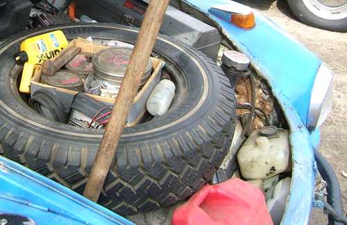

Like I said before, I ran mine without the accessory hose for several years and it was fine. I just happened to stumble across one of the accessory hoses, cheap, so I scored it.

Be aware that you don't necessarily need the accessory hose. It might earn you some style points, but you can get along just fine without one.
But whether or not you have the stock setup or the accessory hose, the reservoir is pressurized and hose runs from the reservoir to the wiper switch. From the wiper switch, another hose runs to your washer jet. With the plunger in its outward resting position, the path between the two hoses is blocked. When you push the plunger in, the path is opened. High pressure in reservoir + low pressure outside = fluid shoots at your window.

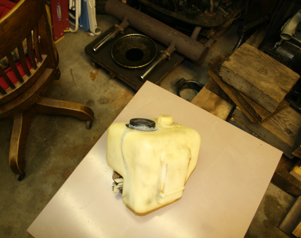

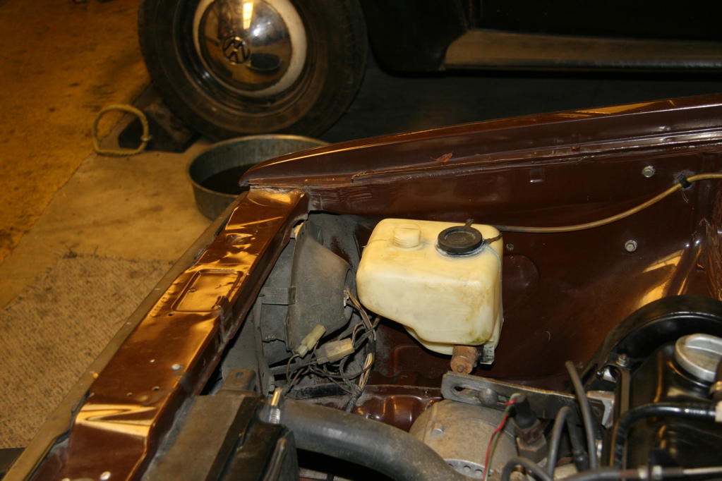

glutamodo wrote:
I think it's a REAR Rabbit reservoir. As this is in my baja and I don't have a spare in the normal location, I took the cover plate for the steering box adjustment, drilled out the welds for the Rabbit reservoir's slide-in body mount, then put some holes in the that steering box cover plate and bolted that mount up there. So it sits at a slight angle, but it still works good. And access is pretty easy.
Looks like the same one to me.
(Not connected because it doesn't hold fluid.)
For those curious about the slide-in body mount, here's a more illuminating picture (I didn't think to take a picture of the metal mount on the body, though):

snj wrote:
The Rabbit reservoir (at least the one on a '79) has a rather strange shape. How did you mount it?
Very good question. I didn't state everything - I think it's a REAR Rabbit reservoir. As this is in my baja and I don't have a spare in the normal location, I took the cover plate for the steering box adjustment, drilled out the welds for the Rabbit reservoir's slide-in body mount, then put some holes in the that steering box cover plate and bolted that mount up there. So it sits at a slight angle, but it still works good. And access is pretty easy.
