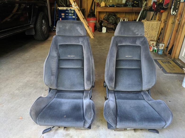

No, they won't work with the GW brackets without a lot of modification. Those are manual recaros. The base is different than the electric ones (electric tilt for the seat base).
There's no easy way to adapt those, and if you did, it would probably be impossible to keep the tilt. If you found electric LS bases, you could bolt those seat backs to them though.
Bummer, but those are still great seats for someone with a mk2. edit - good you didn't buy them yet.
You can tell they're manual by the way the center cushion sticks out past the side bolsters on the base, and more obviously by the handle on the front corner of the seat. Center handle is for sliding them back and forth and will be there on the electric base mk2 recaros too.

connorsvw2 wrote:
These look great! I think I have an opportunity to buy the same seats as you:
From reading here and on GW it seems like I should be able to use their Recaro <> Vanagon seat brackets to install these in my 81 Vanagon.
This is what I would expect the underside of the recaros to look like (from GW's instruction video):
https://i.imgur.com/qElxZka.png
But this is what they actually look like underneath:
As far as I can tell, there's nowhere to attach the bracket.
Does anyone know if these will work with the GW brackets?

Just installed these this weekend after much delay (needed new bolster foam and extensive rehab of drivers side seatback fabric). Used Go Westy adapters modified for these Mk2 GTI/GLI seats. The VW recaros use M8 bolts (Go Westy kit has all M6 hardware) to secure the tracks to the seat base, so I needed new 12.9 M8x30 mm bolts, washers and for the drivers side, combo steel sleeves from hardware store (1/8 and 1/2 inch by 5/16 ID) to lift up drivers seat to stock height per Go Westys instructions). Also needed to open up mounting holes in the upper track to fit the M8 bolts. Pass seat needed no lift on the swivel base I also installed.
So far very pleased with position and flexibility, as seats have infinite vernier tilt adjustment and tilt forward with a tug on the lever. I'm not sure how I'll like no armrests but hope the comfort will more than make up for this.

Got my seats in, no modifications to the seat or rails at all, just made adapter brackets. Seat height is perfect, very comfortable and they look great.
The front of the rails capture an m6 nut perfectly and the rear fits an m8
