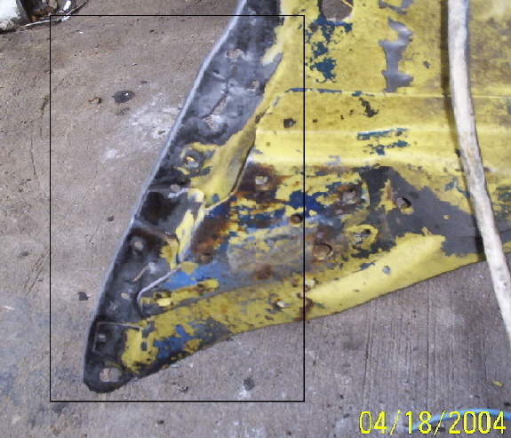

Here's a couple of pictures that you can use to help you find the spot welds:
John
John

Check out page 8 of my "gallery" images on this site. I have some pics or rear apron replacement.
Example... this is where the spot welds are drilled out
There are also many threads on this in the paint and body forum.

Yes. Once you remove a fender, look close to the edge of the apron, and you'll notice little round "spots' in the metal. They will be the spot welds.
I counted around 9 or so spotwelds on the left side rear-lower quarter panel (for rear apron) on my '74 project. There is also a little braze-weld at the top part of the rear apron to quarter panel.. (Hope this explanation is clear enough!).
