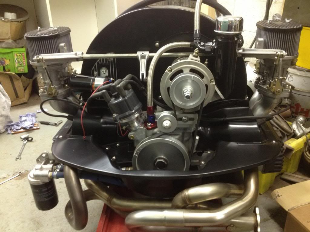

who built it?looks great,pull relief plugs seperly&see what you have,do they both flow oil oit? has the front relief had a screw in gally plug instaled where the relief gally is drilled?

splitmaster
Joined: September 02, 2007
Posts: 18
splitmaster is offline
PostPosted: Sun Jan 19, 2014 6:08 pm    Post subject: Reply with quote
Checked both prv valves there ok there is a gene berg oil pump fitted not a melling at first it was blowing the oil fillet seal so I fitted a hp1 now this time it has not blown the seals in the oil cooler it split open the oil cooler .
Any one got any ideas
