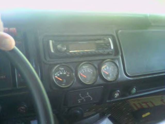

All VDO
75 type 2 http://gusc1.tripod.com/1975vwtype2

One thing that I have noticed is that VDO has changed the method in which the gauge secures itself on the back. They had a metal secure bracket on the back which was held on with two small metal nuts and now are moving towards a plastic screw on sleeve that when in tight spots does not work well. So if you mount the gauges under the radio in the dash the plastic sleeves then to bind with the ashtray making the sleeves useless. So if your looking to install gauges in this area you might want to find an older set.

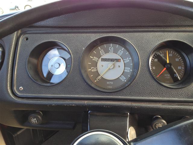

PostPosted: Sun Feb 12, 2012 6:36 pm    Post subject: Reply with quote
srfndoc wrote:

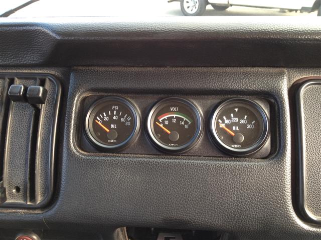

That's probably the nicest, cleanest, basic gauge installation I've seen. A lot of them end up there but yours doesn't cheapen the looks by hacking the dash.

PostPosted: Sun Feb 12, 2012 5:19 pm    Post subject: Reply with quote
Here's my setup using the Busboys adapter for the tach in the clock hole and oil press/time/voltmeter in the radio hole:

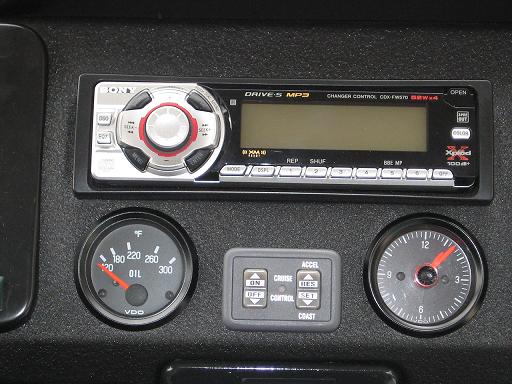

We all have personal music machines? Speak for yourself.
They're not stock. Wink
jtauxe wrote:
GusC2it wrote:
I like this idea of using the space for the now-obsolete radio/music player for gauges. This precludes having to makes holes in the dash. We've all got little personal music machines now, anyway.

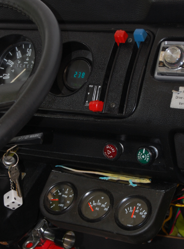

Jeff, you have enough gauges to require a passenger to read them all!
My wife would drive me nuts with her "Ohh, that isn't right!" with her looking at all the readouts. Laughing

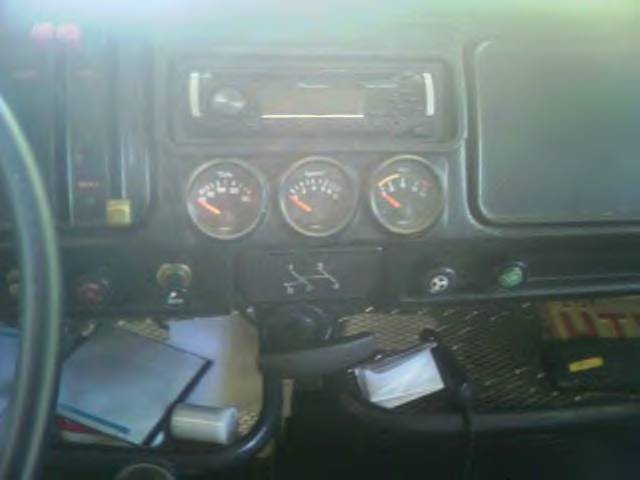

The Oil temp is adapted from an Audi Fox water temp gauge. I recently also added a vacuum gauge.

Here's my gauge setup.
The CHT in the main cluster. and the three VDO's on an extension I made so their visible looking down under the steering wheel cross arm. I thought that the VDO's looked nice all together and the same size. The digital LED looked out of place with the black face gauges.
I figured with the CHT right out front that I wouldn't be as easy to take my eyes off of the road. After a while I hardly look down.

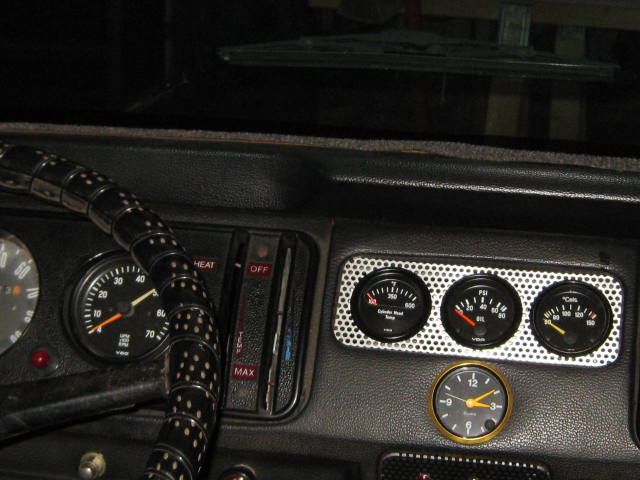

PostPosted: Sat Jul 12, 2008 10:06 pm    Post subject: Reply with quote
markd89 wrote:
Does the laminate overlay the existing plastic that holds the speedo, etc or does it replace what's there?
If a vendor made this part, in black plastic, I would buy it!
Mark

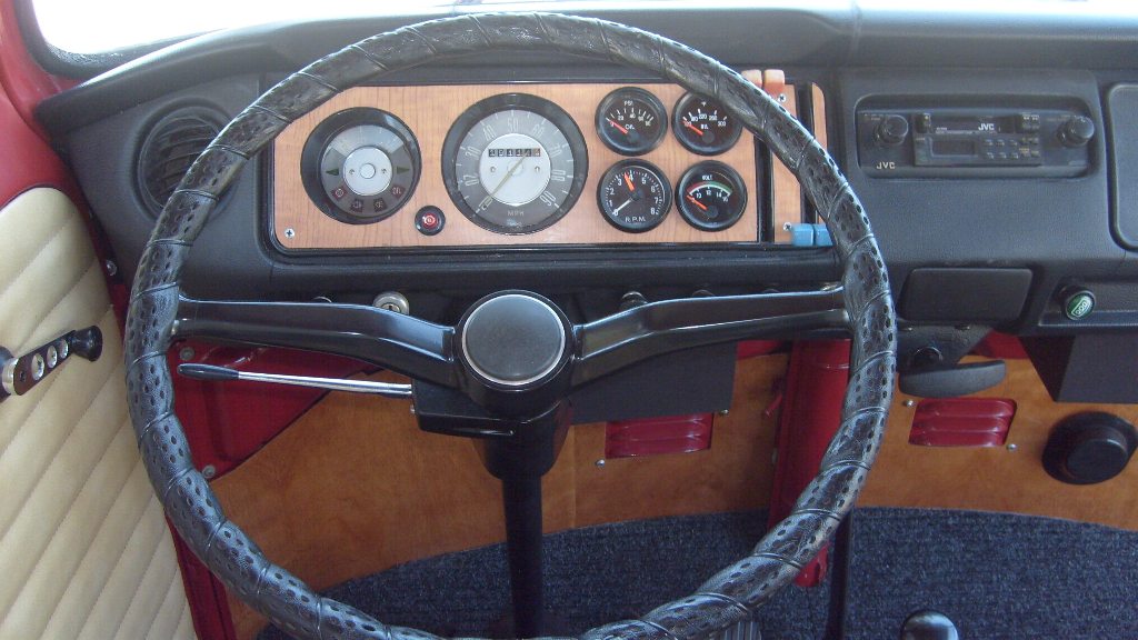

Yes the Westy cabinet laminate overlays the existing black plastic. But the right hand 1/3 of the console was pretty much removed to get rid of the clock recess and clearance for the new gauges. I had looked all over to try to find some nice black laminate or formica. No sucess.

PostPosted: Sat Jul 12, 2008 8:13 am    Post subject: Reply with quote
Desertbusman wrote:
NOVA Bus wrote:
Looks like everyones utilizing the same spots for triple gauges.
Here's where mine are.
I like the look of this Smile
