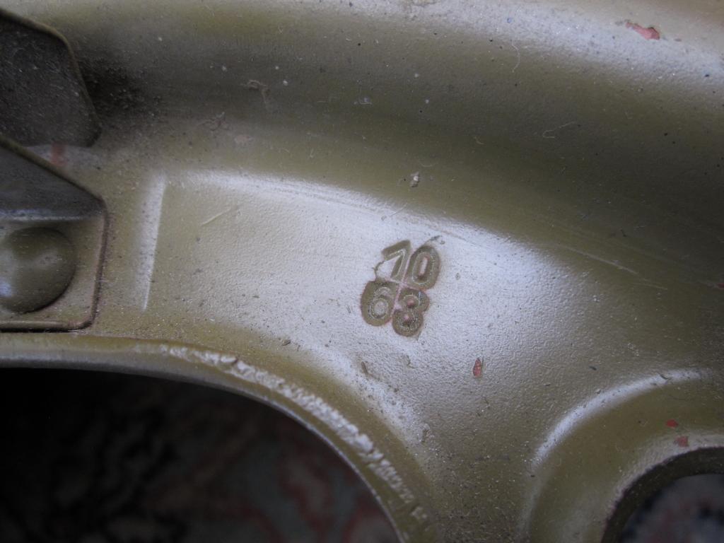

PostPosted: Mon Mar 05, 2018 2:07 am    Post subject: Re: 16" wheel question Reply with quote
the color makes it look military surplus. BD correct specs.
In any case, please do save the Firestone Phoenix. gorgeous tire and worth saving for display. out of production for 50 yrs.
it seems as if it is a 5.00-16 though, which would be the split beetle size.
interesting that the wheel rim has what looks to be the deep square indentation at the valve, meaning it is made for use with tubeless tires. I think og BD era wheels just had a shallow recess for properly seating the tube's valve stem.

PostPosted: Sat Mar 03, 2018 2:28 pm    Post subject: Re: 16" wheel question Reply with quote
sled wrote:
looks like 10/63 to me
Yep

PostPosted: Thu Mar 01, 2018 6:56 pm    Post subject: Re: 16" wheel question Reply with quote
drive your split.

PostPosted: Thu Mar 01, 2018 4:47 pm    Post subject: Re: 16" wheel question Reply with quote
Is it dated 1968?
Barndoor Bus but later replacement production?

PostPosted: Thu Mar 01, 2018 9:23 am    Post subject: Re: 16" wheel question Reply with quote
What car is this rim for?
Markings: Lemmerz, 3,50Dx16, 1647, "Horse"
Thank you
