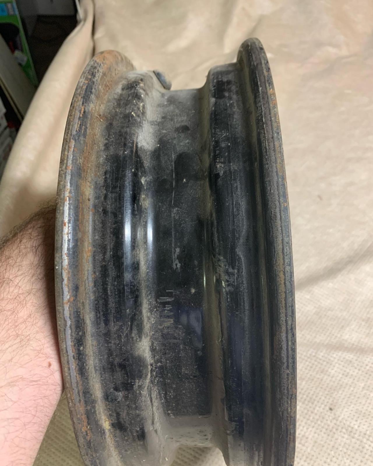

I was wondering if someone could help me with this one. Scored it today. Has the correct dimensions and is VW stamped. Missing any date code, says ‘T’. Resprayed. But again, is stamped and the correct dimensions. 15 inch by 5.

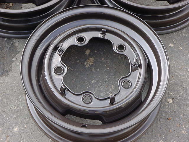

It looks like a beetle wheel. There is a date stamp on there, sometimes they are hard to find under a couple of coats of paint. The date stamp is usually not as pronounced as the VW stamp.

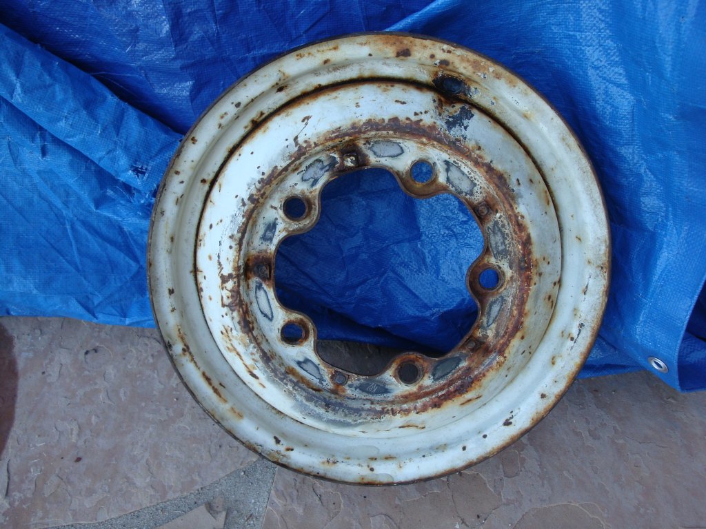

EmpiGT wrote:
Looks like a bug or ghia wheel.
I thought that also but that valve stem location is odd.

I have this 15" wheel with the valve stem on a lug hole, no slots, 4 inch wide, VW stamped, and with a date code that appears to be 6/55 (maybe 65?).
Smoothie with a valve stem on the lug hole?
Ideas?

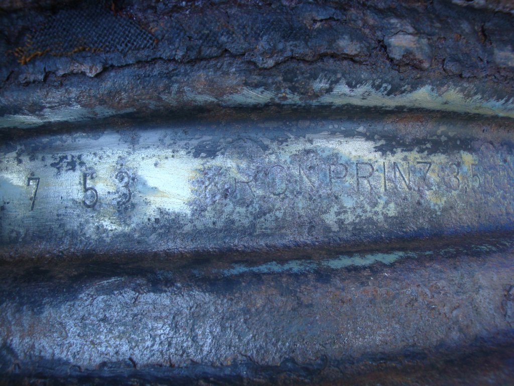

I've pulled the hubcaps, and one of the front wheels is 9/58, and the other one is a crows feet one. I guess that confirms that they're not original to the vehicle.

I would say they should be 14" but it's not impossible that they were using up old stock since you are so close to the change-over date.
Check the date stamps on the wheels. If they are all 1-2 months before the production date of your Bus I would say they are original.

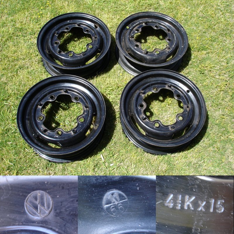

Date stamp
