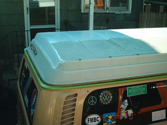

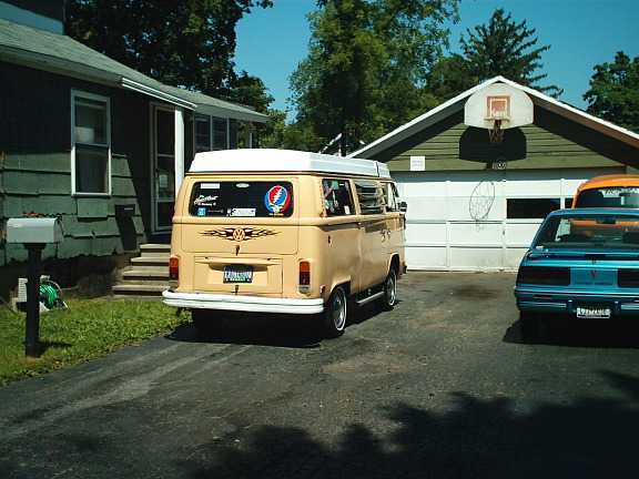

<< Or for about $15 worth of materials and a couple of hours, you can do the exact same thing with Rustoleum High Gloss enamel, available at any home improvement store for about $7 a quart. I did this with my '79 4 years ago. Still looks like the day I did it. >>
You know, I initially considered just using a rattle can of some sort but figured it would not fill in the roughness of my worn top, and might chip easily, or flake off, or crack as the top flexed,. If the rustoleum has held up for 4years I guess my figuring was wrong. Oh well, I suppose I probably put in a few more evenings on this project then needed then but there are worse things I could have done with my time......
VDubTech
Joined: December 29, 2002
Posts: 9156
Location: Syracuse, NY
VDubTech is offline
PostPosted: Wed May 14, 2008 9:02 am    Post subject: Re: top refinish going well, interlux works! Reply with quote
harpua wrote:
Anyway, if you are driving around with a weather worn, dirty, moldy top I can tell you that for about $100 in material (2qt.primekote, 1at. brightside, misc. sandpaper, foam rollers etc) and probably 15hrs. of elbow grease you can totally change the look to shiny and new without needing spray equipment
