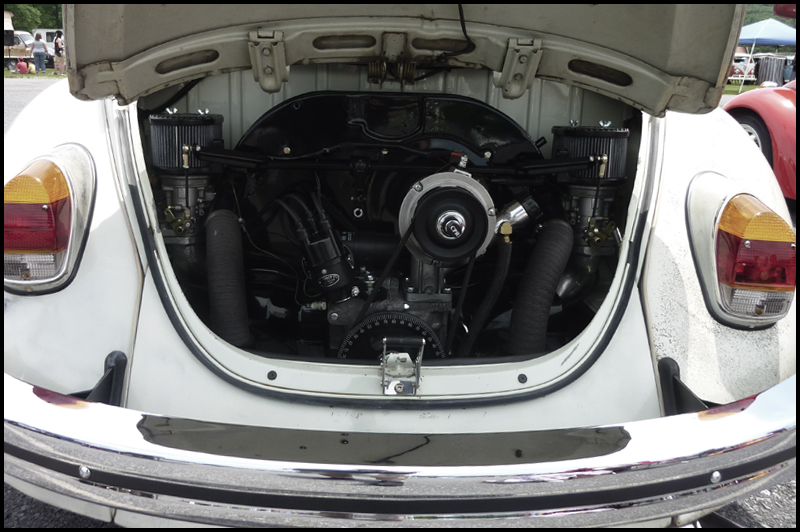

somdair-coolers
Joined: January 11, 2009
Posts: 112
Location: Mechanicsville,Md
somdair-coolers is offline

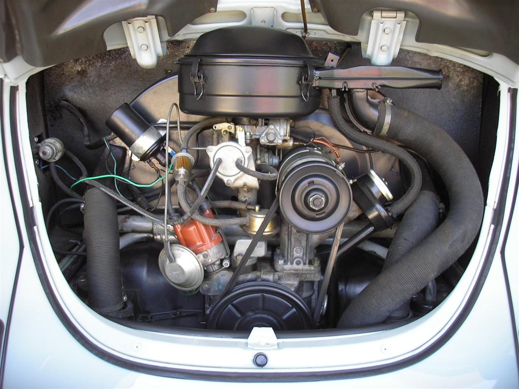

PostPosted: Sun May 31, 2009 5:16 pm    Post subject: Reply with quote
BigAlVB wrote:
No, not a "big honking turbo setup" but this:
It clears already, as you can see from this pic it needs the top standoffs due to the radiator fill tube:
Just wondering if there would be any benefit for more air in/out with a lower standoff?
Does anyone have any pics of a bug with both upper and a lower standoff installed?
Since noone has asked, what is that engine from?!??
scott s
Joined: January 04, 2005
Posts: 1141
Location: Rock Hell, SC
scott s is offline
PostPosted: Sun May 17, 2009 3:49 pm    Post subject: Reply with quote
The local NAPA ordered them for me. They're actually for an Opel GT. Somewhere in this thread is the year and/or part number. I thik they're for a '74 or '75 Opel GT.
Nice compromise between ride and handling. MUCH better ride than the "normal" KYB GR2's that everyone sells for the VW.
