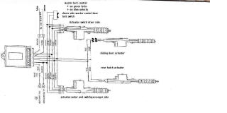

singler3360 wrote:
Where would the recommended leads be in this area to tap into for 12V constant and ignition switched power?
Ok, on futher inspection, I found the extra constant power tab at the far left backside of the fuse and an ignition switched on tab on the far right. I think I'll run dedicated 16AWG wires from those locations over to the glove box area rather than tap into existing wiring.

The whole shebang fits nicely up behind the glovebox, and I tapped my power directly from the fusebox.

I'm installing the A1 MES power lock kit. Can someone post pics of the electrical contacts on the b-pillar and the door itself? Before I drill holes for the contact plates it would be helpful to know where the stock locations are.
I think the best place to locate the control modules (incl. the keyless control unit) is behind the glove box. Where would the recommended leads be in this area to tap into for 12V constant and ignition switched power?
And finally, there appears to be a good writeup for this install here but the link to is broken. Anyone know how to get to this archived article?
As always, thanks!
