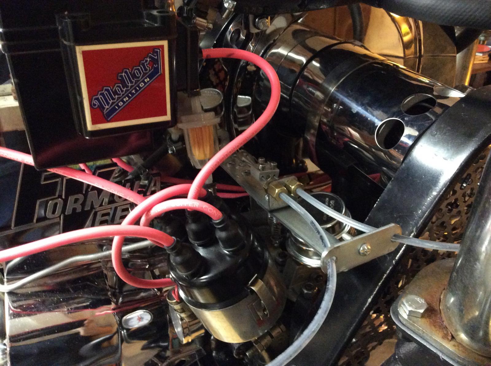

Hi I just got done building my 40 hp motor . For my vanguard bobsy formula vee car . I just installed a vanguard dual carb kit on my 40 hp motor here is some pictures of the set up.
