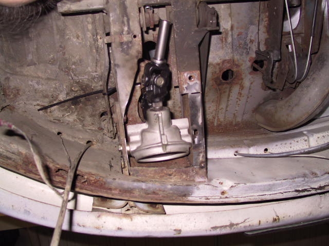

PostPosted: Thu May 21, 2015 12:10 pm    Post subject: Creative Engineering steering rack just fitted. Reply with quote
Hi,
I think the original question on here was has anyone fitted one of these Creative Engineering racks. Can't believe this thread started 7 years ago and nobody has answered the original question! Very good thread though and very useful to me in deciding what to do regarding steering upgrade so thanks to everyone. I bought the CE rack kit yesterday and fitted it today.
Why did I choose the CE kit. Yes its expensive, but its all brand new with the majority of the components manufactured specially for CE (including the rack itself and the bevel box, new steering column etc). Some of the full rack systems people have done do look smart but for me putting something on the bus that I carry my family around in meant i wanted a well made bit of kit. The CE kit is also pretty much a bolt on system (bit of cutting required to edge of one chassis flange, plus drilling holes). The kit is very solid indeed. Clearly very well made when you first see it. Its also got great ground clearance (not that I need it running stock height) which is also good to have. For me, the peace of mind in having a solid purpose built kit was worth the money compared to the nagging doubt at the back of my mind whilst travelling at 70 mph (stroked 2200cc engine) down a motorway that some component or weld I had made was not quite right. This thing is keeping the bus and my kids on the road after all. Also I intend to keep this bus for a long time and that helps to justify the cost too. I really liked the design. All of the separate parts are mounted on one steel plate which effectively buids up to be one item that mounts onto the chassis in so many places its solid as a rock
So, my steering box was shot and very worn. 4 to 6 inches of free movement at the steering wheel. Not good.
Fitting the CE kit was straight forward, though I had to cut and re-weld the outer steering column cover mount plate due to the fact the floor in my bus was higher than it should be by half inch. Other than that its a piece of cake.
Yes, you lose the horn function in the centre of the steering wheel (although the parts remain same visually) because the new inner steering column has no hole bored into it. The column goes straight to a UJ under the floor anyway so it could not take the horn wire anyway even if the column was bored as it would get tangled. I just put a period style push button on the dash. looks fine. The inside of the bus looks identical to before, just the horn doesnt work.
My bus used to wander all over, constant correction, with nervous times passing vehicles at anything over 50mph. Impossile to keep in a straight line. Country lanes were equally worrying. Been on an hour long drive this afternoon and the new kit transforms the steering. There is no free play in the steering wheel, with immediate movement of front wheels from any movement on the steering wheel. 70+ mph is no problem any more. It was windy here too today so the bus was getting blown around but none of the slackness I had before. It just feels completely solid (for a box on wheels).
Would I buy this kit again? Yes, without a question, and I would recommend it to anyone with a shot steering box.
People have pointed out it is just replacing the steering box with half a rack. I understand this point, but the thing is so well engineered that it really is up to the job. I have a split pickup too with a very good steering box on it and this CE kit is infinitely better than that. A rack is always going to be better than a box. Realistically, if all your track rod ends are in good nick they will have NO loose play in them anyway. The one weak part remaining is the idler pin mounted in the beam which the full rack systems shown on here remove. As long as this pin is a good tight fit with no slack in it there really should be no more slackness in the CE system than the full racks people have done.
Hope this helps, and if you want to ask anything let me know because its all still fresh in my mind!

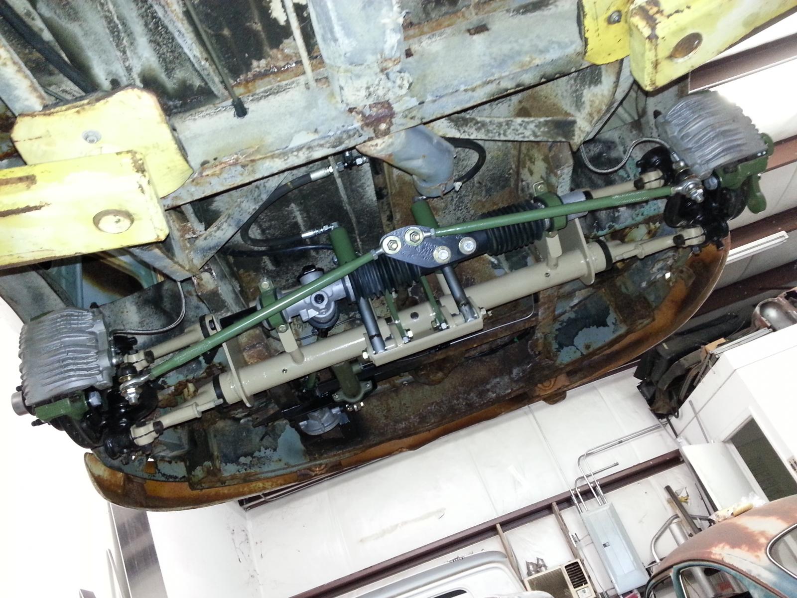

PostPosted: Tue Jun 24, 2014 10:26 pm    Post subject: Reply with quote
Looks clean Harold, as expected!
Look forward to more info on your d.c. homepage. I suppose we will have to wait till you build your turbo engine to get a road report.

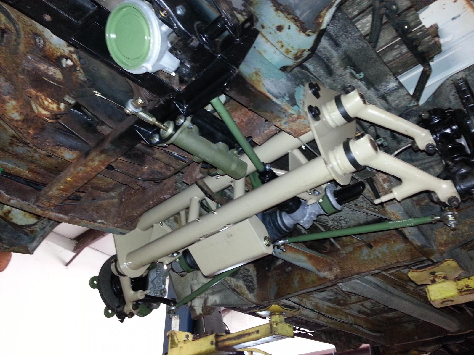

PostPosted: Sat Jun 21, 2014 3:24 pm    Post subject: Reply with quote
Finally got the 911 steering rack conversion done. I was able to delete the U joint at the steering box, what a pain. Will do a write up on my bus page. The turbo tie rods for the '65-'68 911 will work.
