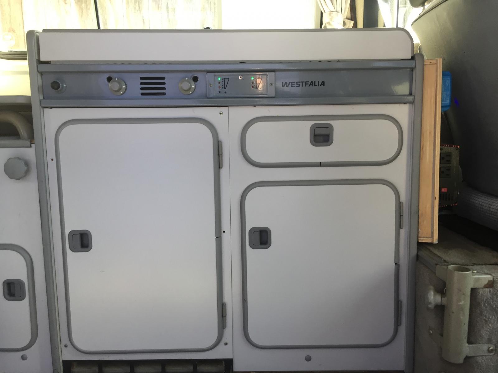

The powder coat and silk screening described in this thread sounds nice but it also may be a lot of work for not much added value.
I removed the kitchen faceplate, sanded down the rough spots and feathered the edges where the paint chipped, painted it with rustoleum and applied stickers bought from GW or vancafe.
I used gloss smoke grey. Most folks use satin but I like the shine and easy cleaning of the gloss. Folks also use a number of different greys from rustoleum or SEM. There's a thread here with examples of different colors. I've seen some orange or red paint that looked good too.

I sanded and painted my stove front with Rust-oleum and then added decals from GW. Itks been a half a year and it still looks okay to me...
Painted the base of the battery powered stove ignitor so it blends in a bit better...
Rust Oleum Gloss Smoke Grey. It's close enough and has an added plus of reminding my of the grey color paint used to paint machines in my dad's machine shop...

FYI: you should be able to find a powder coater locally to do the job.
I had mine powder coated locally. I picked a close colour match off their samples and for $100 Canadian (around 75 usd)I had the stove front and table pipes, brackets fridge grills, and stove lid parts done.

The RAL powder coat numbers are
BROWN = RAL 8028
GRAY = RAL 7037
