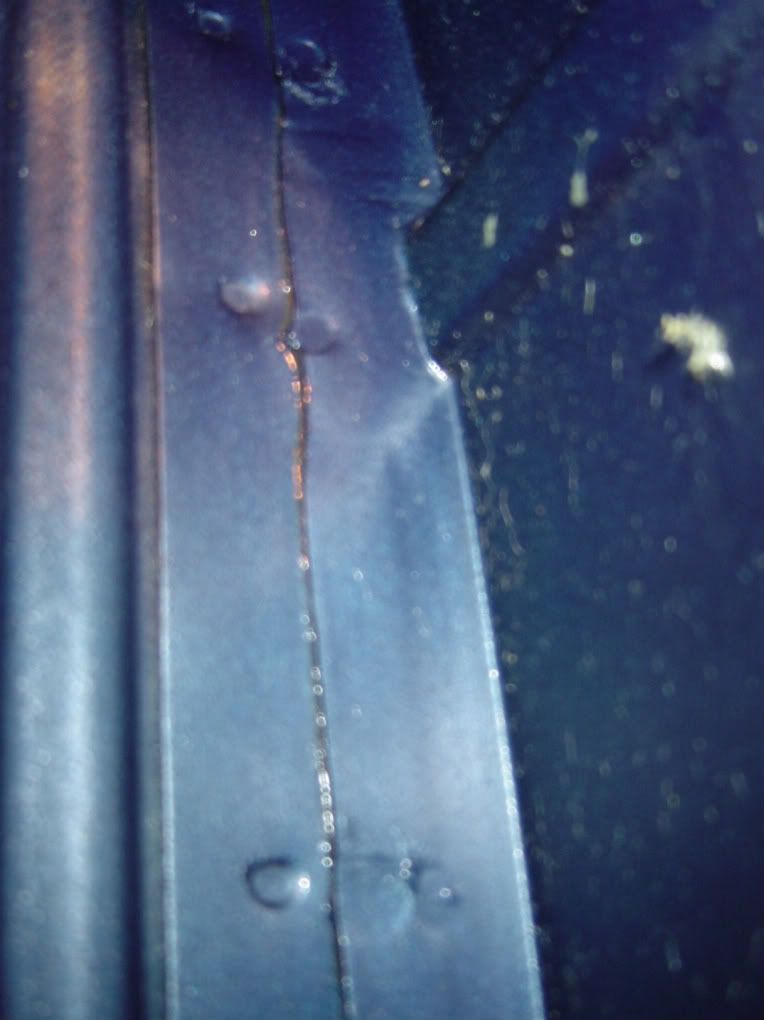

insyncro wrote:
How do you plan to address the exterior of the seams now that the interior ones are sealed up? If they are cracked or split, water will be able to get in and sit, not good. These are flexible joints that will open at some point from flexation of the chassis during normal usage. They were designed that way. If the rust is is showing on the interior, no matter how small, it has affected the seam and is working its way out.
I appreciate your efforts and don't want to see the rust excellerate due to the interior seal and no exterior seal. You have a beautiful van, no doubt there. Just want to see it stay that way.
dylan
Hi Dylan,
You are completely right and I've been thinking about this since the day I saw water coming in. Fixing the seam from the inside only solves one problem, you stop water from coming in but the water still gets to the seam. I have to say that I didn't see any rust in the seams, the only rusty spots I treated were in flat surfaces of the lip of the bottom seam panel (imagine where water would end up after runnning down that vertical seam in my pics) and they went away at the first pass of a wire brush. This is a Cali van. However, sealing the seams from the inside will accelerate or prime the rust process.
The only way to permanently fix those panel seams is to take the seam sealer off and do them all over again. But this is another big project I'm not ready for yet since I'll have to use a mini sandblaster or similar, seam sealer, masking, painting etc. I'll take care of that when I do a full body paint to restore the exterior of the van.
For the moment and, since it's almost summer around here I'll do a nice exterior body wax job making sure the van has been cooking in the sun for a while before the waxing job. I hope that the cooking will get rid of any moisture in the seams before I apply the wax. Then I'll make sure I hand wash my van as little as possible through the summer (not much rain around here) and before the rain season starts again I'll re-apply wax on the exterior. No need to wash my van in the winter. This is just a temporary fix until I can take care of the seams once and for all.
I'm open to any suggestions so if you think there is a better way to do this please tell me, I'm all ears Smile

PostPosted: Fri Apr 03, 2009 6:23 am    Post subject: Reply with quote
dylan

all right, so before I start losing all the pictures and forget how I did things, here is a brief description of my winter multi-project coming to an end.

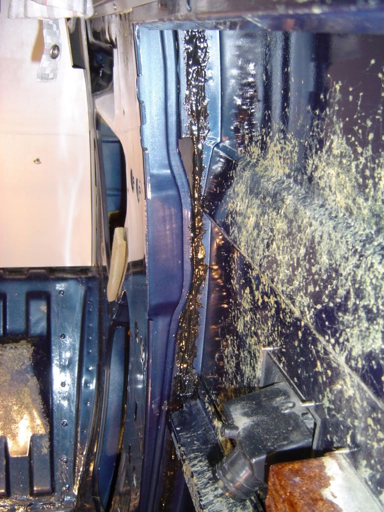

It all started when I bought the westy. The interior of the fridge didn't look too cute, too fainted yellowish for my wife (and me, I'll admit it) so I decided to replace the fridge with a whiter one. While the fridge was out I started checking out The Samba (big mistake! Laughing ) and decided to do more things like replace the water lines to the faucet.
So when I was just about to replace those water lines, a rainy day showed me that water was coming in from somewhere behind the hookup panel. So I decided to remove the cabinets and check out for rust and remove the fiberglass. That is when I detected water coming in from the vertical panel seam in that area.
see the water here shining along the vertical panel seam in the out-of-focus picture
So I sealed the seam from the inside and replaced the outside hookup boxes. Sealing the seam in this picture.
I also wire brused some small rusty spots at the bottom of the panel, sealed the botom panel and sprayed a zinc oxide primer and Rustoleum paint before aplying Waxoil for rust protection.

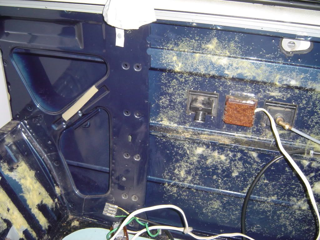

While the cabinets where out I decided to pull out the floor and rear bench to vacuum everything and replace the press boards which were soaked from the water coming in from the panel seam.

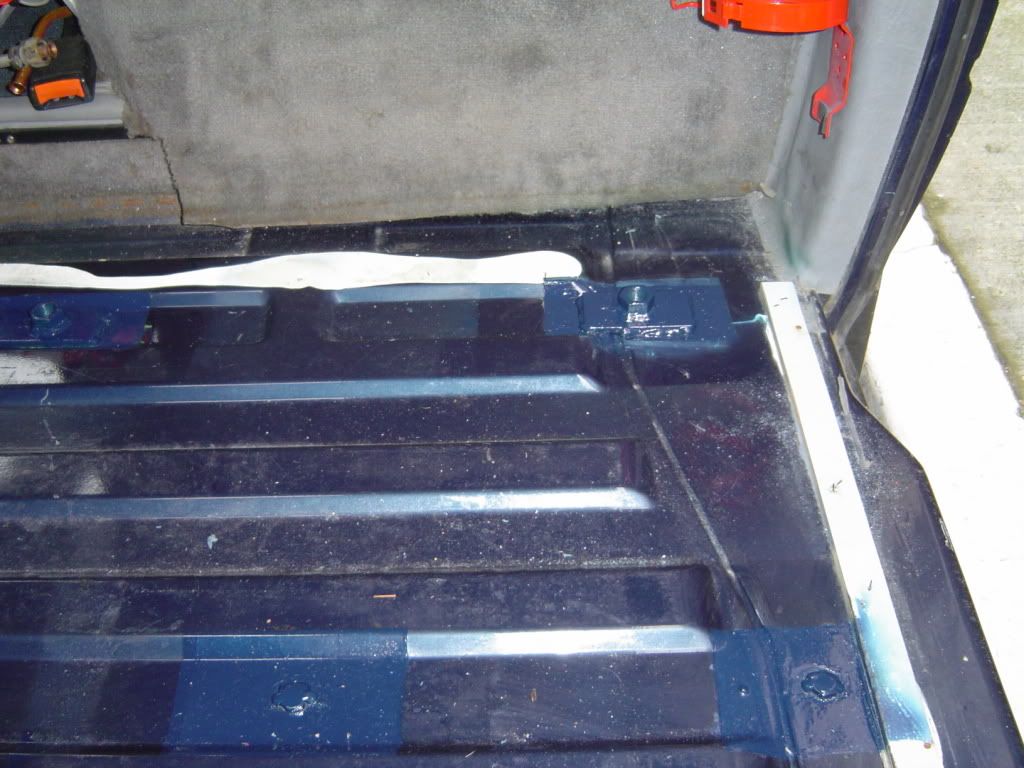

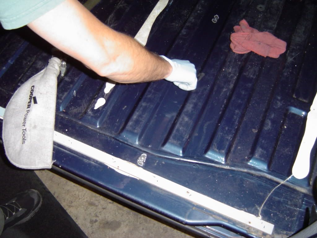

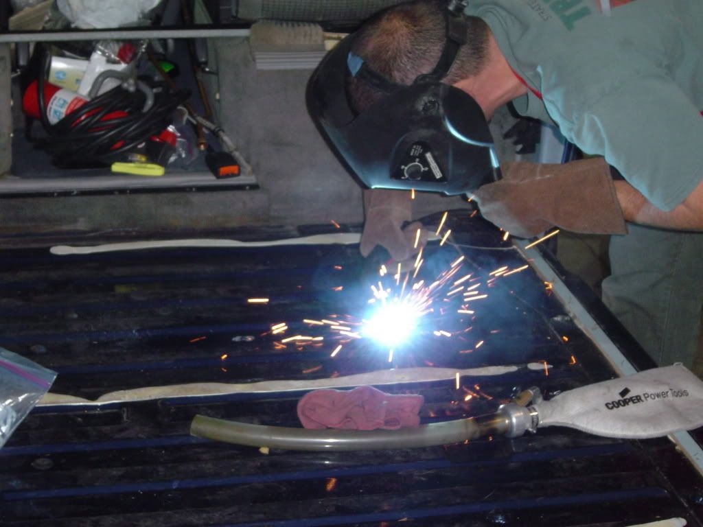

While the floor was out I also decided to do everything I could need in the future here so my good friend Sergio helped me thread and weld two front bolts behing the passenger seat for the second LP tank that I already have and also weld two pieces of metal with a nut on each piece to receive the leg pegs of my jumpseat with armrests.
here is a picture threading the second LP tank bolt. You can see the first bolt welded already.
some welding going on
here you can see the metal plates and nuts for the jumpseat and the heads of the two bolts for the second LP tank after priming with zinc oxide and painting with Rustoleum

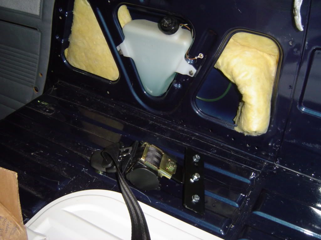

More Samba stuff, I decided to install factory 3-point rear right seatbealt with reel behind panel
Another look at The Samba and I was convinced I needed to do the sound dampening and heat insulation. I used RAAMmat (sound) and Reflectix (heat)

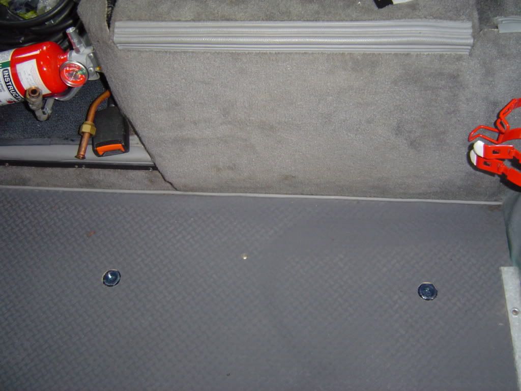

floor back
detail of jumpseat nuts in floor. I'm installing black plastic caps to cover the nuts when the jumpseat is not mounted.
