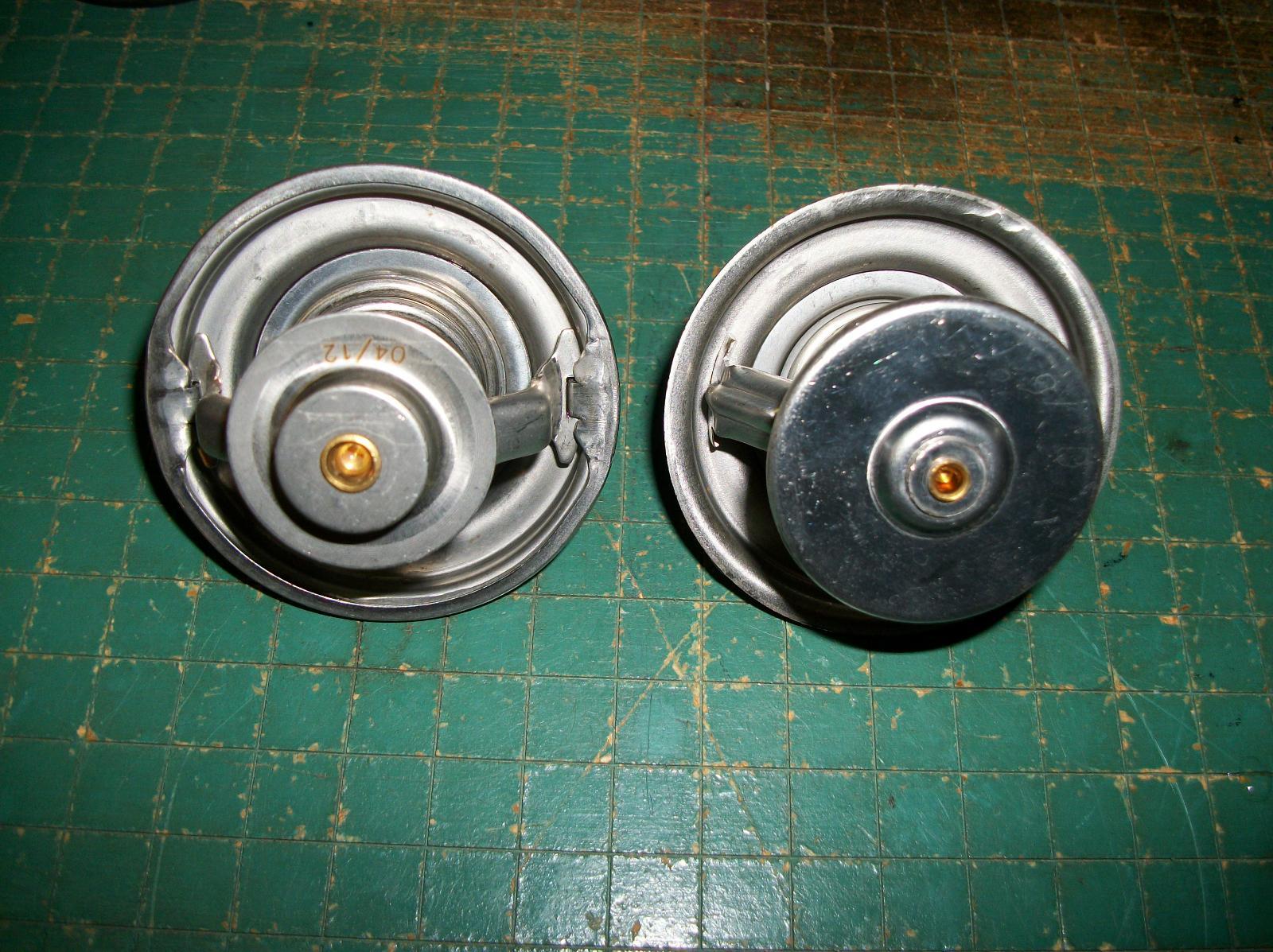

The one with the larger disk the PO must have put in. I put a replacement in and there seems to be an improvement however I have not ran it, filled/bleed enough to see how much of an improvement.
PO also had used dex-cool and I found gold flakes when I removed the cap and the hydrometer needle didn't even move when I tested the coolant. So, I flushed it out twice and refilled with green non phosphate coolant.

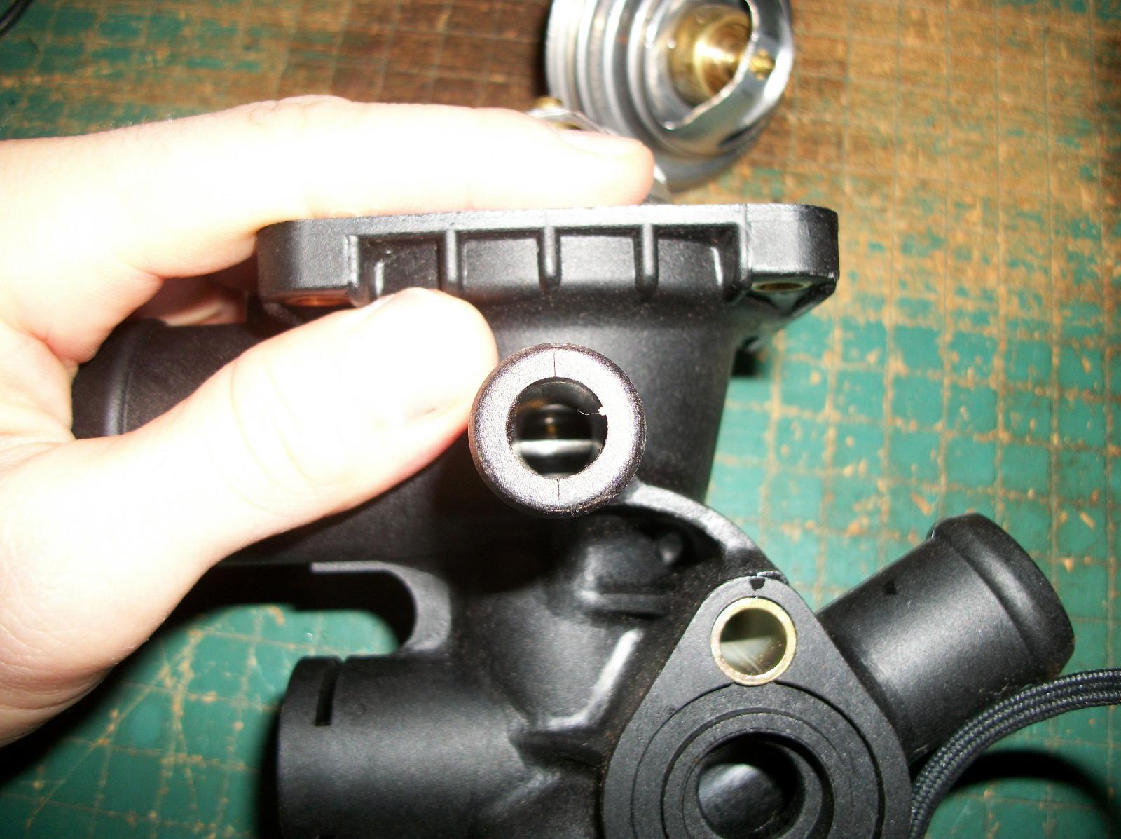

PostPosted: Mon Dec 10, 2012 7:16 pm    Post subject: Reply with quote
I took the thermostat housing apart and found one of the thermostats with the larger bottom disks that were referenced earlier in this thread(the wrong kind)
I took pictures and you can see how the larger disk gets stuck in the bottom of the the housing
Lower disk is bottomed out and cannot move down more once thermostat opens. The hole is then always half open and half closed.
Another hole that is permanently half open closed.

PostPosted: Mon Jun 15, 2009 8:16 pm    Post subject: I think I can confirm the wrong-sized disc issue..... Reply with quote
tencentlife wrote:
Affirmative; it can't be installed upside down.
There are some tstats that fit and have the right temp setting but the disc on the bottom of it is too big. The diference is fairly obvious when you have the right one in your hand. I had a wrong one and didn't know it until I compared it with another new one. The disc has to be the right size to seat right down into the bottom of the tstat chamber, to block off the hole in the bottom of the tapered well, which forces all the hot coolant coming right out of the frontside of both heads to flow to the radiator (flow in the crossover hose over the bellhousing reverses to left-to-right). If the disc is too big, the tstat opens OK but the disc doesn't block the bottom of the well as it should a good deal of hot coolant comes back into the cool side and the whole shebang runs hotter.
The correct disc diameter is about 33mm. The wrong one was 10mm larger.
My cooling system was working perfectly. However, I recently attempted to replace my 80C thermostat with an 87C, hoping this would lead to faster warm-up and a little better MPG. I purchased the new T-Stat at NAPA, but this was before I read about the different-sized bypass discs on some brands, per 10C's comment above. The NAPA disk was about 10mm larger in diamater than the Wahler disc that I pulled out.
After installing the new stat and pressure-bleeding thoroughly, I noticed that although the engine would eventually reach operating temp, the radiator would remain barely warm. Even after successive bleeding, the radiator remained tepid at best. On my first test drive, the temp needle eventually climbed into the high quarter of the gauge, the LED began blinking, but the radiator fan never came on and the radiator itself was only warm, not hot. (NOTE, this is a relatively new radiator and I've only put about 12K miles on my camper since it was installed a few years ago.)
So, not having another 87C T-stat handy, I replaced the original 80C unit, bled everything, and now the needle stays right on the LED all the time, the fan comes on like it should, and everything seems fine again.
All this to say that I agree with 10C's premise that the wrong-sized disc on the T-stat can partially block the hot coolant from circulating forward to the radiator, instead forcing it to recirculate through the engine, thus raising the temp at the sender. The radiator fan switch doesn't see hot-enough coolant and thus never engages.
I'll probably attempt to put another 87C T-stat in if I can find one with the correct disc size. My '87 camper, although running very well, doesn't get very good mileage (16-19 depending), so I'm hoping the correct-spec T-Stat can help a little.
Thanks to 10C for this valuable observation! Hopefully others won't have to repeat my mistake.
