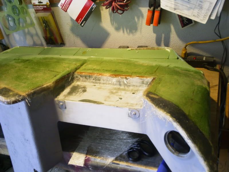

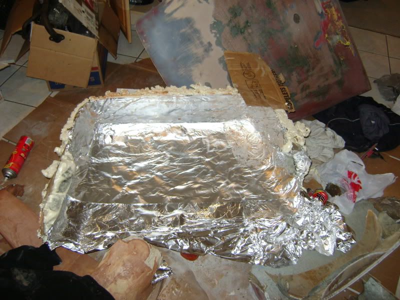

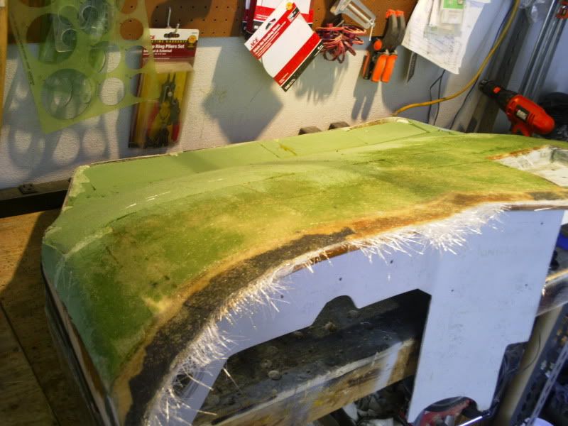

That's an interesting solution to your problem. I assume from here you are going to glass the inside of the tin foil and then graft it to the hood? Hopefully that works, if not, here is another suggestion.
Floral foam blocks. The green stuff. Sands so easily and it's pretty cheap too. I bought a 6 pack for ~$4. Stack it up sand it to shape and put 2 layers of 1.5 oz mat on it. Pull it off, and take a putty knife and scrape out the floral foam, give it a sand to get rid of the extra foam stuck to it, and lay down some additional layers inside. I am building a custom dash for my Sterling in a slightly similar fashion. The top will get a few layers of chopmat, then the foam will be dug out, and additional layers will be added to the underside.

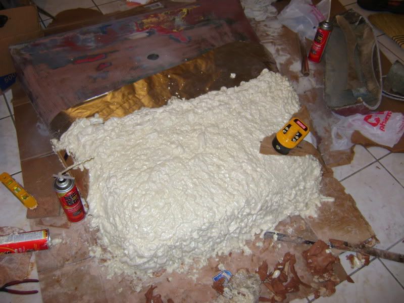

Posted: Mon Jun 08, 2009 7:57 am Post subject: |

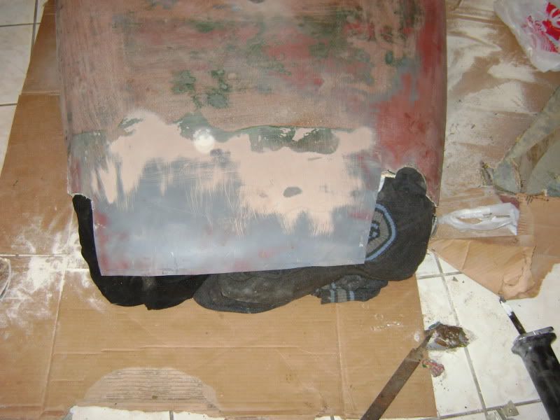

Im not sure this is going to work  |

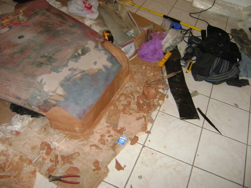

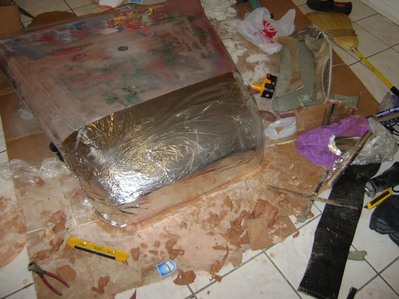

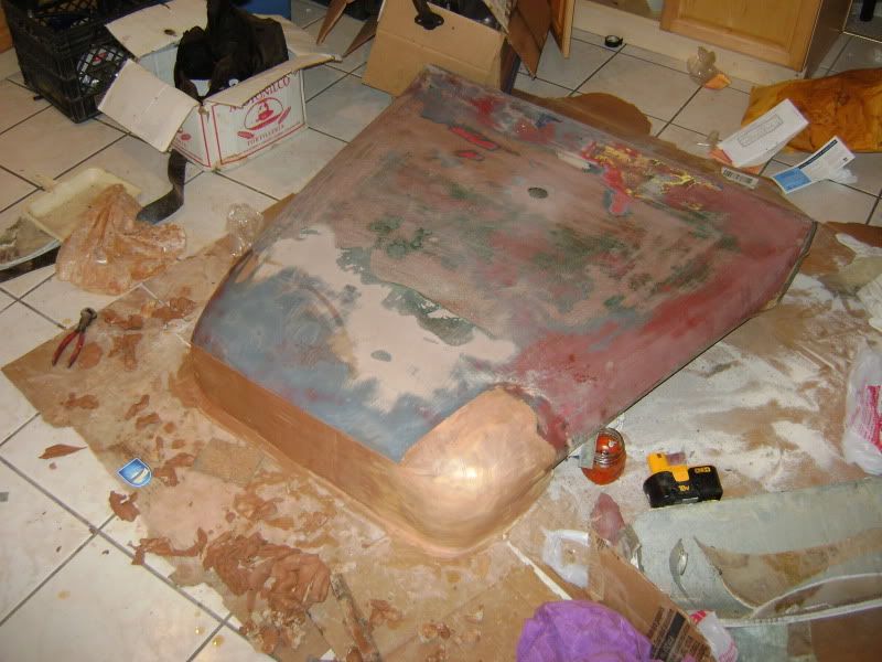

Posted: Sun Jun 07, 2009 1:48 pm Post subject: |

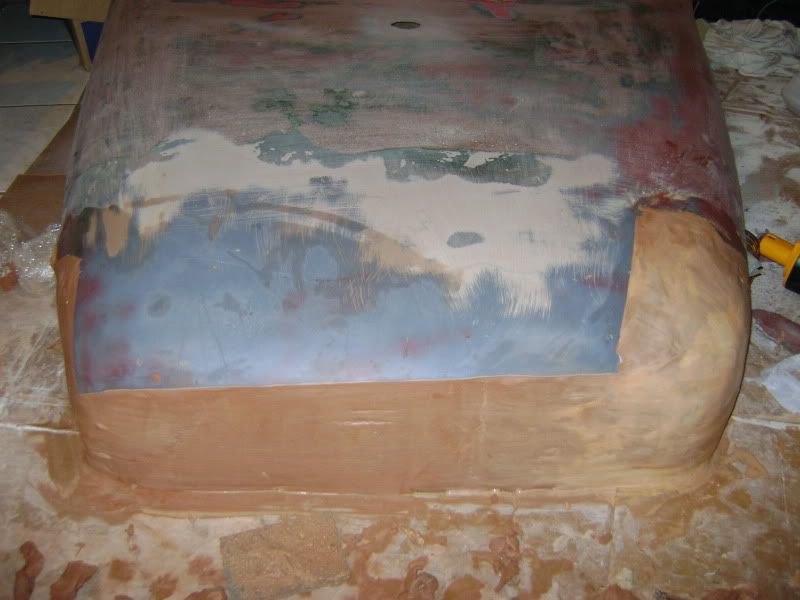

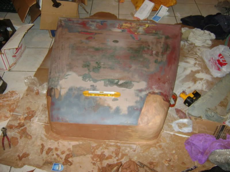

Started cutting the hood up. I had some clay sitting around so I did an artist reconstruction of the hood. Hopefully it fits. I figured this would at least prepare me for working with fiberglass. I used right stuff to make the mold. I just have to lay the fiberglass in the mold now.

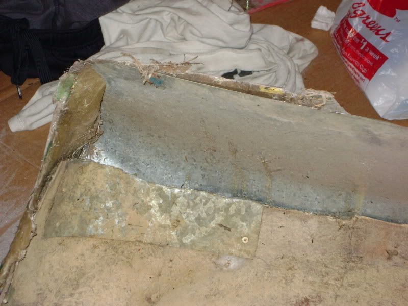

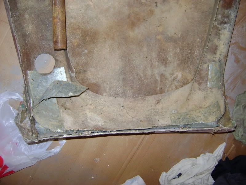

dirtbugger Samba Member
Joined: February 17, 2007 Posts: 198 Location: Sydney
Posted: Thu Jun 04, 2009 1:00 am Post subject: |

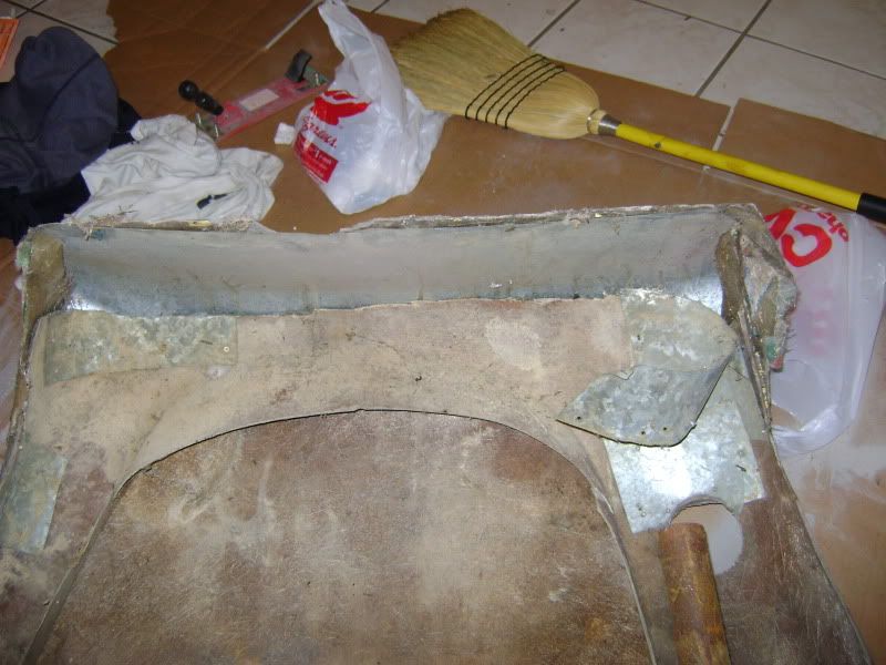

Wow that's one radical repair job
looks like they used sheetmetal as the former and either glassed over it or just used the filler alone.
there's no doubt you can save it, just redo everything using glass matting but it'll be an awful lot of work.
Maxdavid may have a real good point, a few calls wouldn't hurt and it could save you a lot of time and itching. |

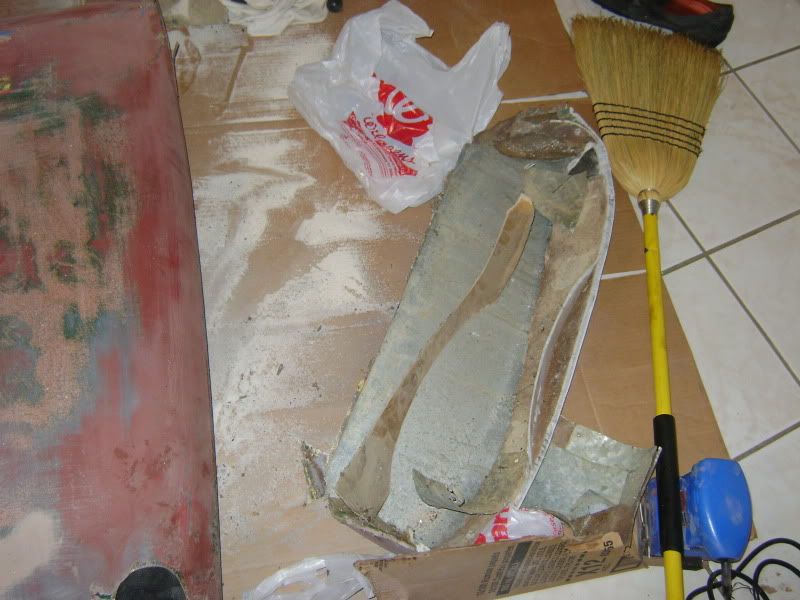

Posted: Wed Jun 03, 2009 11:31 pm Post subject: |
Here goes. Thoughts.

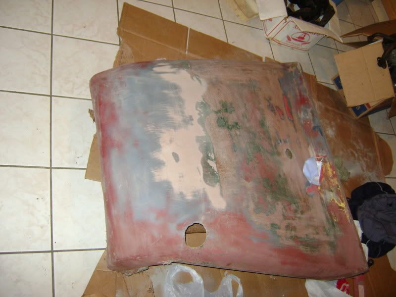

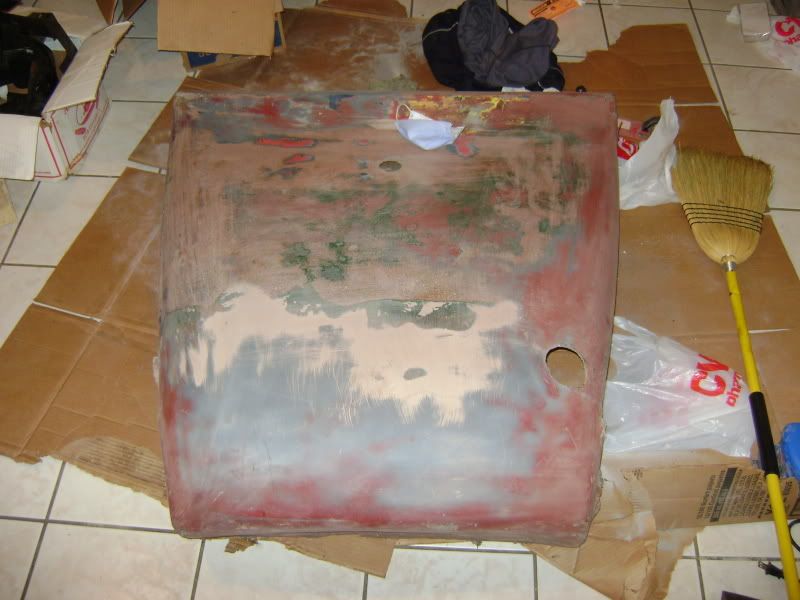

Yes,
Basically the lower third of the hood is bondo. I can see where they completly cut out the old fiberglass. Ill provide pics once I get home. I don't plan on using bondo to repair, thats for sure. Im just worried that I will not be able to correctly shape the hood with cloth. |

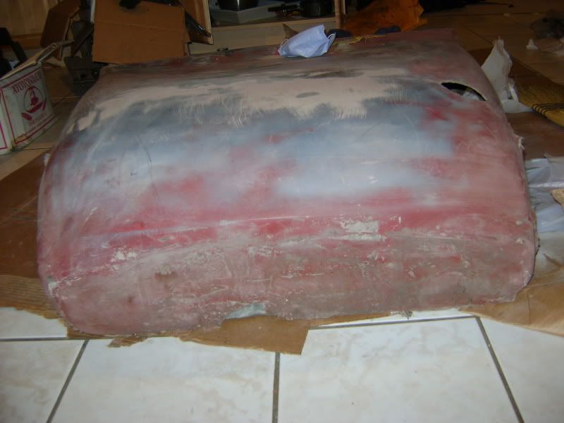

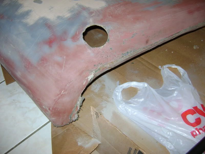

Posted: Wed Jun 03, 2009 10:50 am Post subject: Removing Bondo from Fiberglass Hood. |
Hi All,
I just bought a fiberglass buggy. The lower front of the hood was cut. This portion of the hood is very poorly formed with bondo. I've never done any fiberglass work but this is unacceptable. Should I just cut the bondo out and try to reform. I haven't had a chance to research and check the style of the buggy so Im not sure of the make.
Please let me know your opinions. |
Back to top |
